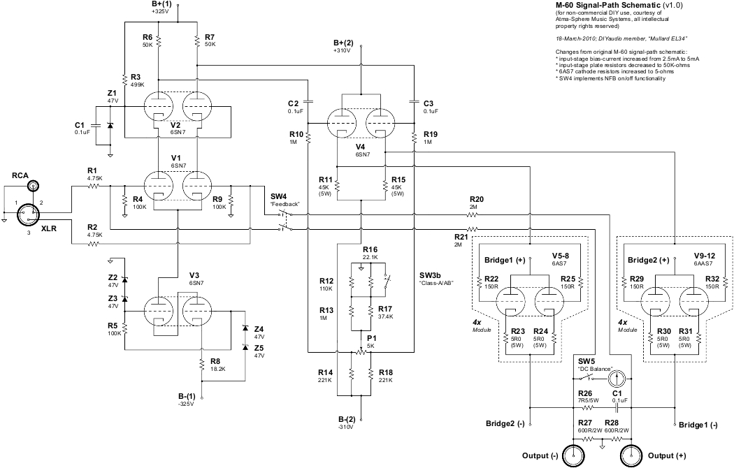

Curiosity, can someone explain what the resistor and cap are for across the output terminals in the schematic.
I assume a filter of some sort?
I get the 600ohm resistors as a reference to ground.
Just has me wondering as I am no electronics engineer.....
Really appreciate the insight!

The resistor and cap , are there to keep the output impedance of the amp near 8ohm at high frequencies , they have an Fc of about 212KHz .

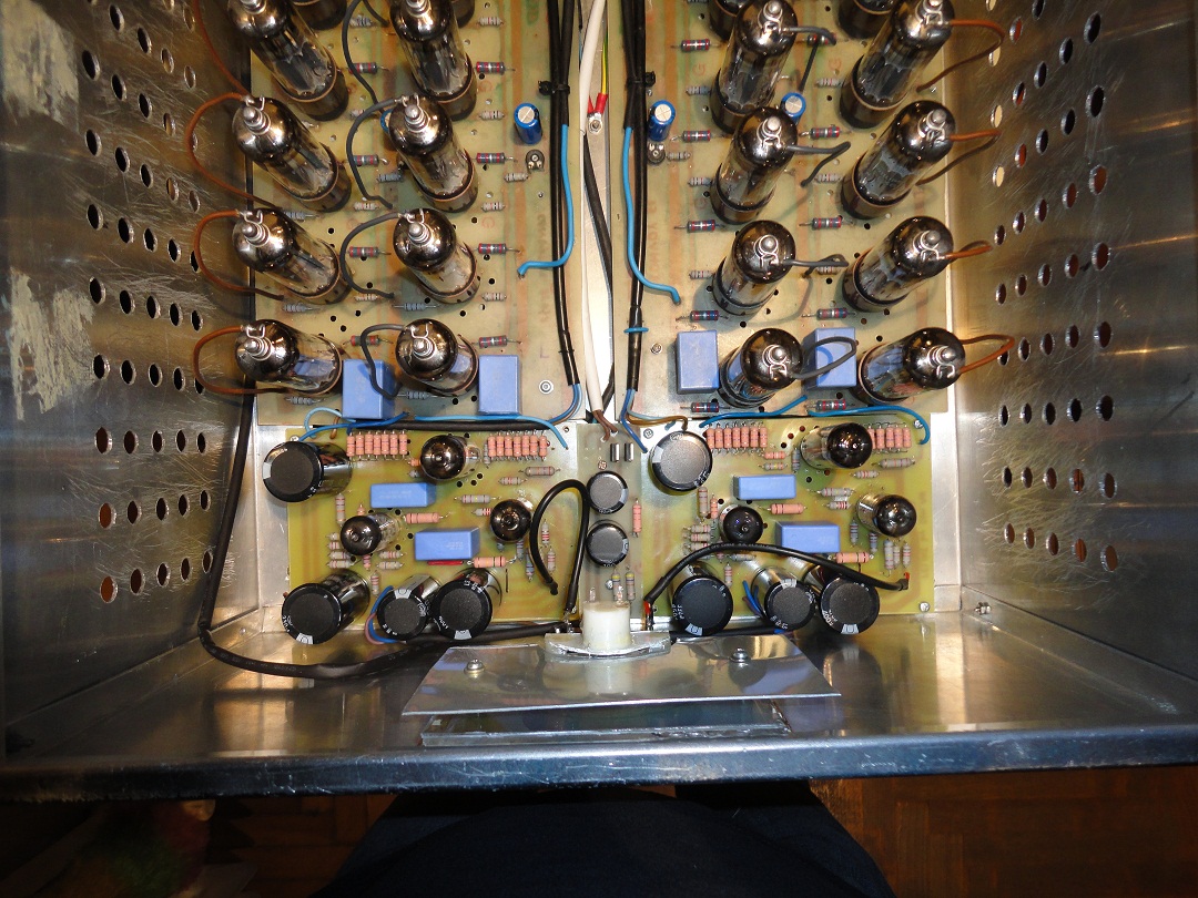

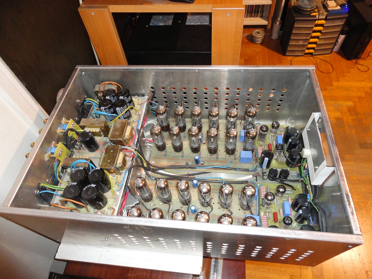

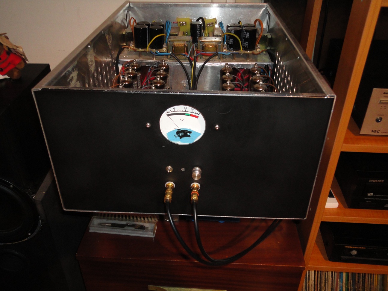

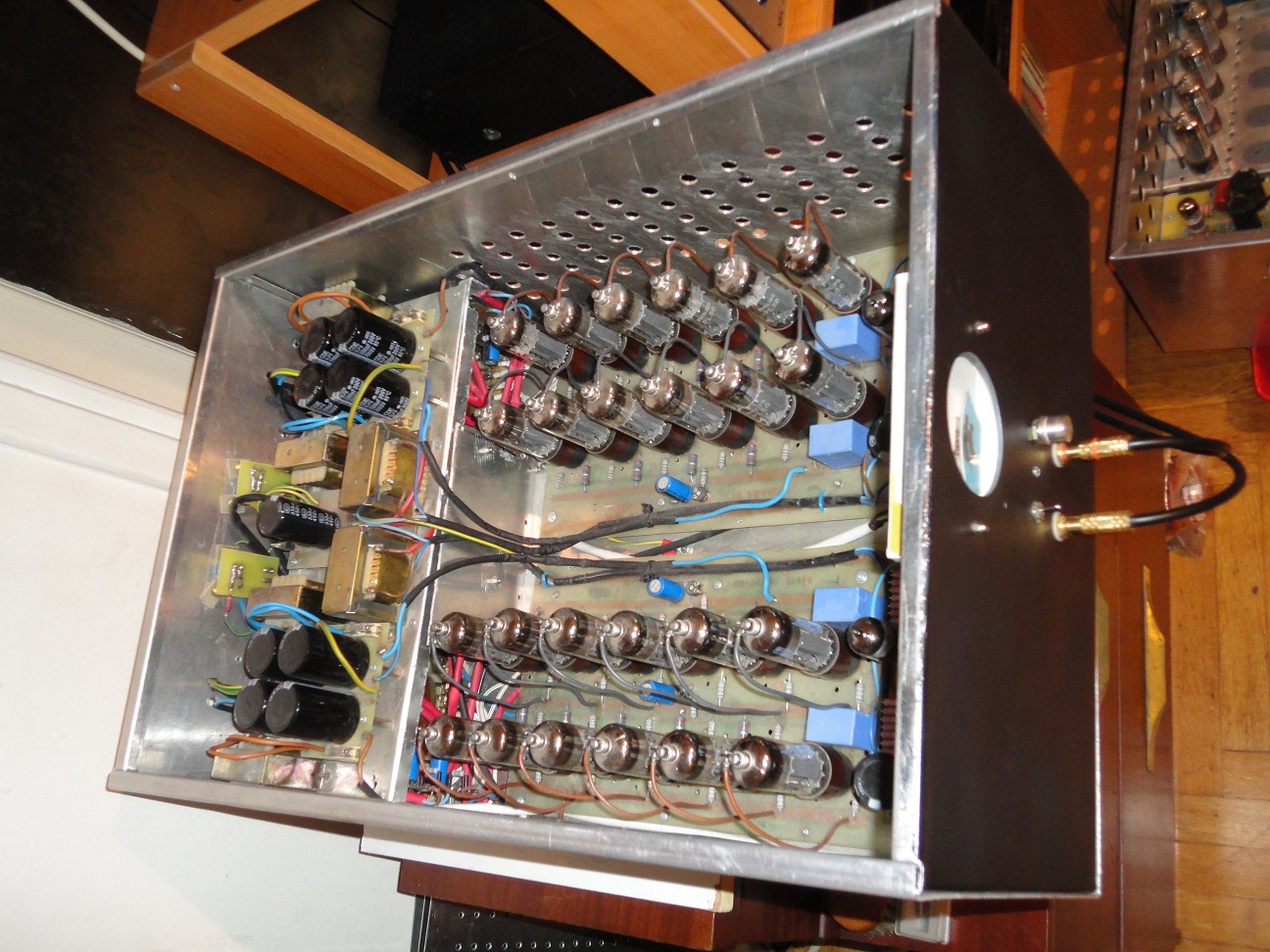

Some photos of the Futterman OTL ( FELINE OTL AMP )

Super Nice! The circuit boards are a nice touch. What are you driving your amps with? I'm currently using a 6SN7 Aikido that I built a couple years ago. Thinking about breaking out my Salas 6V6 line pre-amp and redoing it to a little better standards than the original build I did several years ago.
Thanks , but your amp looks more " sexy " 🙂 .
I have three different preamplifiers , designed and built with the same way of design but with different tubes.
The first stage is always a differential amp the second is a common cathode amp and the third is a cathode follower , with the use of local and global negative feedback !.
