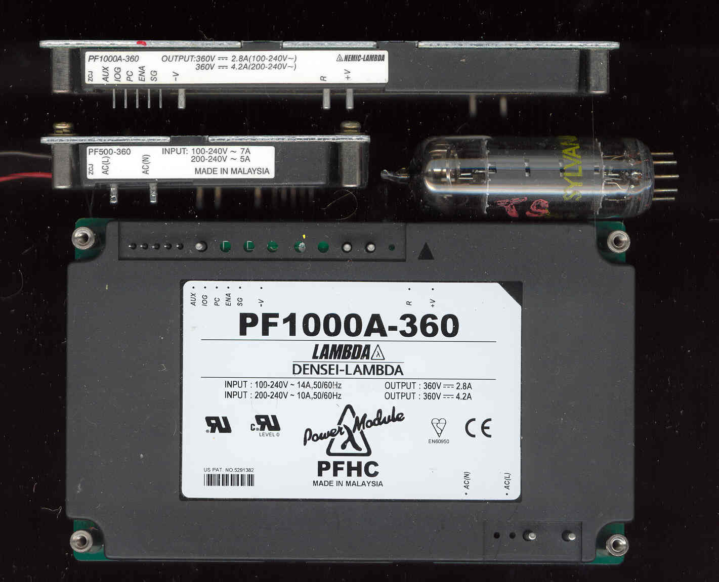

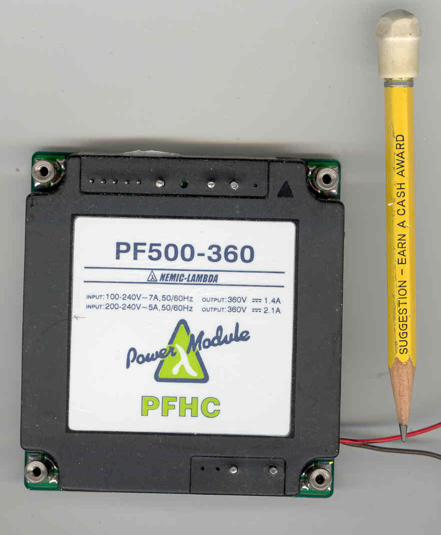

Yes!
A PID controller could be do the job much better than a reactive Fdbk control. Those Tripath class T amplifier modules used just such a design. They set the whole digital output (class D, class T) audio industry on fire using that.
But from a DIY hobbyist perspective, those off the shelf PFC controllers look attractive (below).
Yes, the timing/phasing would be quite important for the audio purity.
One thing in our favor is the current ratio in the ferrite xfmr guarantees a constant ratio of tube current to LV switching return current. But any capacitance in the B+ circuit could smear that out some. And of course, the basic switching freq. needs to be filtered out. One could probably just put enough capacitance on the B+ to smooth out the basic switching pulses. So as long as the switching freq. is some multiple of the highest audio freq., we would be safe from smudging the audio.
However, those PFC modules don't use a full ferrite xfmr, they just use a charging inductor. I guess that still follows the same rules, or we would be generating power for free somewhere.
If I follow you correctly, it would have to be fairly well tuned to avoid phase or timing issues yes? I may be wrong there, but it could be interesting!

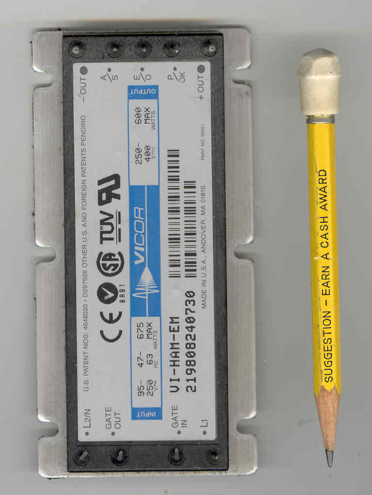

Vicor makes some PFC modules too. I think they can be set up for less than 360V output too. (I see 250V to 400V on the module sticker, trimpot adjust) Probably other brands around too.
All of these PFC modules are non isolating from input to output (versus a real ferrite xfmr), which may be a problem for LV return current routing. Would have to sketch out a circuit to see.
The non-isolation of the PFC modules is also a safety issue for trying to get regulated B+ directly from the power line, a more typical application. Some DIYer's have considered these before, but usually lose interest once the non-isolation issue comes up. But for an OTL amplifier design, we would be working from a LV supply which would be isolated.
Some problems to work on:
For a tracking B+ design, one wants to use a tube that can work with minimal voltage across it, and also provide isolation form B+ to audio out. That leaves out most triodes. Many TV Sweep tubes can operate full current down to the 50 or 60 volt knee region (using maybe +120V on the screen grid), and have reasonably high output Z (for isolation from B+, compared to triodes).
The PFC modules around typically are using a BOOST converter topology, so they end up with higher voltage out than the max voltage in. 260V or 360V ratings are just too high to get efficiency from the tubes. Most OTL designs are already using just +150V. This might be something that could be hacked, since we could still be boosting from a LV of maybe 60V. Maybe just a different trimpot range would work.
The Vicor modules typically are using a variable freq. converter, this could be a problem if the freq. can dip down near the audio spectrum.
So these things are a sort of SMPS/Inverter front end, like the ones that generates the DC bus in a variable speed drive.
Have you looked into the SLCF circuit from Allen Wright? He bootstraps the anode and CCS's the cathode to keep the voltage across the tube constant. Least I think that is what it does. Been a while since I read his book.
I don't have his book, but I think I have seen a follower placed above the active tube to control the plate to cathode V. (mainly for distortion control) The follower is eating up all the heat that way unfortunately, working from a fixed B+ above it. But it is a tracking B+ generator for the active tube, just not an efficient one.
Yes, these PFC thingies are a front end for bigger switching power units, designed so they draw instantaneous line current proportional to instantaneous line voltage. (so unity power factor, looking like a resistor)
As opposed to the usual cheapo PWMS (like many PC supplies) which just rectify the line V into a big cap, drawing very spiked current off the line. Making the power cord, house wiring, pole transformer, power lines, and utility generator inefficient. I think PFC units are mandated for power supplies above a certain wattage. I know if I look at the line voltage here with a scope, it is nearly flat topped from spikey current draw from PC, TVs, radios, ... Nothing like a sine wave anymore.
