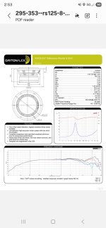

Back to regularly scheduled program. Another fine midrange, highly recommended by John Krutke, is this tiny 4" woofer. Yes, they call it woofer. I used it in my short line array long time ago. Its still available, very cheap, yet with very low distortion. Being metal cone, it has breakups, but they are high, easy to filter out. Highly recommended mid.
https://www.parts-express.com/Dayton-Audio-RS125-8-5-Reference-Woofer-295-353

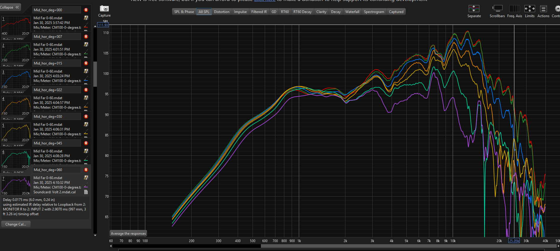

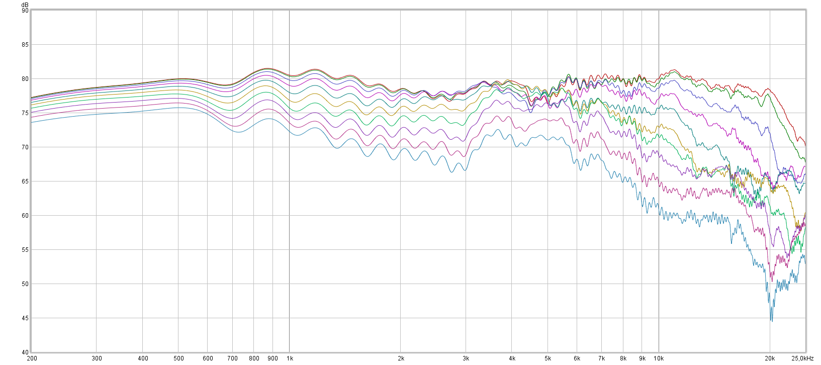

Keep in mind while looking at these graphs, that the measurements were taken after an entire winter of screwing around with horns and waveguides. Its not like this if you just screw it to a baffle naked. But its also not super far off

Well, well, well. You call that midrange? Its response is droping like a rock below 1kHz! Some tweeters go lower. You were definitely ignoring what I wrote. Midrange driver is flat from 250Hz to 3kHz, I repeat. And it was said by others too.I really wanted to use the NE123W-8 but it didn't become available when it was supposed to

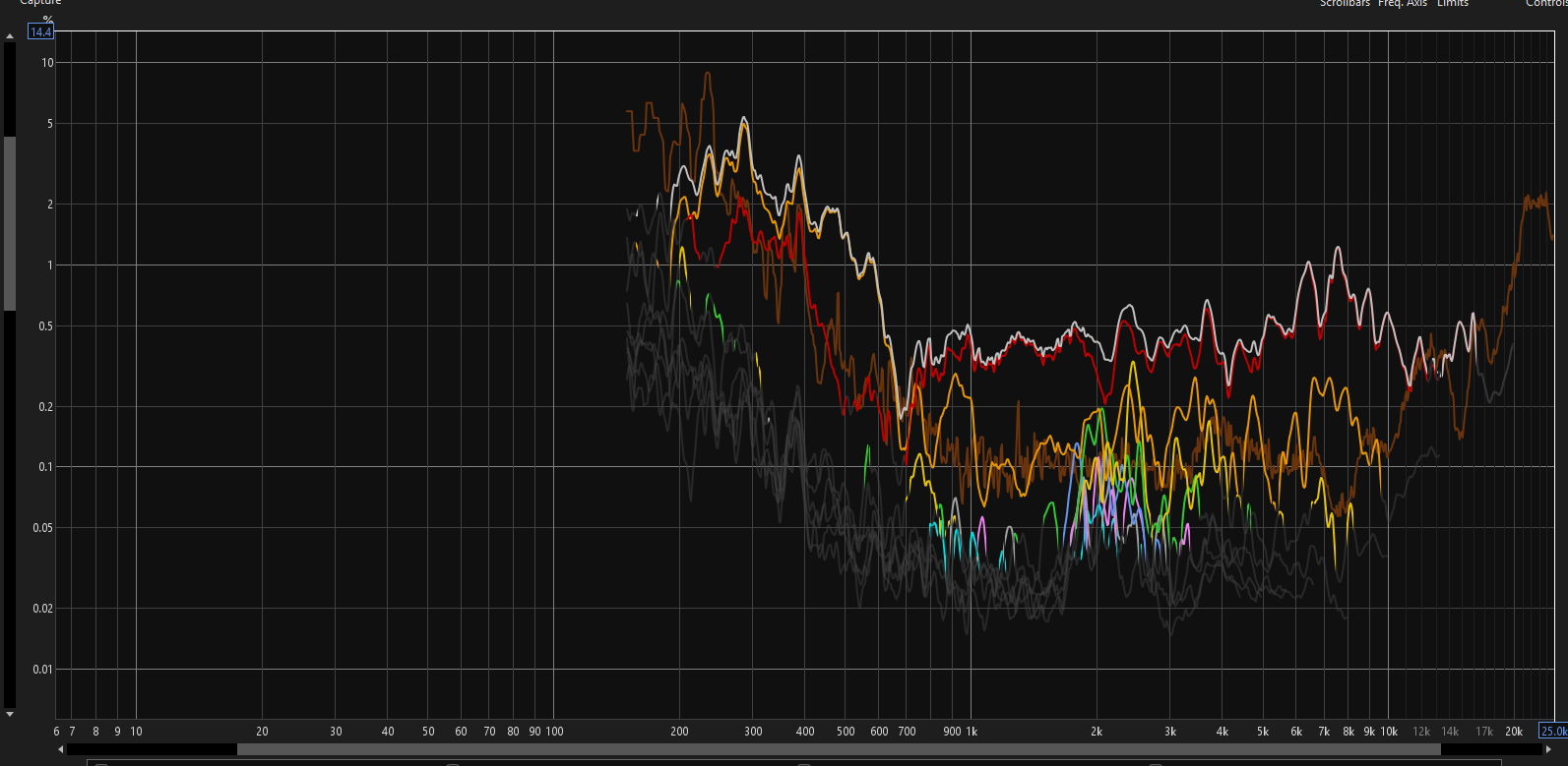

Besides it has terrible rising distortion towards lower frequencies just as i measured myself.

Often it just means that the driver is not rolled off by inductance, which does what? Distort the upper frequencies quite badly.

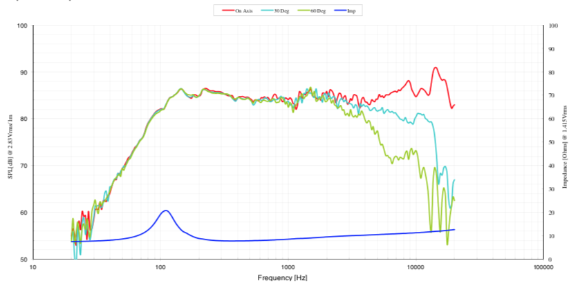

The Tymphany TC9FD-18-08 is good sounding, smooth 3.5" "full range" that covers 125Hz to 20kHz:
It's response gets a bit rough and beamy above 8kHz, but many DIY projects have used them without tweeters.
Still available for under $15, an amazing price for a high quality driver.
It sounds good up to it's Xmax:
It can play louder and lower than the MCA12RC-H1304 midrange and still sound clean.
It's near flat impedance curve makes for easy passive crossovers.

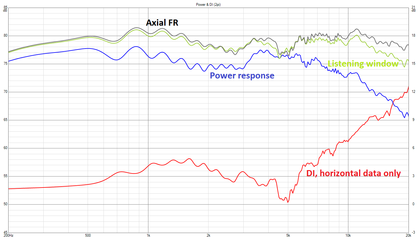

I had a chance to work on ATC SCM40A. See the measurements, 1m, 4ms window, in the attachment. This was improvised measurement in the client's living room. Still it quite matches my listening impressions.
Bass was quite ok, not going low, but that was expected. Upper bass-lower midrange was weak, overall somewhat congested, the music did not flow easy out of the speakers. Midrange was little bit lifted and annoying, yet no particular sense of details or openess or clarity. Trebles again, somewhat veiled, I missed top end. Overall impression was that it sounded congested, front to back space was totally flat. This is exactly what happens when upper bass-lower midrange is not right.
This model is entry level, I am quite sure that midrange drivers can sound wonderful if the right hands and ears take care of the overall loudspeaker design and implementation.
