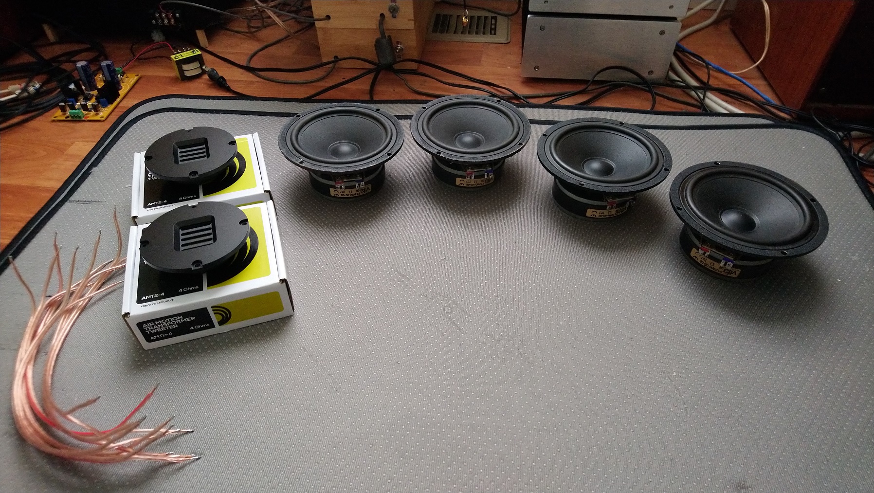

here are some projects i am working on at home

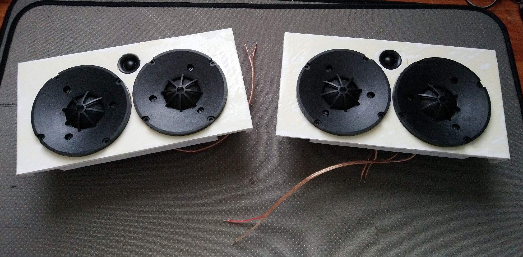

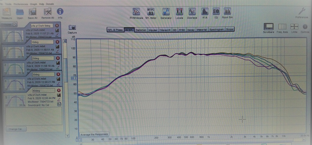

first i got some old vifa midranges back from a friend, and I got small dayton amt to mate them with
vifa 13wh-00-08 is somewhat special midrange, free of the breakup grunge, even the ones i got are old, they still measure nice

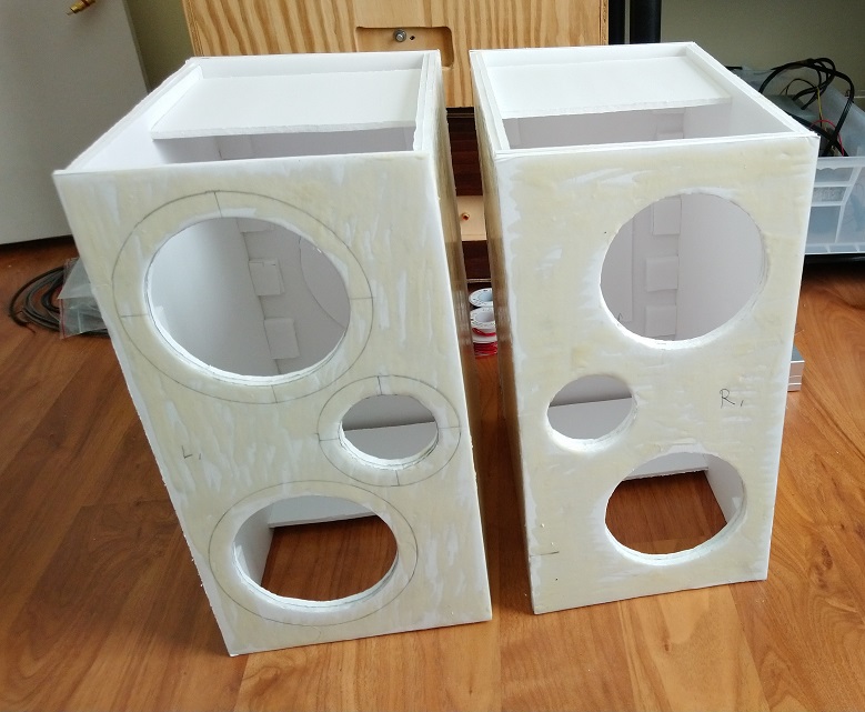

here are some pics from the build, work in progress
may go active!

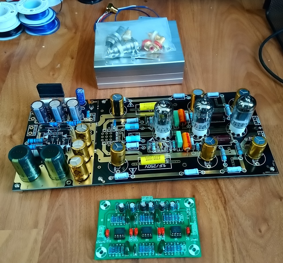

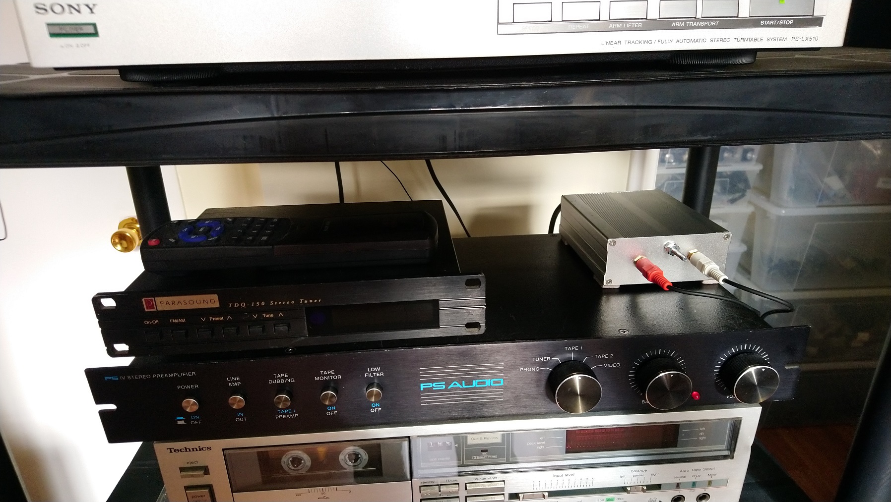

next, i had some phono preamp kits unfinished, and its about time to finish them
two shown are bugle and ear834 (second slightly different kit as before)
bugle is finished in the box, while playing ok, i prefer an old discrete ps audio in comparison (this is just guest room, no fancy electronic here)
once I finish ear I will compare them downstair with better turntable

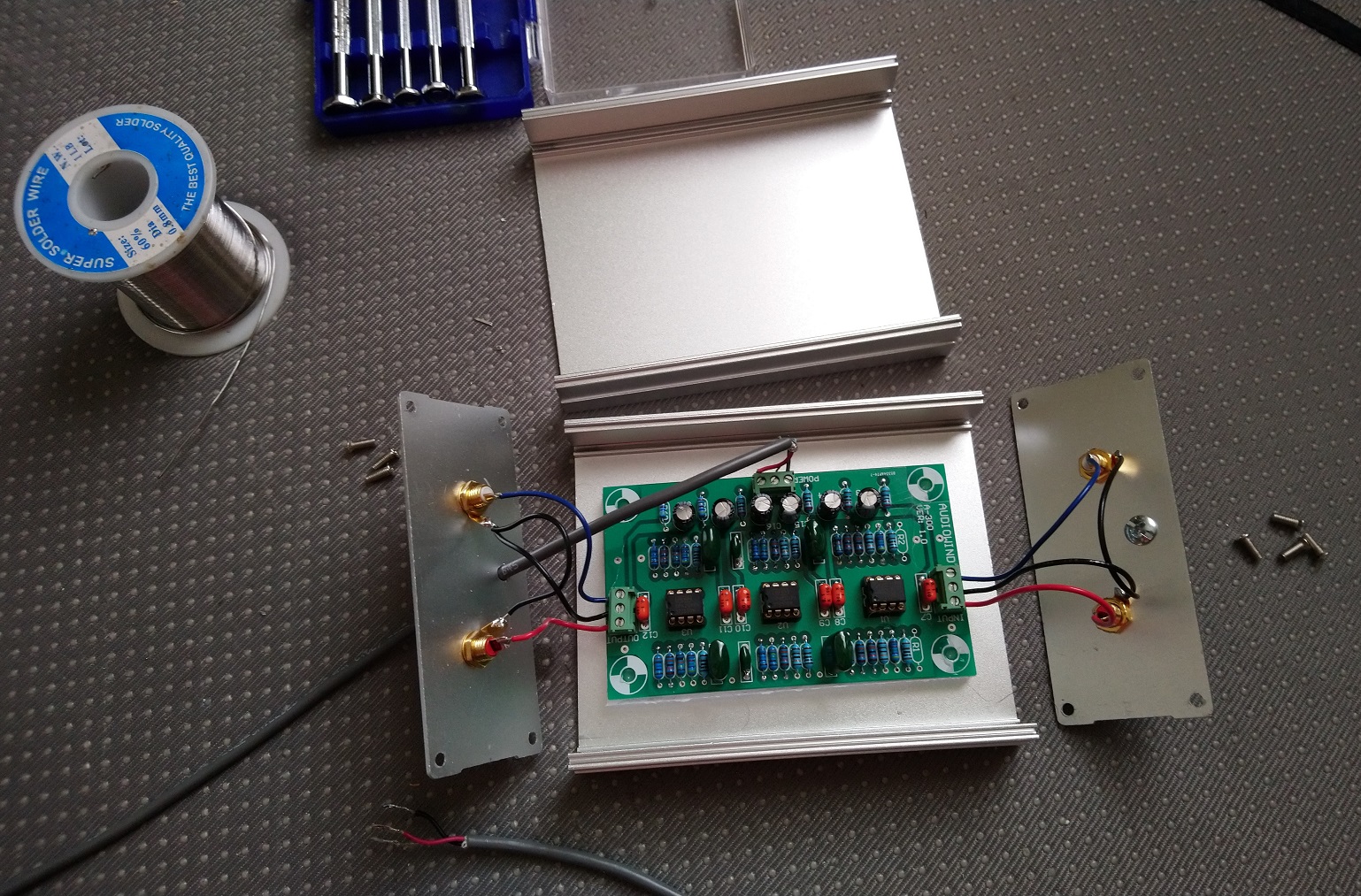

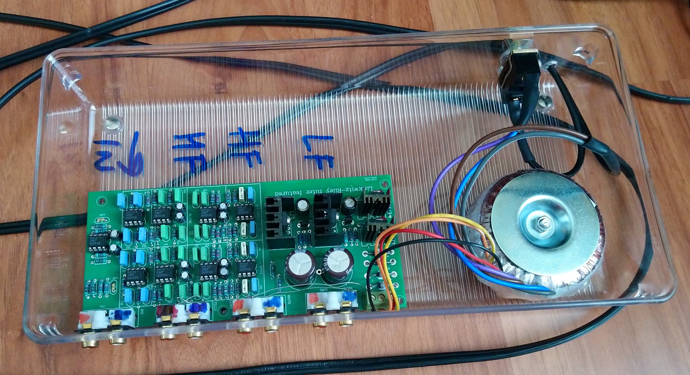

3-way active crossover, kit
maybe I will use it with vifa/dayton amt build, its 300/3000 Hz, perhaps ideal, will see
btw, it took me a while to figure out the outputs, they are randomly scattered diffrent bands left right, weird
i rewired it as its supposed to be

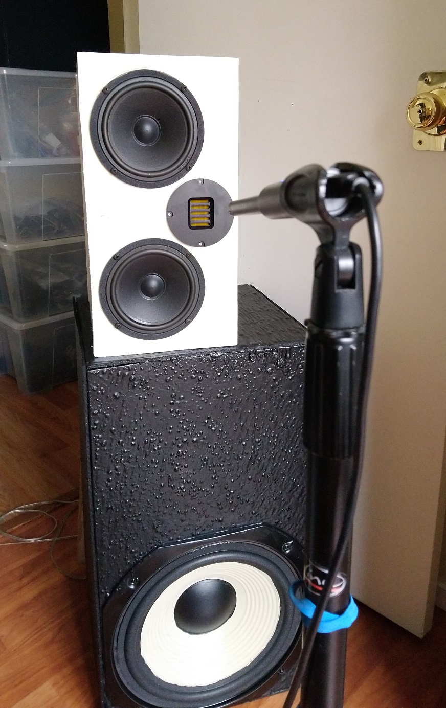

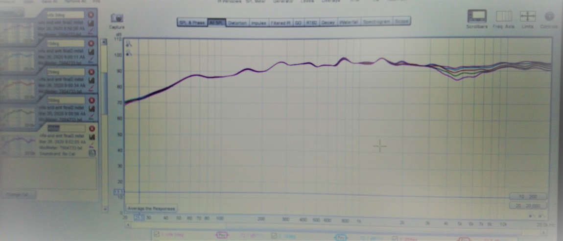

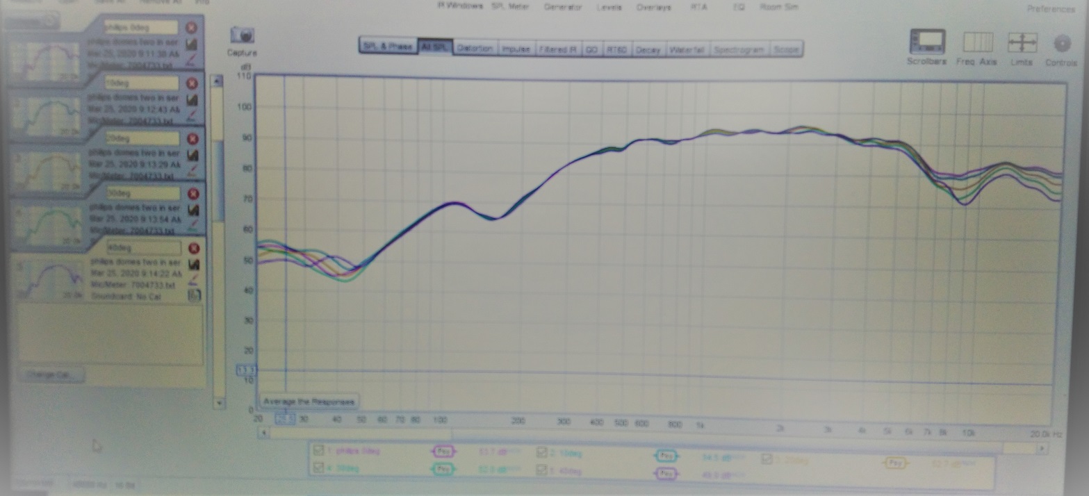

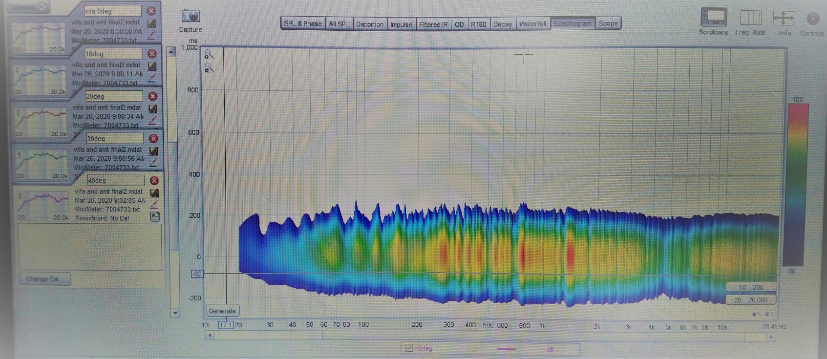

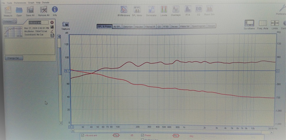

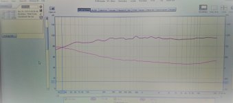

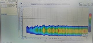

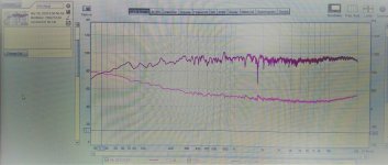

anyway, here is some update on the vifa and amt tweeter
i am working on the crossover now, vifas are running with no coil, naturally rolling of at ~5kHz
i am adding slowly capacitors to the amt tweeter, I do not want to load it too much
it measures quite flat, but there is little less energy between the 4-5 kHz, i think i need to add more cap to tweeter...work in progress
otherwise it sounds great, relaxed, maybe small dip is having soothing effect

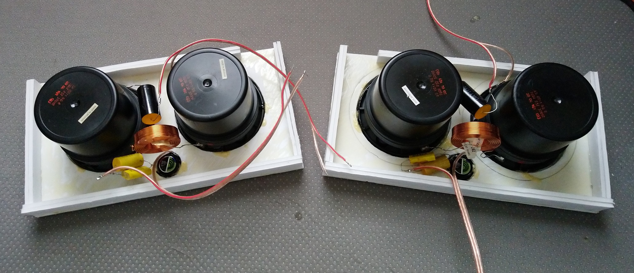

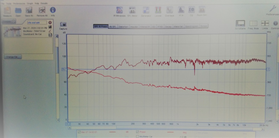

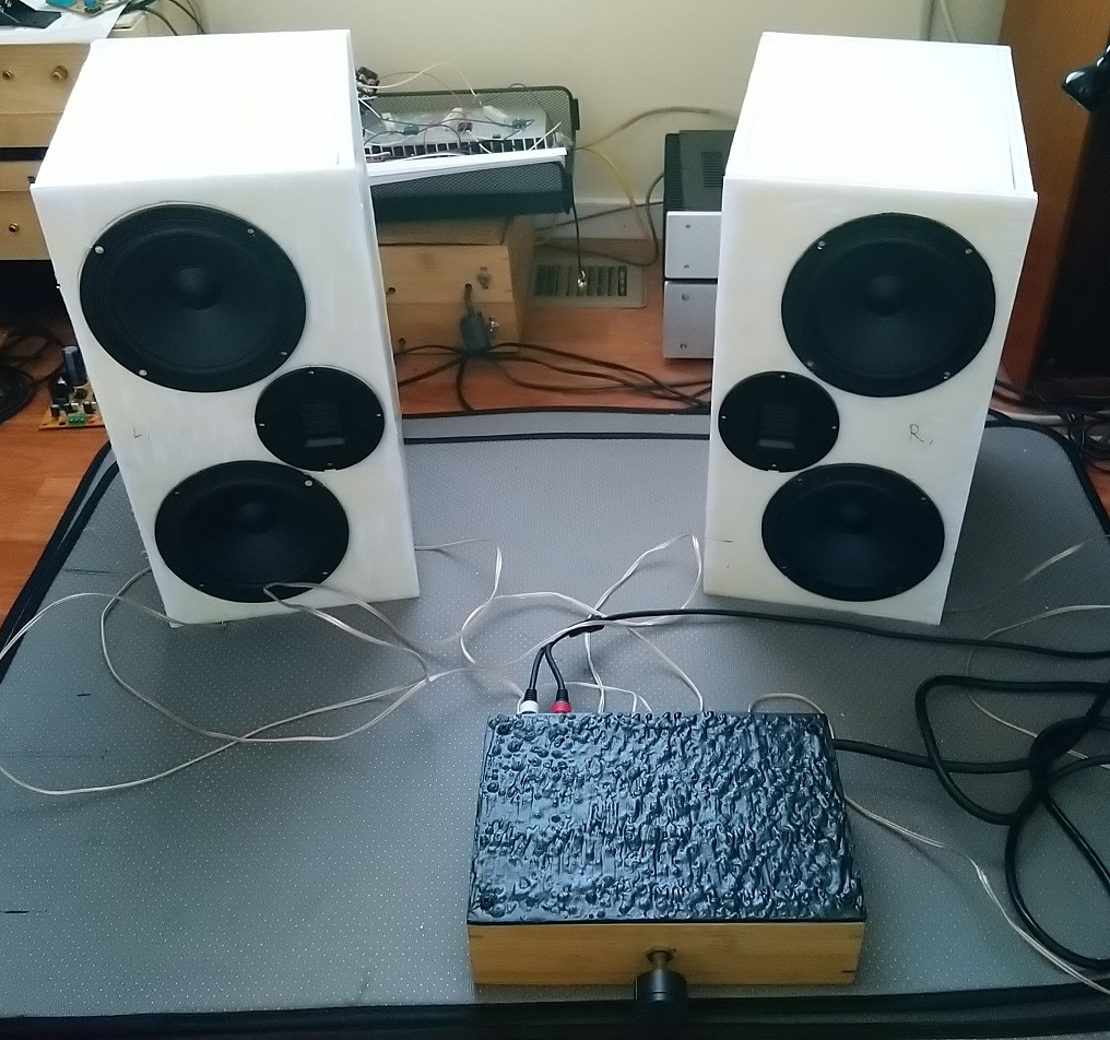

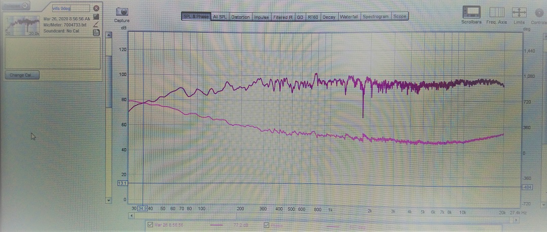

Ok, I consider vifa + amt crossover tweeked
nothing on the vifas (who would in their right mind put crossover on perfect midrange) and only 4.5uF on amt
when I placed coil on mids, the phase went to hell
my approach is 'make it as simple as possible' ...(i think it was Einstein who said that)
now both are flat, response and phase
no wonder, they sound superb
