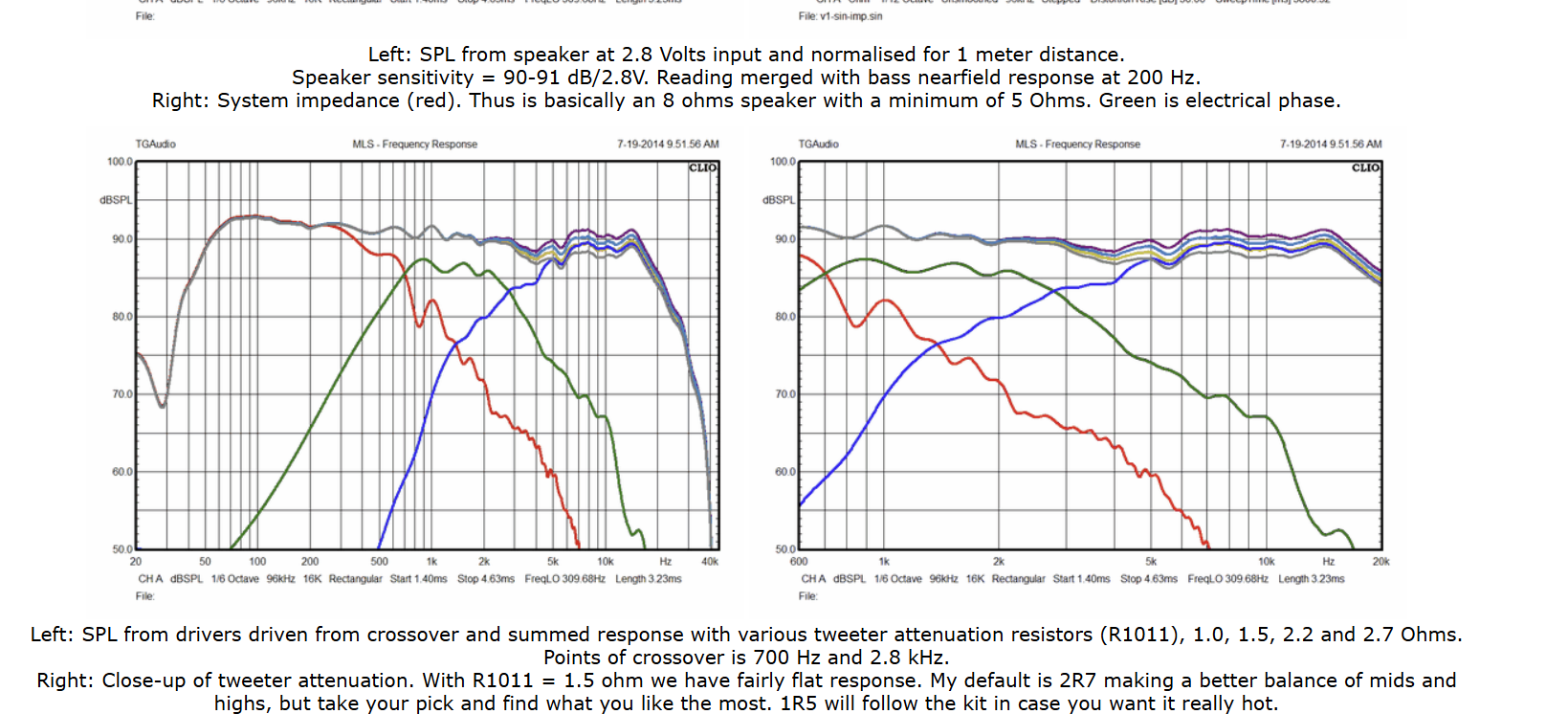

As you can see in the picture, the midrange starts to lose energy around the cross-over region. This is due to its off-axis response. You have to cross lower, and also use a tweeter that can cross lower - or use a waveguide - or else you will almost always get that reduction in the 2-5kHz region - just see almost all measurements from B&W, since around 1997.Seems Troels used this mid in a design.
Crossed at 700 and 2800. That seems usually high for the high pass and oddly low for the low pass. Unless I am missing some key piece of knowledge. My plan was to cross 200-250 hz lower and another 1khz higher

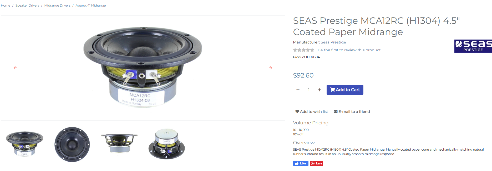

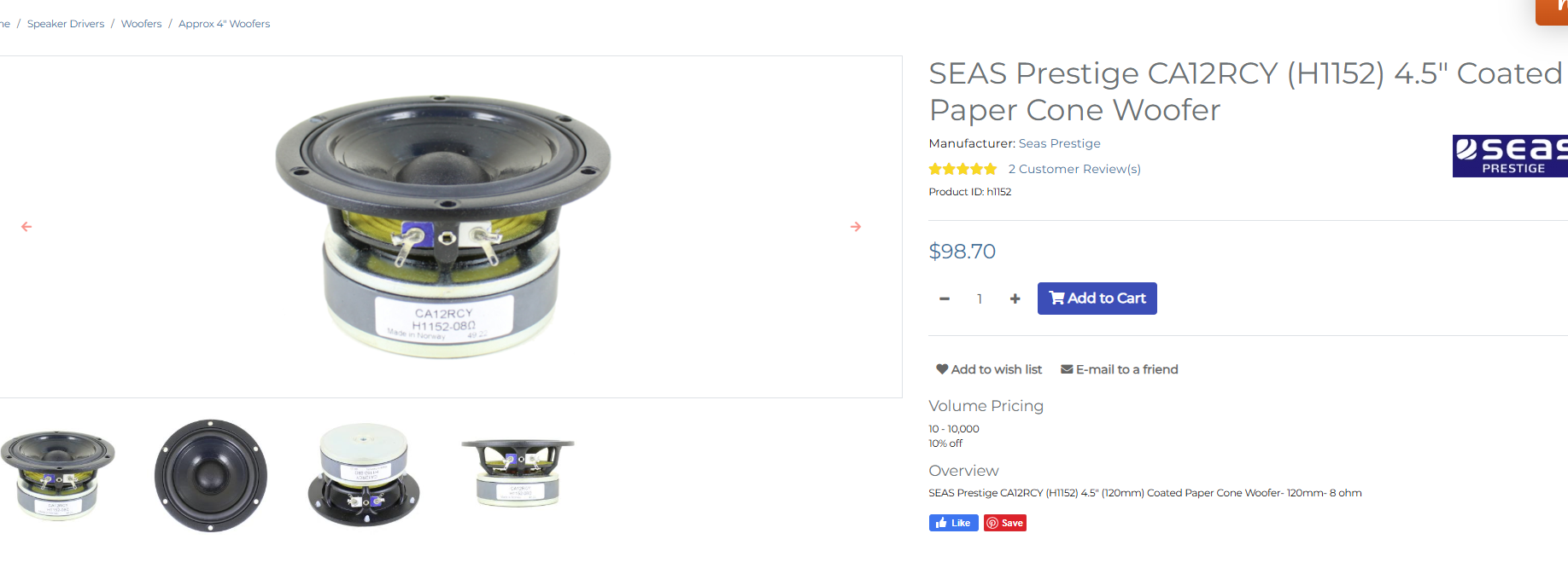

It appears they use a larger magnet on the midrange. I'm guessing this would move the QTS lower. I think these were designed to go together in a tall skinny enclosure.I am looking at these SEAS drivers to use as my mid for a little Kitchen 3 way.
There are two types. The woofer style which has a power limit of 60rms and sealed F3 of 170hz. This says it has the symmetrical drive. The Mid one doesn't say that but I assume its the same motor. I think this is the same motor tech used in the revelator and the wavecor drivers.
https://www.madisoundspeakerstore.c...e-ca12rcy-h1152-4.5-coated-paper-cone-woofer/
Then they also have this same woofer as "mid range". Now it has an RMS of 100 and sealed F3 of 105hz
https://www.madisoundspeakerstore.c...tige-mca12rc-h1304-4.5-coated-paper-midrange/
I'm going to buy the mid range of course. Since I am using it as a dedicated mid range.
But this begs the question: "what do they do to the driver to make it a dedicated mid range"?
Anybody know?

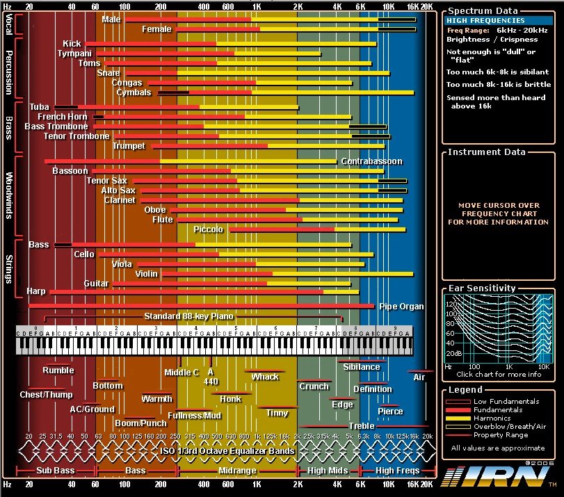

But to answer the question, a midrange goes between the woofer and the tweeter. There is every possible configuration available from 12" cone midranges to 2" dome midranges. Some handle woofer ranges some handle high frequencies just under tweeter ranges.
30 years ago I had a similar dilemma, Seas 11FGX midbass or Seas 11FM midrange driver for 3way with with Scanspeak 21W8553 & Dynaudio D28AF. Same story as with these two new drivers. Chose of course 11FM for 400Hz/2.5kHz. There were other candidates for the mid range, but I chose this one on the advice of a friend. The first version was only 2way (8+1"), but I was not satisfied. Adding midrange was the right thing to do.
It's clear that a dedicated midrange has some advantages over a driver that has to work with low frequencies as well. But there are few of them on offer, they are the rarest drivers i think. Mostly midbass is used as midrange in multi way.
And size and material. Paper has a tendency to break up quicker than metal, giving you a much steeper roll off at off-axis.A good midrange driver exhibits flat frequency response + low distortion over the mid-band desired > it is that simple.
Dispersion comes in at #2, but is highly dependent upon the enclosure, room and listening position 🙂
Midrange frequencies are defined slighly differently depending on the table you use. This is just one example. Midrange is from 250 Hz to 2kHz. Above that are upper mids, some count that as mids too. So 250 Hz to 6kHz.I am looking at these SEAS drivers to use as my mid for a little Kitchen 3 way.

Generally, most 3way speakers, passive or active have 300 Hz to ~ 3kHz covered by midrange.
So midrange driver is supposed to cover this as flat as possible, with low distortion and minimum beaming. Low beaming is important for proper transition to tweeter.
Big midbass driver starts beaming too soon and require being crossed lower to tweeter, stressing the need for powerfull tweeter with low fs.
Ideal midrange is only 4-5" big. This has been discussed ad nauseam, no need to repeat it.

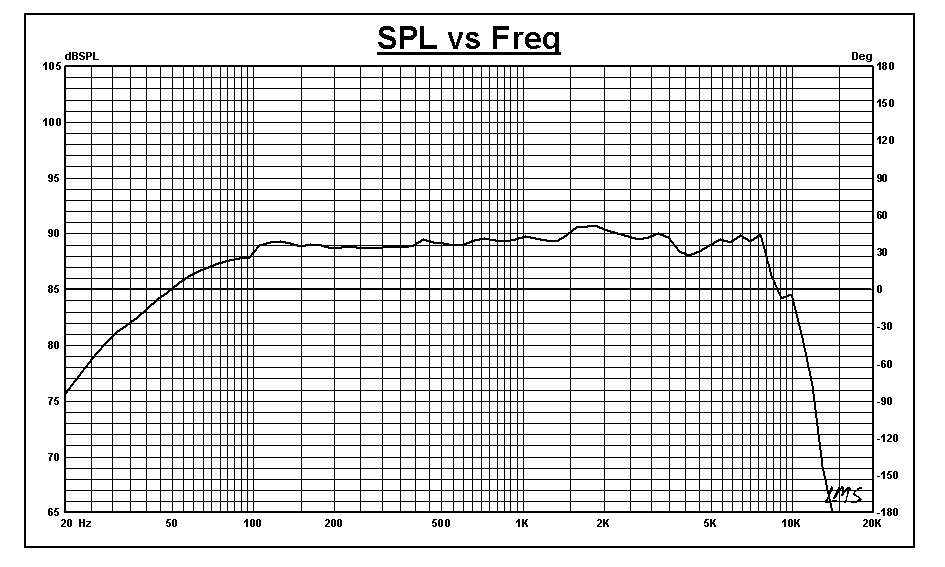

Another rather good midrange i used with hiquphon tweeter without crossover was this peerless. I think its on backorder or no longer available, like vifa. This could have been vifa replacement.
Notice lack of bass, ruler flat midrange, excellent of axis behaviour, almost no breakups.
Show me big midbass which can do this...

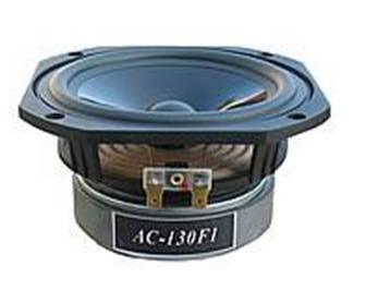

Wait, there is more...this is actually considered midbass, yes, it can do some bass. I made bookshelf with this aurum cantus which goes down to 30Hz. Not real bass, the cone is light and thin. But where it shines is midrange. Smooth, flat, goes up high enough to be crossed to ribbon tweeter, great of axis, almost no breakups. Used this one a lot. Not expensive, still available.
https://loudspeakerdatabase.com/AurumCantus/AC-130F1

Based on the X-over, it looks like he's using it as more of a "filler" driver than a traditional mid for a three-way.Seems Troels used this mid in a design.
Right, this is normally where I'd see something like a 3" dome mid or similarBased on the X-over, it looks like he's using it as more of a "filler" driver than a traditional mid for a three-way.
