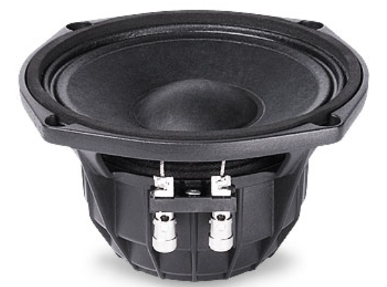

For me, a real midrange driver would be something like this:
Hardly usable below 450 Hz, but then equipped with enormously high efficiency and thanks to the 1.5 inch voice coil also electically quite resilient. It could theoretically reach almost 115 dB/1m.
However, the impedance curve doesn't look so nice, so we'll have to see what acoustical effects that has.
Resonances of that size will be audible. The task for those interested in high fidelity reproduction tends to be avoiding high efficiency resonating drivers and low efficiency drivers that cannot cleanly reproduce transients (e.g. fullrange or midwoofers) and look for drivers with inaudible resonances (e.g. stiff or well damped cones depending on design approach) with sufficient clean SPL (e.g. around 3-5" cone, 90+ dB efficiency and 100+ W power handling with some wriggle room). Assumes the woofer and tweeter are adequately sized to cleanly reproduce standard levels at 3-4 m in a room. If not (e.g. small desktop speaker or limited to less than standard SPLs) then other drivers may be suitable.

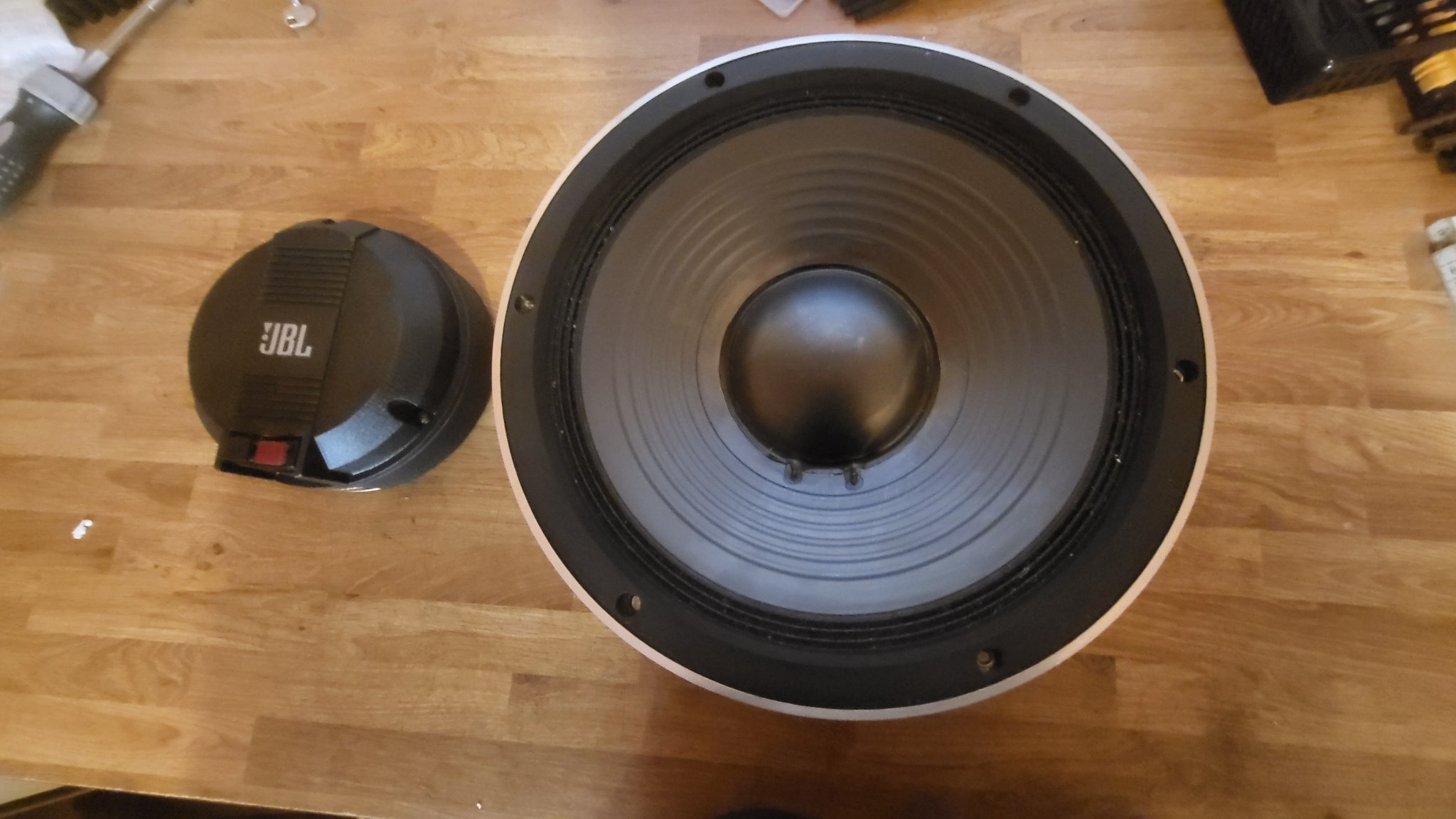

12" midrange driver, smooth resonance free output , low distortion and high efficiency.
11kg, limited xmax, high motor strength, coated damped surround, and a fairly stiff suspension.
This one is a bit too extreme' in terms of being designed exclusively for midrange. Hard to find a natural use for it really, not gonna deny that.
Or it's less refined 'siblings' like the JBL 2020H, although with a wider useable range and more advanced motor structure.
Pretty much the opposite of a 3" fullrange or 2-3" dome as long as were talking of direct radiators.
Different tools for different tasks.🙂
