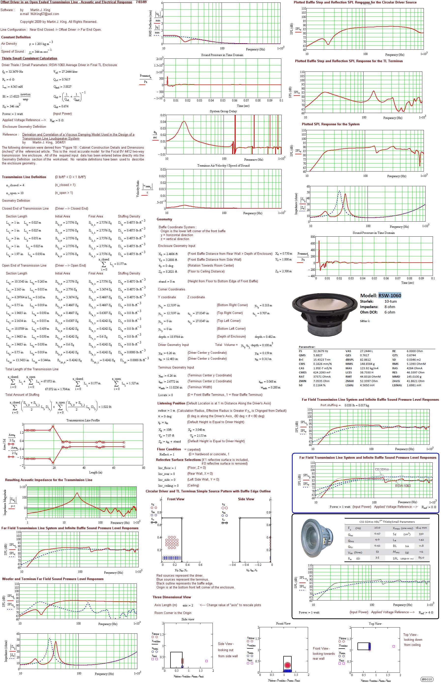

And that picture isn't saying me nothing, but it seems like it can be useful.

That box, isn't that a TL? Or is it a vented 50l tuned to 25hz?
Since i will probably use a Reckhorn S-1 for crossover i can play around a little with that and see what suits me best.

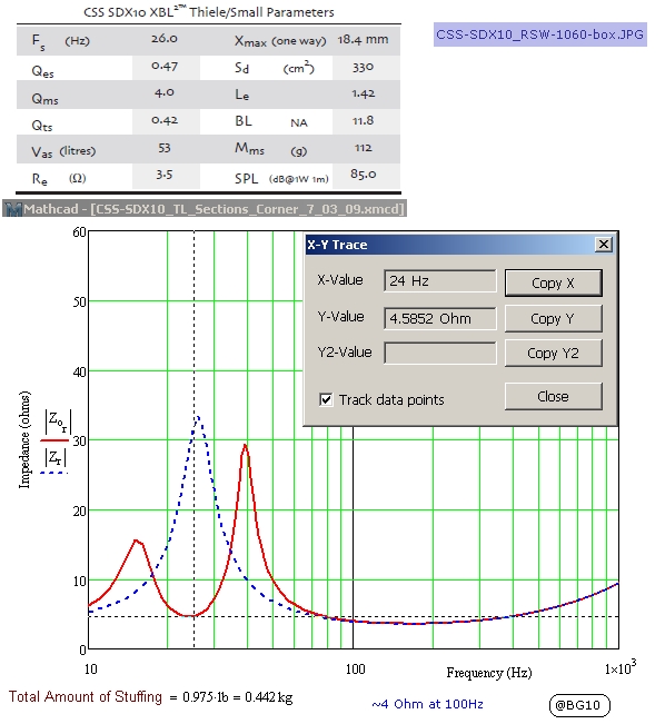

Some guy on the minhembio-fourm says that the HK3490 wont power CSS SDX10. Is he right?
I disagree, but it might be if he meant the raw driver just connected i free air or in a rookie box with improper cabinet load.
Here is the estimated impedance load curve for the CSS SDX10 box suggestion I made earlier without adding any connecting cable resistance or other losses thats always present in the real world.
b🙂
