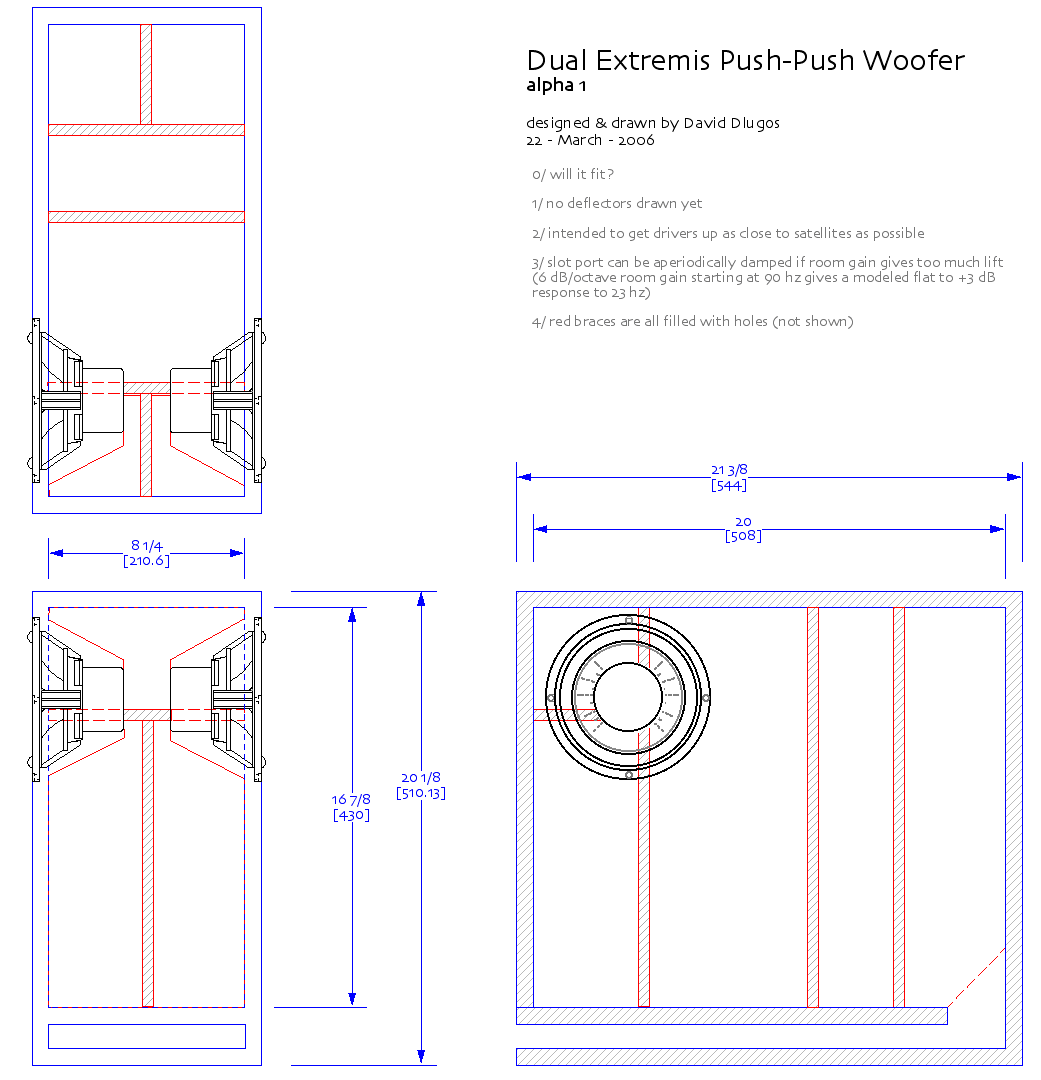

The high aspect slot port adds resistance making the response somewhere between what it looks like as a BR in the sim, and the response in the same volume sealed.

Take the port you have modeled (and model a fairly long one -- i usually try to get it close to one of the dimensions), and then take the cross-section of the port and change it to a rectangle... if you can get it as wide as the side that the vent fires out of and then as short a height as needed to fit the calculated xSection. For a woofer you probably want to keep it at least 2 cm high. You can add vent spacers to reduce the width if it is too long to fit the depth of the box without making it into an L.

An example attached
dave
Well, i guess i will have to make it an L to be able to get the port to get to the front. The box will be max 40cm deep. Or wait... If i mount the woofer on the side i can still have the slot port at the front of the box.
