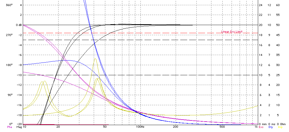

When reading the spec-sheet for the SDX10 i see they recommend a 43l box tuned to 24.5hz. And i'm gonna build a 50l box tuned to 25hz.
What's best?
And, is there a new version of SDX10 coming up within a year?
Not a whole lot of difference between those 2 vented boxes. A high aspect ratio slot port could go a long way to taming the peak from room gain.
