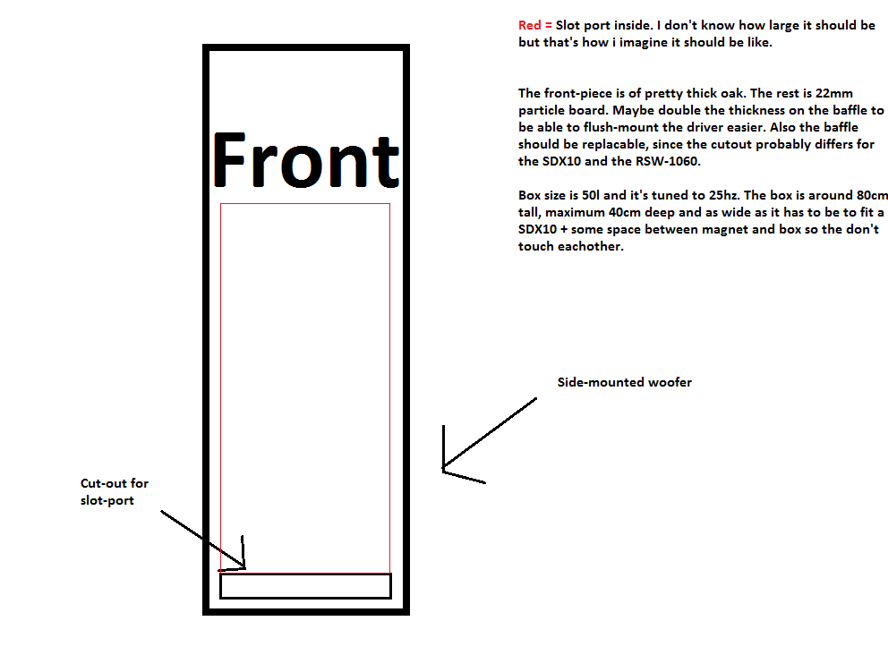

Well. The box i'd really like to build is a box which is around 80cm tall, maximum 40cm deep and as wide as it has to be to fit a flush-mounted SDX10 on one of the sides. The port is a slot-port on the front which ends in the bottom front of the box. The front will be a piece of oak, with a cut-out for the slot-port to end forward. And ofcourse i will optimize the airflow somehow since there is a 90-degree turn at the end of the port.
Would it be possible to design a box like that? Would it work?

Hmmm. With a side mounted woofer you have to xover very low or you´ll be in trouble. And solid wood...rather you than me, my friend. Wood "works" - it contracts and expands with changes in air humidity. It might split or tear your box to pieces.
(OK, so I´m a pessimist.)
Ah, i'll XO pretty high (around 80hz and maybe higher, don't know for sure yet) so it seems like i'll have to redesign the box...
But, the solid wood has been in the store for quite a while. Shouldn't it be safe to use?
It might, but using chipboard or MDF and veneering is safer. Hell, you live in a country where you might get veneer of what we call "Swamp Oak" - oaks that have lain in a bog for decades. Criminally expensive when you have to buy a whole pack, but absolutely beautiful.

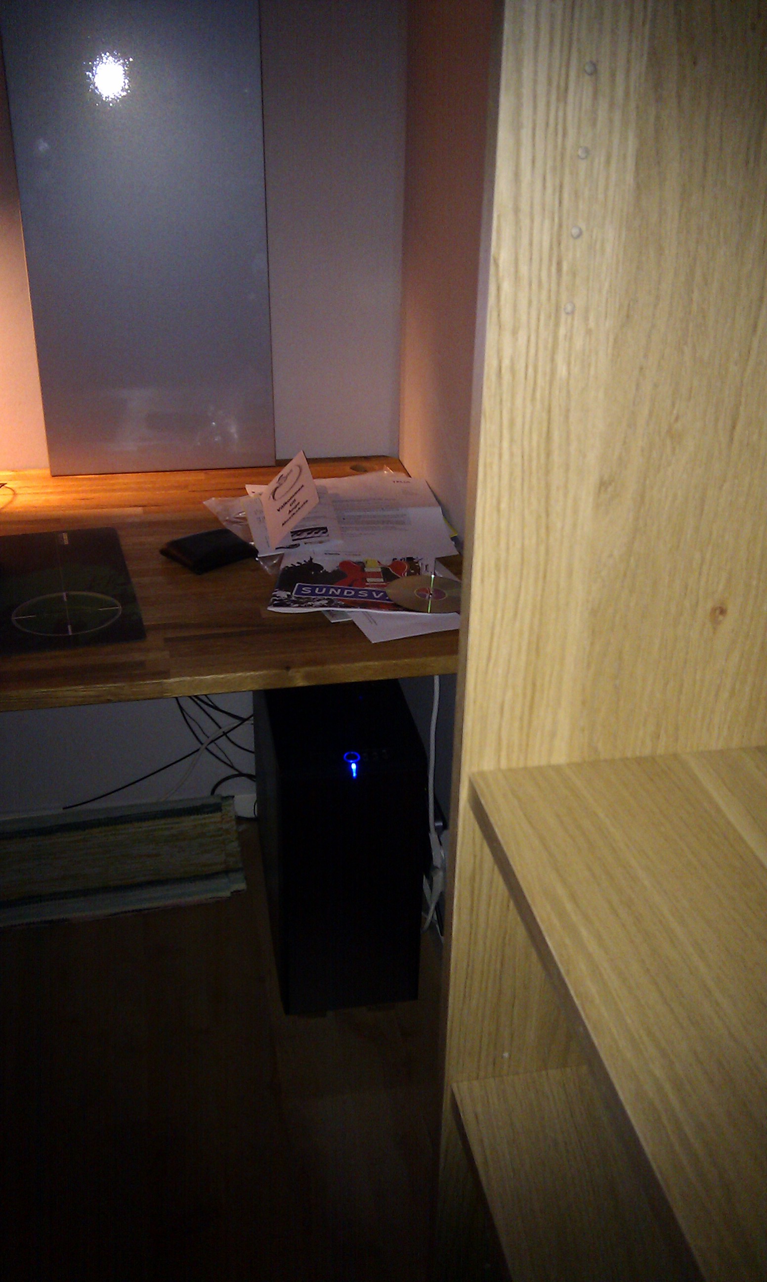

It wont look as good as a piece of real oak, to fit with my desktop. I've got some Ikea stuff which is veneer or something similar and it looks grey and boring. My desk looks more warm and full of life.
See attached picture for an example (sorry for the mess).
>My desk looks more warm and full of life.<
Get the three weeks old sandwiches out of the drawer and shoot the rats.
