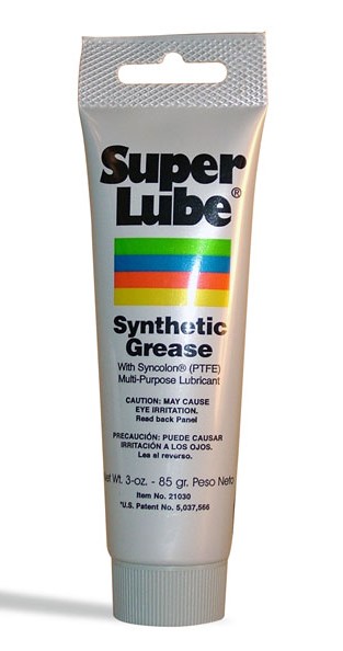

Super Lube is a brand name, not a single product. Which one do you use, WOT?
I've used this one for brake caliper slider bolts...
Basically, that can is the stuff I use, but I purchase it in a tube packaging.

Super Lube does an excellent job when working with plastic gears and glides. Just used it recently to repair an RCA MTT 130 turntable with an LP drawer (like a CD player) for my son. The belt went bad and the stylus was ready for replacement. He says it's sounding and working better than new now.
Good to know. I've started using Lucas instead but I rarely need grease in the house.
Apparently, they put Super Lube into a needle:

What I like about Super Lube (synthetic) is that it doesn't attract dust, stays where you put it, yet never hardens like petroleum type greases.
And on anything rubbing, or sliding, gears, it's just awesome.
Almost 30 years ago, I used it on my older VCR mechanism, and a turntable mech, and it's still slippery as all heck, and clean.
So it was a permanent tool on my workbench.
I've serviced hundreds of record changers etc and all still performing like new.
Car latches too.
I've even used it on my desk chairs that creaked every time I leaned back.

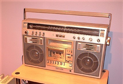

Well, I finally finished up doing some servicing needed on my 1980 Panasonic boombox.
It needed a few caps to improve the FM, and a little re-alignment.
Plus some switches needed flushing out.
Working on "similar" schematics was a bear, since this model had slightly different boards.
Sounds nice now.

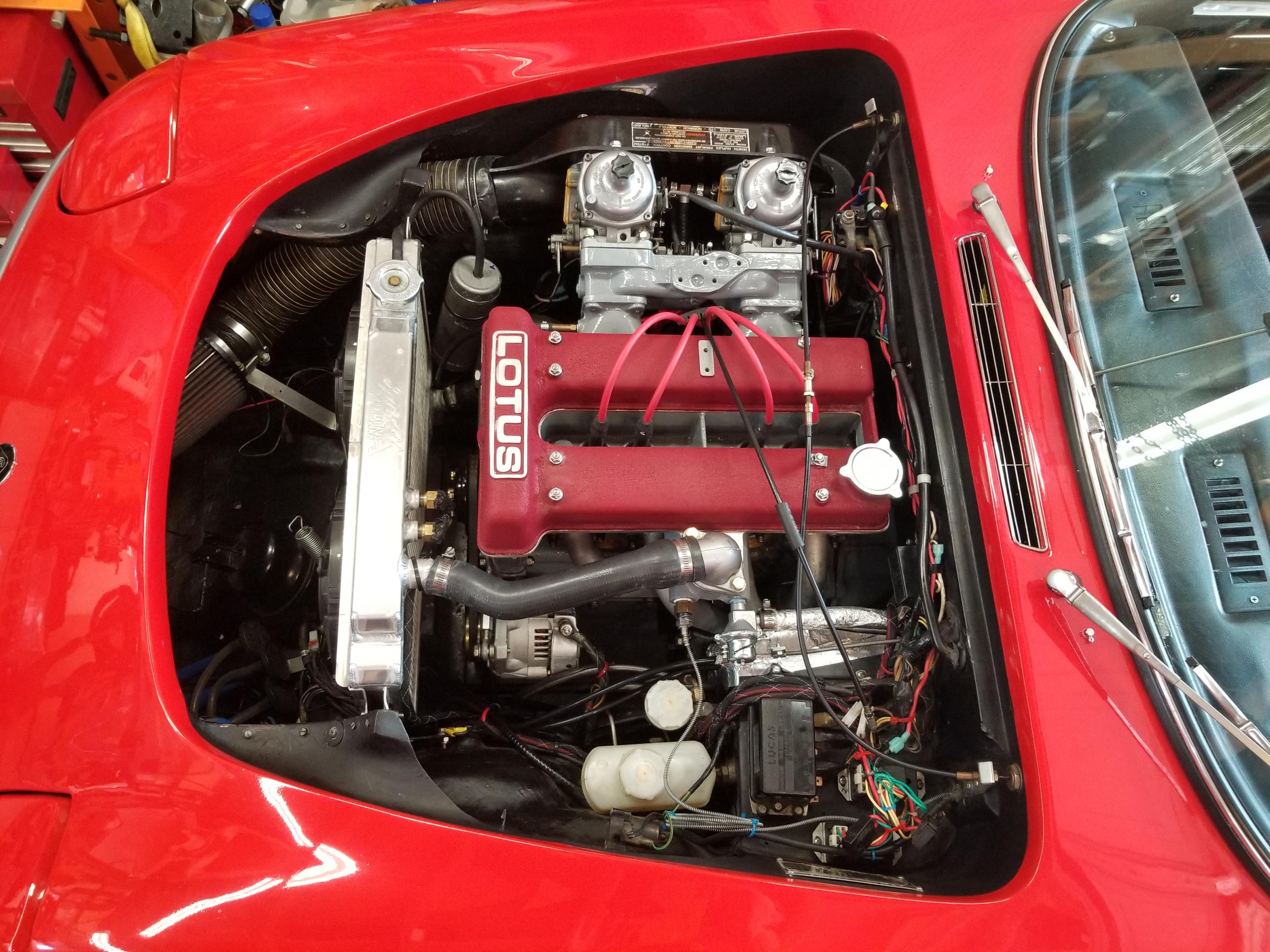

Acknowledging I'm in the minority here with the "foreign" cars... finished rebuilding this Lotus Twin Cam engine in my 1969 Lotus Elan along with the gearbox and driveshaft two weeks ago, followed by fiberglass repair of the driver's side sill joint to the floor which was poorly repaired by the previous professional.
Motor got some added power with a ported head and higher lift cams, forged pistons, along with a lighter steel flywheel. Putting in the break-in miles now.
