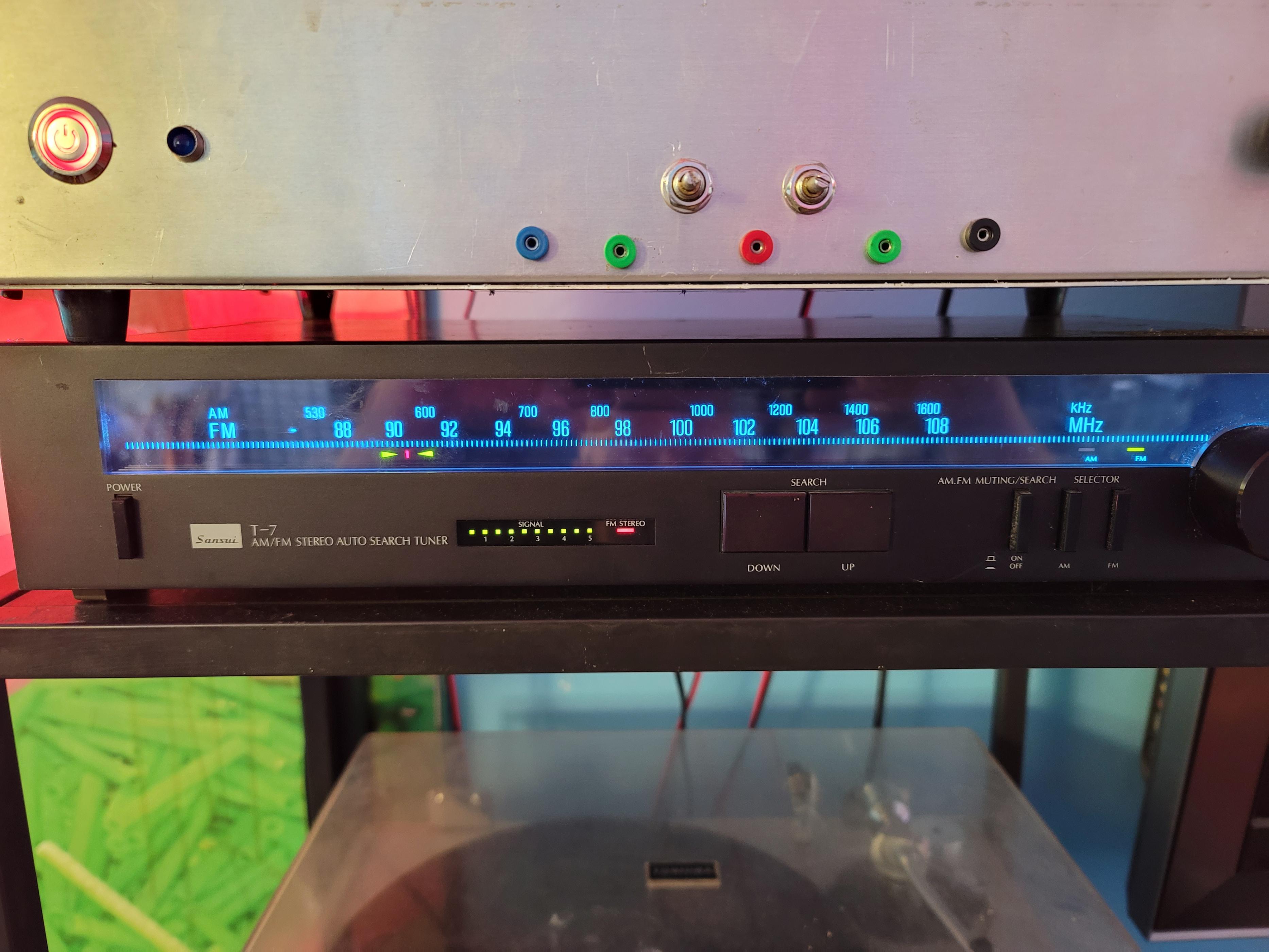

The "belt" wore out, and the dial light burnt out. It took me a while to find a suitable material to make a new "belt" with. I ended up using ribbon. The dial lamp was replaced "on the cheap" using a 5 cent RGB LED and three 0.25W 470R resistors. I think it looks nicer now than the yellow it used to be. I was too lazy to rectify the voltage, but the flicker isn't bad unless you're moving... Instead of running it from a bridge/filter (four diodes and a cap), I might just run another LED in reverse polarity. 60Hz is better than 30Hz. OTOH 0Hz is better

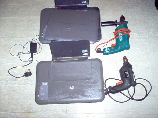

I have just retrieved it. A Hewlett Packard Deskjet 1050 with a broken lid. Not a hard fix, one feels. And I bet it has 4 totally usable printer cartidges. You can unblock dried-out cartridges. Smelt like a dead rodent after an hour in the bin. wiped down with bleachy cloth. But I have a HP 1050 of my own. Linux-friendly, you see. Good for spares for sure. The racket with printers is the cartridges cost more than the printer. And HP give you half-filled ones with the original.
Joins my collection of excellent mains drills, only lacking chuck-keys. And that is an easy fix with WD40 lubricant and a plumber's wrench and screwdriver. Better than more recent weak rechargeable battery efforts.
