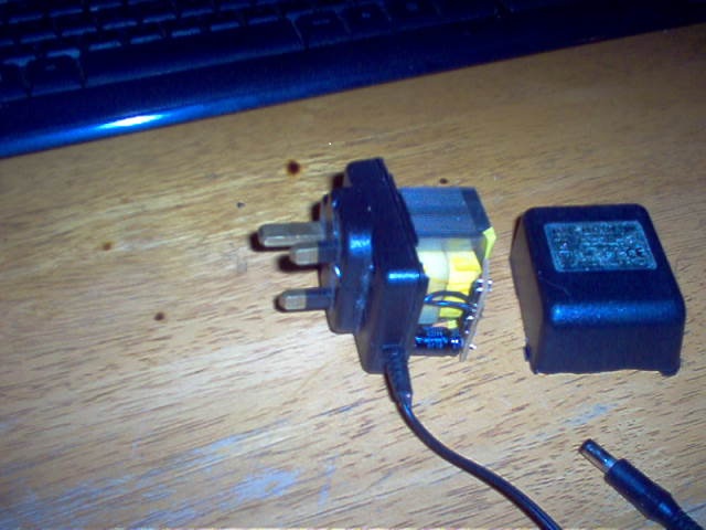

What's in those ubiquitous wallwart thingies? Not much it seems. Mine had been dropped.
Transformer (240V to about 12V one supposes), bridge rectifier ( 4X 1nN4001 50V power diodes), 16V 1000uF electrolytic capacitor for smoothing.
Not a hard fix. The capacitor was loose on solder so caused mains hum. Resoldered and glued back together with polystyrene cement and G-clamps. Guaranteed for 5 minutes!
