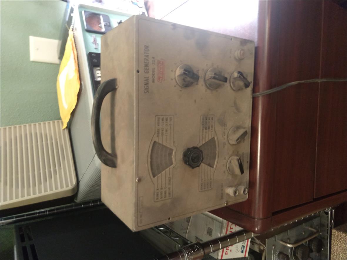

A client brought me the Eico Sig Gen a few weeks ago - I'll probably save the transformer and case and knobs, and just scrap the rest. Unless someone wants it ...

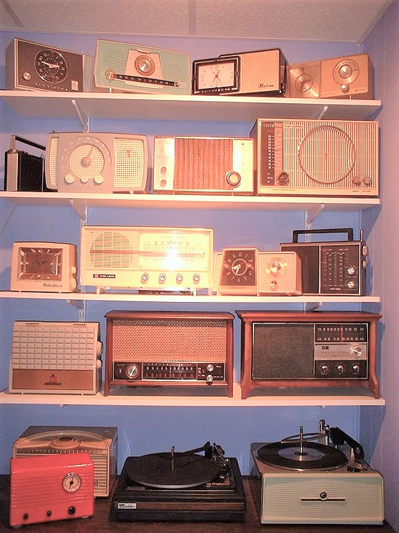

Nice collection.

I have one of those Eico generators in unrestored condition. I don't think I will get around to it.

That's a nice, clean collection. Mine are scattered around the house.

Oh, I've got a few scattered around the house too.
I use them all the time
In fact every room has a radio somewhere, including the laundry room and garage.
I like my music and news too much to be without them. 😉
