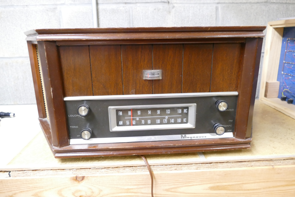

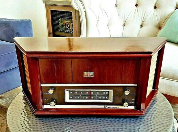

Recently restored/overhauled/re-aligned a 1962 Magnavox 0FM22 table radio, part of my collection.
I just sold it to my neighbor, he wants to use it in his dining room, and his wife is getting new dining room furniture of the Mid Century Modern style, so this adds to the look.

I have one like it, though not as pretty. It worked when I got it maybe 30 years ago, and still does, although it is starting to tell me that it might need a new filter cap. At this time there is no hum, but I can hear some 120 Hz IMD, especially on FM. Will any thing made today still be working in nearly 60 years?
The 3 section filter cap is likely on its way out now.
Replace it with 100u-100u-100u 250V three seperate caps, all grounded near the original can, but removed.
And lose the selenium rectifier - a 1N4007 is better.
Also, the 4uf cap in the discriminator is bad, causing lousy FM sound.
Don't attempt RF alignment unless you're qualified, that model is a bitch to do.

Enjoy your radio! It does have a unique look for a tube radio. The meter is pretty funky sitting there front and center.
I would use the closest can capacitor from CE manufacturing (tubesandmore). Using separate capacitors might be cheaper, but makes a mess and is more difficult to install nicely. I use new cans for any rebuilds I do. Stuffing the old can with new caps isn't really a viable plan either. There is no ventilation for the new capacitors. People forget that.

I have owned this radio for about 30 years. During a collecting / hoarding time in our lives we stomped flea markets and yard sales for "stuff." Once our parents started dying off and we had to clean out their houses, we realized that we had way too much "stuff." This was at a time when Motorola began their biggest downsizing phase, so I knew than my career was on life support, and we would leave Florida when it ended, and therefore have to move all the "stuff" that we didn't eliminate.
I had probably 30 to 40 old radios, some were quite collectible, others, just $5 yard sale finds like this Maggie. Stan (ESRC) had an antique radio show in his parking lot several times a year, so one day we took most of the radios to his show with prices on them. Every hour of so I would wander away from the car and my wife would yell, "My husband isn't here, come make an offer while he isn't looking." That worked, but nobody wanted the old Maggie, so I still have it.
I have never looked inside, so I didn't know that it has a selenium rectifier. That has to go if and when I decide to take it apart, they make a toxic stink when they fry. I have the equipment and skill necessary for a complete alignment, but rarely find it necessary unless sensitive parts are changed in the RF, mixer or IF circuitry. The radio is in a basement and gets the same 4 stations that I get in my car outside and they are in the right places on the dial, so alignment isn't needed.
I still have a few ugly duckling radios that nobody bought, and a couple that I chose to keep, like one of the first superhet's that RCA ever made. I fixed that one 20 years ago and it still works, but has developed an intermittent condition.
I also have an old Fairbanks Morse tombstone radio that I have never tested or even looked inside, it just looks neat. My first thought when I saw it would get me killed in some forums, "That would make a neat looking guitar amp." It is also too nice to hack, so if restoration is possible, it's life as a radio will go on.
