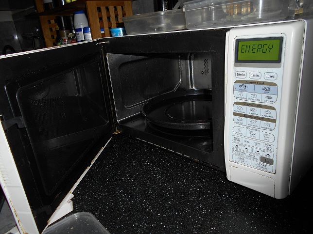

Found this in the street today. An ancient Sharp microwave oven. Very retro. :)
Smells like a rat has died in the back, but nothing a good clean with a bleachy cloth can't cure. Interestingly has a metal tray with a heating element underneath.
A keeper. :cool:

Turns out this over-engineered lump is a Sharp R-874 Microwave.
Sharp R-874-WHITE Combination Oven - Buy from Sound and Vision
Solid non-rust Nickel-Chrome alloy case. Dubiously unremovable interior lights.
Cooks Pizza and Breakfast. WOW! :cool:

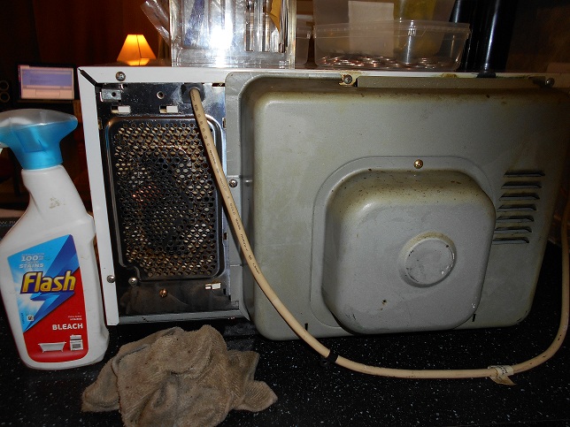

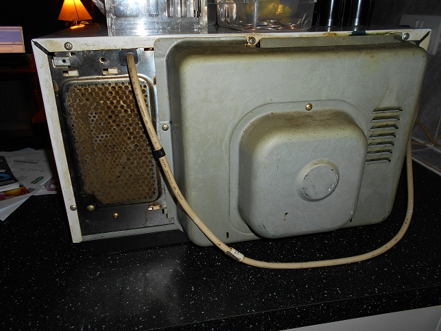

Further investigations reveal blocked rear vents after the exhaust fan, doubtless causing the DEAD RAT smell which caused it to be cast out, unloved, on the Street.
Dire warnings not to remove the covers, exposing yourself to High-Voltage and Microwave radiation. Never put me off having a go! Life is short, break some rules. :D

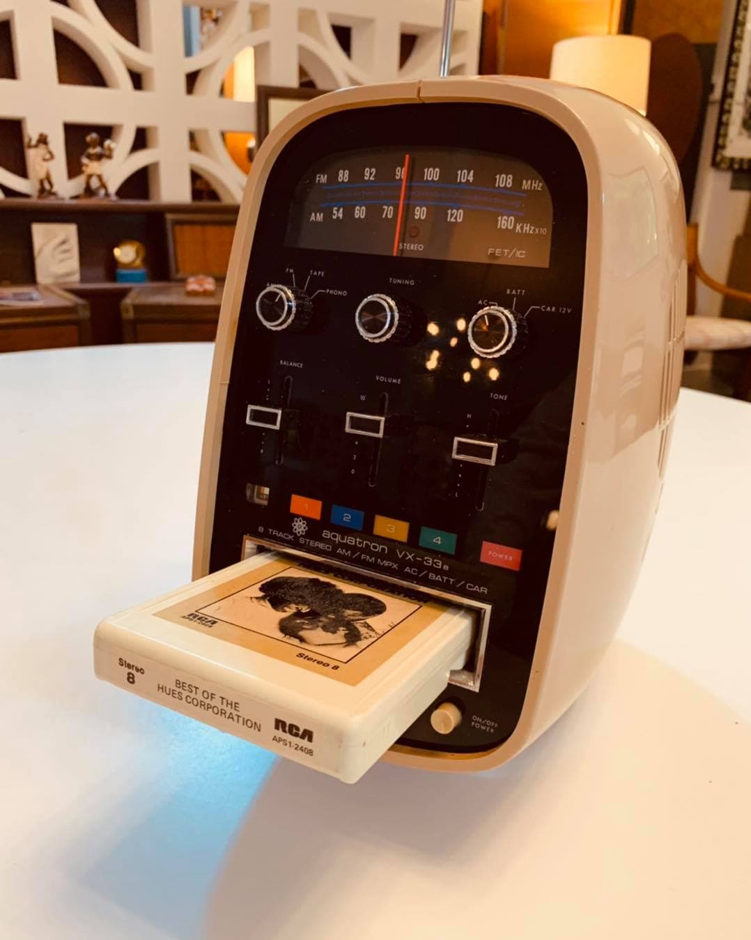

Fixed this little fellow. No sound, 8-track not running. All it took was a good bit of contact cleaner and fader cleaner. Cleaning, oil and grease got the tape going again. Now it sounds just like new, for whatever that's worth. :p
