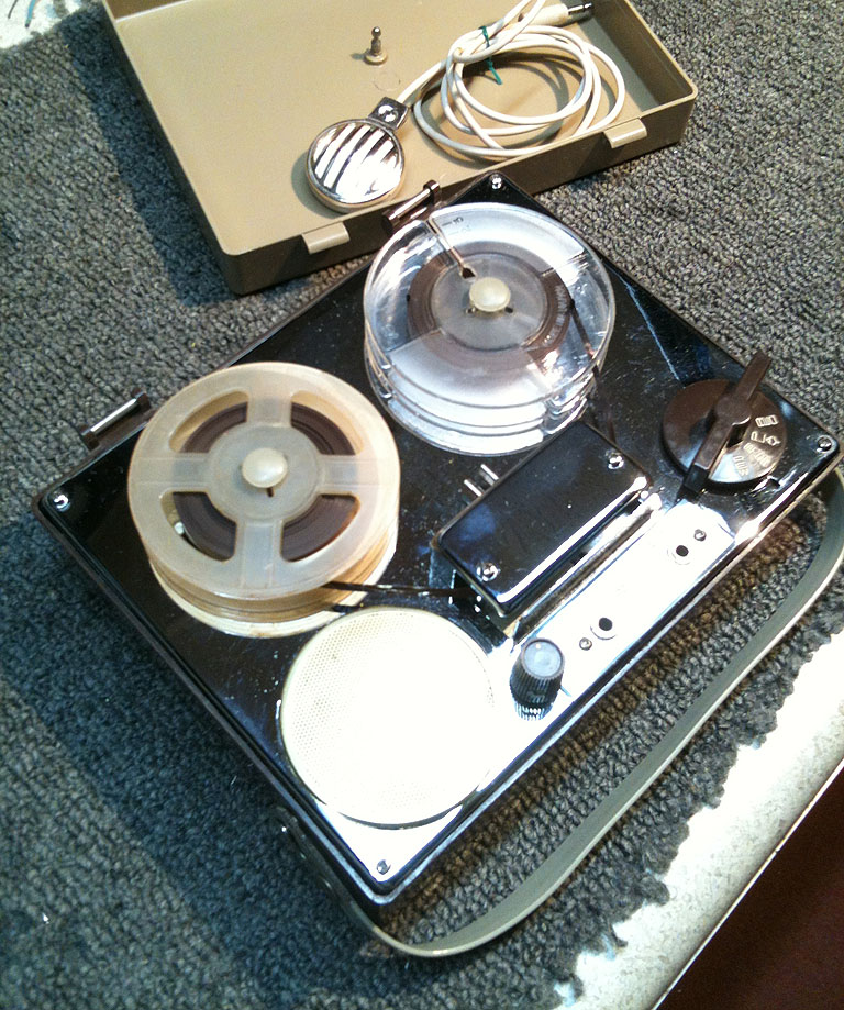

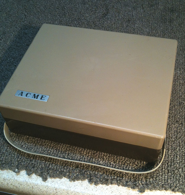

I got a bit bored, so I decided to work on a reel-to-reel.
It's an Acme 1500, (also sold under many other names) made in 1964, and no, it's not high fidelity, but it is cute.
Original price in 1964 was about $6.89, but I hear they're now going for $150 and up!
Needed all its capacitors replaced, a couple of PNP germanium transistors, and re-worked the dented drive tires.
Usual cleaning, adjusting, re-lubing.....also changed out the crystal mike element to a electret with some mods..... and guess what?
It works!

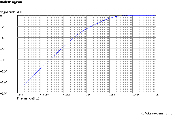

I made a change to my amp design to eliminate a strange situation where a LF impulse like a warped record would kick off an oscillation.
It turns out it was only partially stable, and connecting it to a free air speaker showed it. The speaker would move around centre position about 1mm either way like it was breathing at about 1/3Hz... My main speakers didn't show this so I never noticed.
So I've increased the gNFB resistor from 1k to 2k (this will work nicely with the reduction of gain I expect by adding a balance control), and adding a 0.033uF cap in front of the input making it a 2nd order filter instead of 1st order. Now, extremely LF spikes are fully suppressed, and a warped record won't put it into oscillation. Made the change to all the amps - result 🙂
For those who are interested, the filter is 0.033uF,1M,0.22uF,510k.

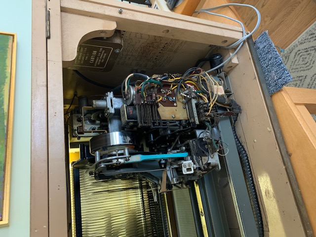

Working on a Seeburg "Library" jukebox for a buddy of mine. He had the mechanical aspects of it looked at a while ago, but when he used it, it would play one or two records successfully, and then he'd lose the sound, replaced by a crackling sound, and that was it. He could turn it off and later return to it, and the same sequence took place.
Yesterday, I shot the volume, bass and treble pots with Deoxit, and, as I had suspected, it works! I'm going to do a little bit more cleaning of tube pins, and I'll replace what tubes I can, but it's gratifying to quickly get something this nice up and running again.

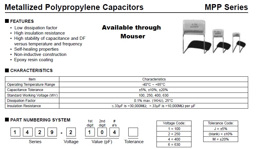

A pair of Carver Silver 7t amplifiers. Standard Carver issues (which aren't bad by any means), and a solid performance upgrade. The customer will be completely gassed when he hears these again. Looking forward to his comments ...
Next on deck is a Carver M1.5 destined for the same treatment. The capacitor adapter boards available from Ebay and other vendors are garbage compared to the factory unit (I still have one - but it is sold). So, got busy and measured the factory PCB and designed (copied) that. The boards from China are perfect and accept the square mounting pins and snap type capacitors. Fits perfectly and has the angled edge to clear the chassis.
To those happy folks who use normal capacitors, with or without a PCB) - you're doing it wrong! To the cheap skates who don't even use a PCB, you are a hack, a complete hack! When I see these, they get a proper capacitor kit or I won't work on that item. Using normal leaded capacitors demonstrates a lack of understanding that shows you are not qualified to work on amplifiers. Especially not a Carver or any other quality amplifier.

Hi Randy,
Depends on the circuit position firstly. Kemit is good, as are all other quality capacitor brands. Most people are not aware of this and search for the perfect capacitor. Buy axial caps to replace axial caps (not "orange drops" for gods sake!), and radial caps to replace radial caps.
Above all, the new capacitors MUST fit the board properly. If they don't fit, do not use them. Usually that means measuring the max diameter and length.
It is the dielectric of the capacitor that is important, not the brand. That and the build quality, so hand made capacitors are out! So are bees wax, oil and paper (PIO) types (garbage).
Hint, ESR doesn't matter at all! DA is the critical factor. Anyone who says different doesn't know what they are talking about. I have two expensive capacitor testers that measure all parameters (thousands each). I also have an analogue LCR bridge (GR 250DE), plus years of experience. Capacitors is an area where you have a lot of snake oil being sold by "experts" who test by ear only. Those folks are lost at best, total liars out for a buck often enough. Looking at the output spectrum of active circuits using different capacitors will tell you the truth about what is going on. I have for years.
