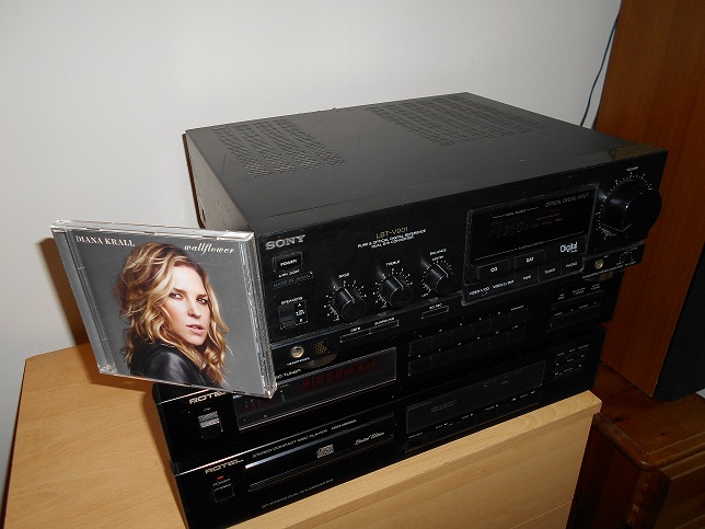

More luck with my dodgy old £30 Sony amplifier. Kept losing the right channel. Take off 4 case screws and spray volume control with aerosol switch cleaner. Excellent.

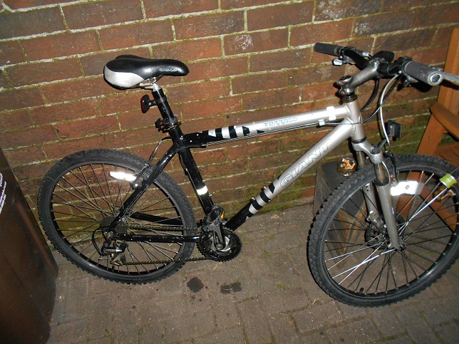

And on a roll with dodgy freebie bike with locked up handlebars. New stem ballraces for £5. Old ones had rusted. All greased and set up to go faster. I always forget to put on handcream before these jobs, so filthy nails for the next week. 😀

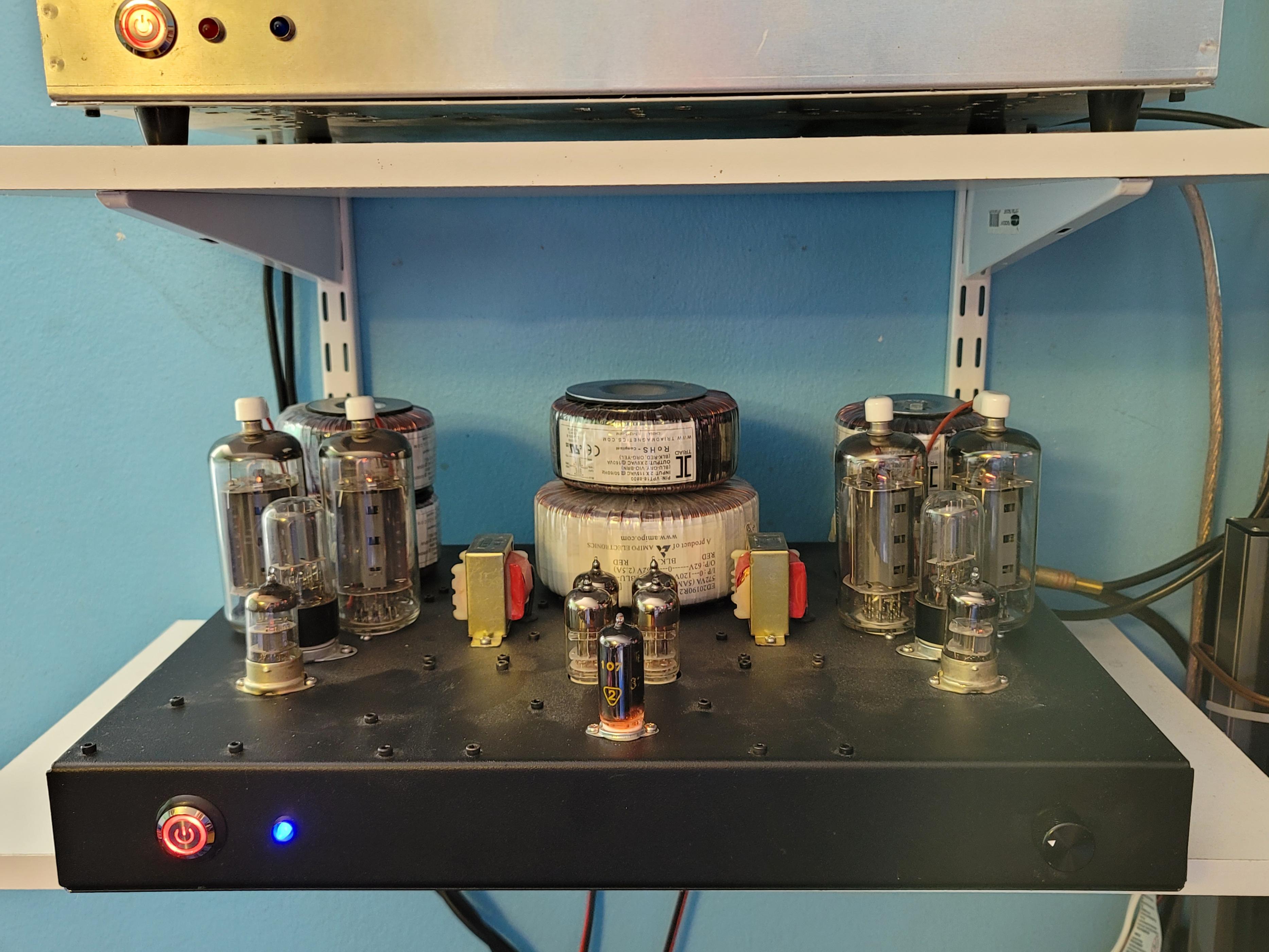

Not so much a repair as a modification.
I changed 50VA VPT12 to 100VA VPT18, swapped 6P36S for 6P45S, and changed some values in the phase splitter.
Happy me.
My camera sure shows the dust in this place... They are building 4 condo towers within 200m of here - it's so dusty all the time!
Happy me.

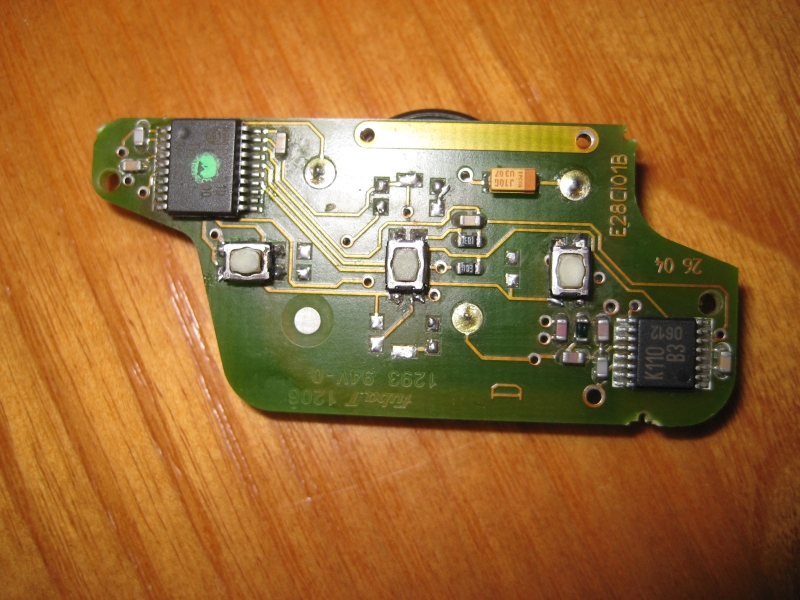

Key fobs
A pair of key fobs repaired: too many push buttons destroyed by oscure forces, or maybe napalm, in the recent past. Second-hand push buttons here, desoldered from other old key fobs. Actually, too much SMD reworking, for my friend's "chic" Peugeot roadster. 😉
