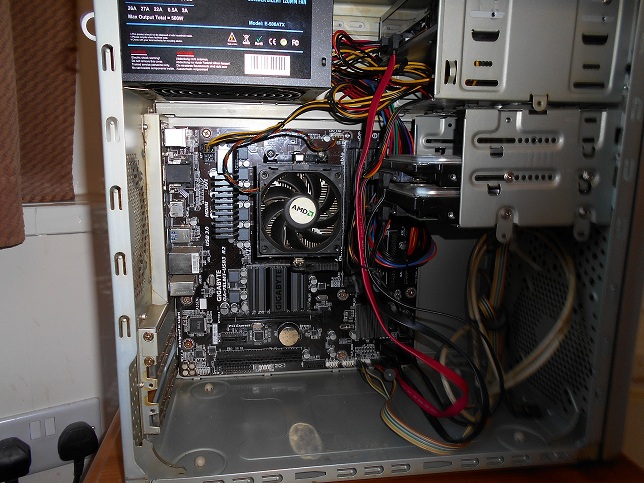

Computer rebuilt... 😀
AMD Athlon II X4 630 vs AMD FX-6300 Six-Core [cpubenchmark.net] by PassMark Software
8GB of DDR3 memory, improved onboard graphics. USB 3.1. FX-6300 six core replacing the old overclockers favourite, the Athlon X4 630.
Seems nippy enough. I bought most of the bits second-hand. Pleased with that.

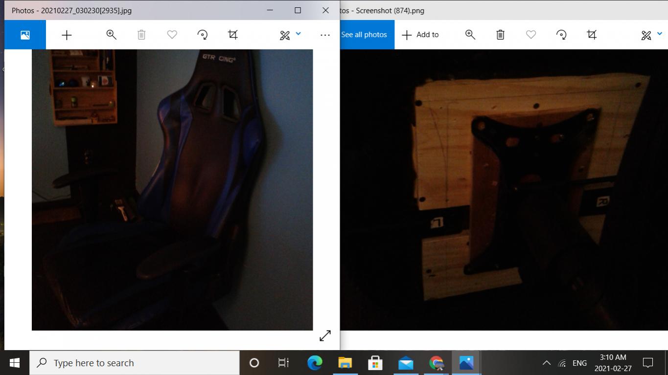

The base screws stripped and let go. I couldnt let my favorite chair go to the waste heap.
One new pedestal of 3/4" ply + 1/4" hard maple. Along with 3" deck screws to reach through all 3 ply layers + 3/4 of a bottle of carpenters glue. Its holding perfect now. It reclines swivels raises lowers tilts rolls and rocks. Cant make a sandwich but thats ok.

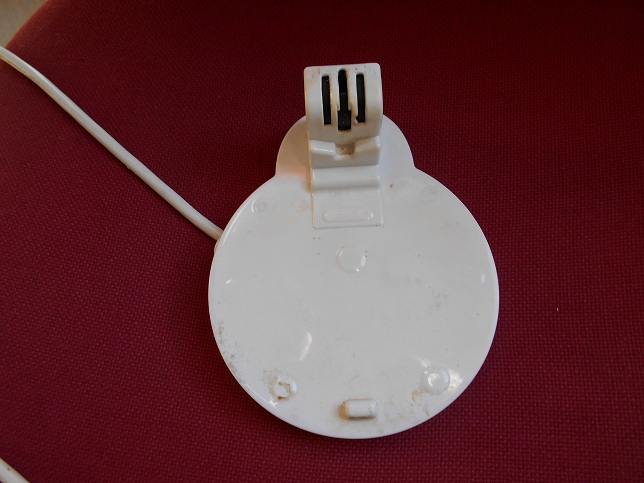

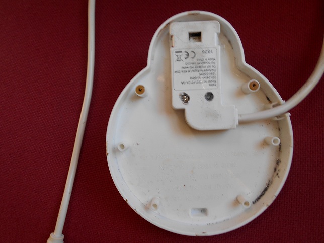

This has driven me crazy for years. Kettle sometimes works, sometimes doesn't. 😡
How hard can it be? Must be bent copper in the mains connector. Once past the stupid security screws with a drill, I have bent them back into shape.
Excellent. At my age we just hope things will "See us through...." 😱
I think its the light sensor, the flash works but its not always bright enough. Time for a new phone. Current phone, was dropped too often.
I think I did well on the fix. A clean install and its much much stronger than the single piece of 1/2" of plywood holding clawed threads.
