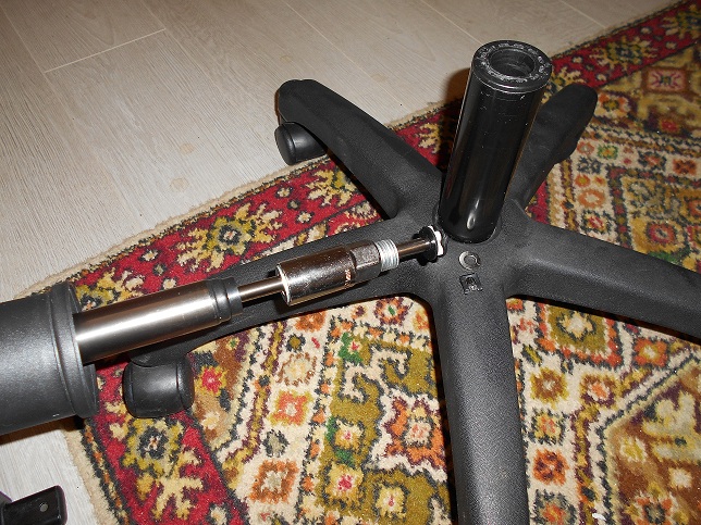

A Sinking Office Chair.
Found it in the street. Broken of course, the gas cylinder is broken, so it's too low. 😕
Easy fix. Google. Found some discarded PVC pipe over the road at the house renovation. Cut a 2" piece.
How to Fix a Sinking Desk Chair: 11 Steps (with Pictures)
A £100 chair for nothing:
Full Lumbar 3 Lever Operator Chair With Adjustable Arms - Furniture At Work(R)
Sitting on it now. 😎
NO! It's all gone horribly wrong! 😱
The top of the chair has gone wobbly. The top is held on by your weight. By relieving the pressure with the bit of PVC pipe, there is nothing stopping the central pillar falling down from the seat. Maybe I overdid the refurbish with two much WD40 lubricant?
Looks like I'll have to go route 2 and put my hand in my pocket and buy a 3/4" jubilee clip and some Duck Tape. The Law of Unforseen Consequences. 😡

THE SAGGING CHAIR IS FIXED!!!! 😀
Stupid Internet ideas:
1) Spray WD40 on thin shaft. Didn't do a thing.
2) Fit PVC pipe collar underneath the seat. Chair went wobbly and about to collapse.
3) Fit Jubilee clip and rubber sleeve under chair. Slowly sank and then disintegrated.
How hard can it be?
4) system puts thinking hat on. Improvise a spacer with washers and an unused 21mm socket head.
IT WORKED!!! 😎
(Lawyer talk: 5 minute guarantee applies...)
Given all the time and energy you've spent on that, it better be a seriously amazing chair...

TBH, I probably have overdone the washers:
Feels a bit high. But adjustable.
