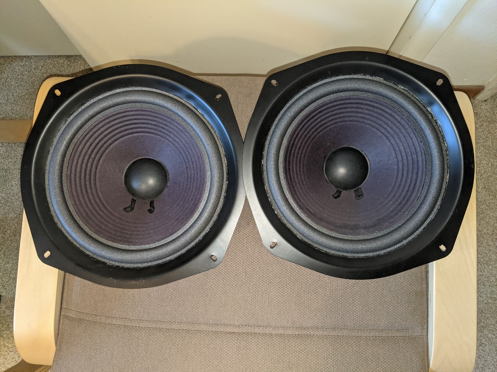

Last visit to my parent's house my father told me his speakers (Advent 25th anniversary edition) weren't working right, all he got was distortion. I pulled the grilles and sure enough, the foam woofer surrounds were shot. No surprise after 25 years or so.
The woofers came home with me. Refoam kits from Midwest Speaker repair arrived yesterday, and now they look as good as new. First time I have done this, but it's simple enough. I'll be heading down again tomorrow to reinstall them, and set up the new internet gateway that ATT sent him.

I was surprised that re-coning a pair of woofers was easier than I thought it would be. I did this for a pair of my father's speakers about 20 years ago.

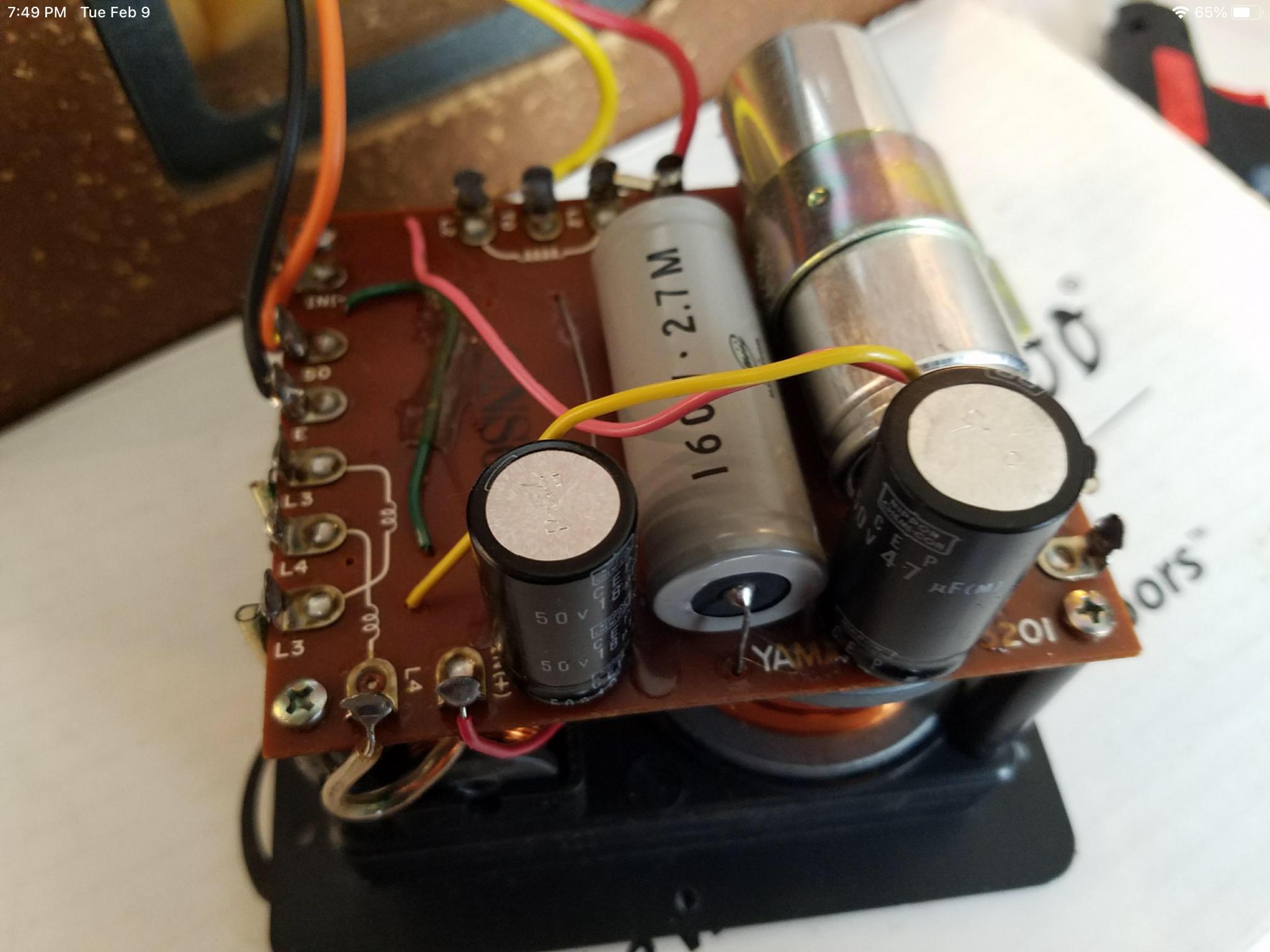

Rebuilt the xo’s in the NS670’s I scored about a month ago for $100
Listening right now and gotta say the difference is quite noticeable to the better.....I thought they imaged well before, now it’s almost freaky....the separation between the instruments and even vocals. quite a enveloping speaker.

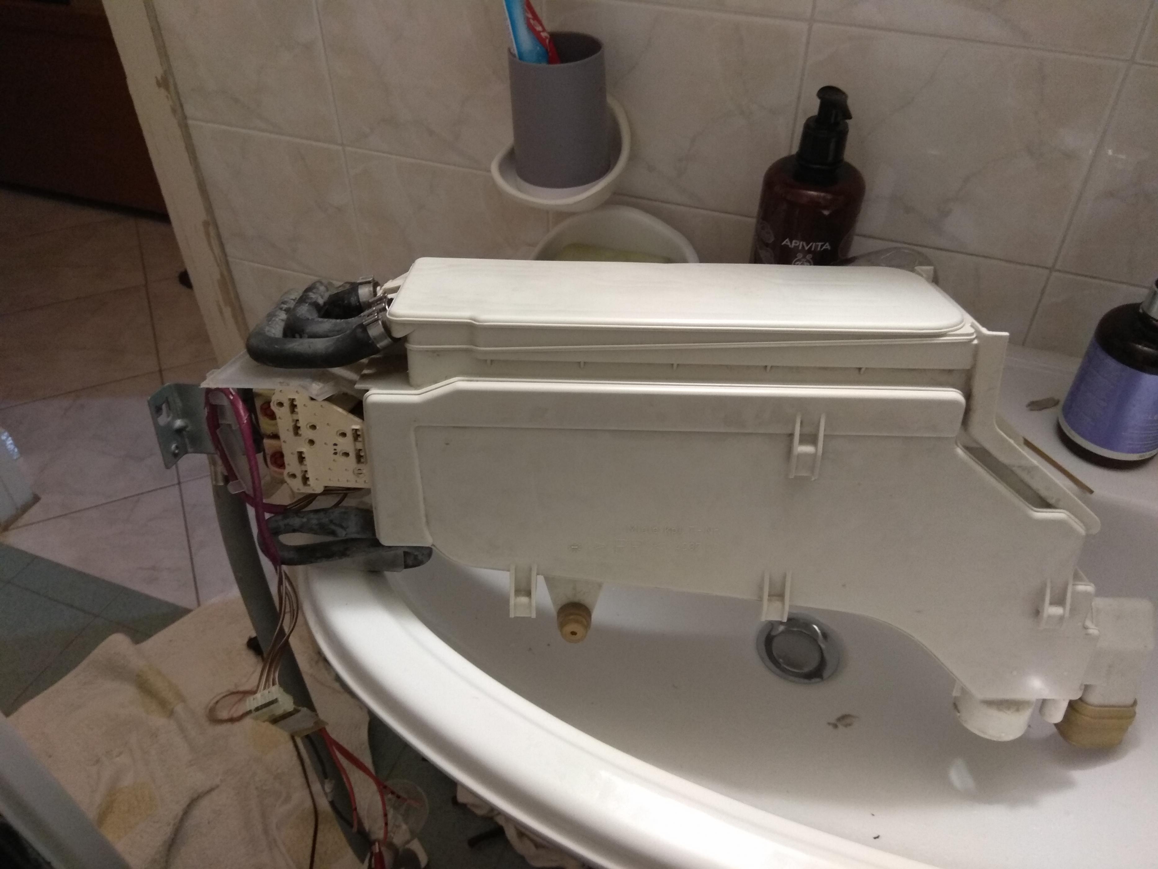

My Miele washing machine.

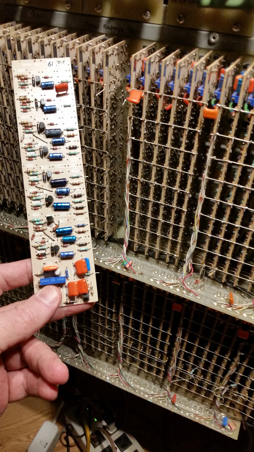

One of my church customers has an older electronic organ that's had an intermittent note for going on 2 years now. During that time they've called me twice about it, only to call back before we could schedule to say, "Never mind - it's working again." This winter it finally went dead and stayed dead, so I did the 1-1/2 hr. drive up there today to take a swing at it.
Finally remembered to snap a coupla pics this time! Get a load of this silly crap:
These are called Gate boards. This group is for the organ's bass pedals. 32 daughter boards, one for each pedal. Musical pitches of various octaves & waveshapes enter from the backplane via the protruding resistor tails. They are then gated on & off via a single 12VDC pedal gate voltage, with appropriate attack/decay constants applied. The audio outputs are collected onto the buss wires in groups of 6. The problem of course is that the whole thing is soldered together in one big solid block of sadness.

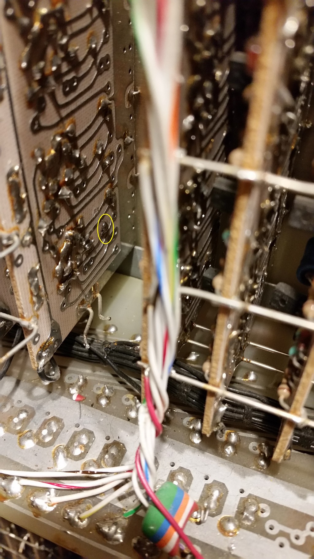

After locating the board with the dead pitch (I have virtually no schematics for this thing), I decided to chop loose the functioning board directly behind it, so I could at least have some room to probe the defective board in-circuit. I'd wedged down the problem bass pedal before I even removed the organ's back cover, so I'd know immediately if the dead note came back to life during disassembly. By some miracle, it actually stayed dead throughout the process of removing the adjacent board (power temporarily removed of course), and only came back when I was right on top of the action! How often does that happen!
I soon discovered that I could flex the bottom corner of the board and make the note come & go. From there it was a simple matter to find a resistor lead in a through hole that had functioned for 40-some years without a drop of solder on the pad. These boards were clearly hand-soldered, and this one pad just got skipped. Monday morning or Friday afternoon? Who knows, but it was sure satisfying to sit there for a minute with a spudge stick and play "Shave and a Haircut" on that loose resistor lead!
Anyway, I forgot to take a "before" pic, but here's the "after":
Now comes the fun part. I was prepared for a nightmare of trial & error, trying to get all those stupid little resistor tails lined up just right to go through the holes in the backplane. Amazingly, it took only a couple of tweaks before the whole thing just slotted right into place! Holy cow. Had a bit more trouble spudging those dual ground buss wires (along the bottom) back through the board holes, but not too bad really.
