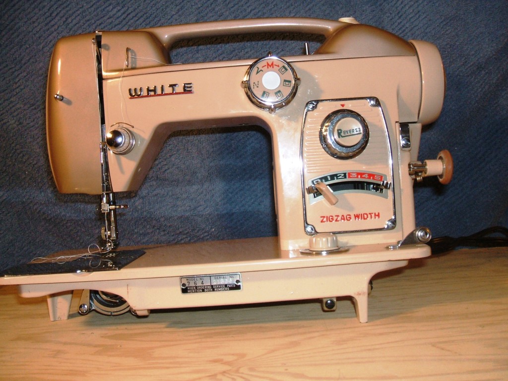

White Sewing Machine Company, Model 764, circa 1964 - 66.
I have been lusting after one of these for a couple of years. Mostly because of appearance: All that sexy curvaceousness. And the art-deco design elements out of the 1940's or early 50's, though it was designed in the early 60's. (Compare to the Norfolk & Western J-class locomotives (late 1940's) or Chrysler's Air-Flow cars (late 30's).) And maybe a bit because my dad worked for White in Cleveland when I was born in 1951, though he left soon after when product design and manufacturing started moving to Japan.
One recently showed up on EBay at the upper end of my budget. The seller said it was in good working order, and photos showed almost no cosmetic wear-and-tear. Well . . . the motor turned, and the needle bar moved up and down.
I fixed the clattering by removing old, dried, grease and oil, and lubeing with modern silicone-based lubes. The bobbin case was broken; $20 from a local sewing machine shop. The spring in the thread tension assembly was badly twisted; possibly from packing and shipping. $10 from an online source. The toothed drive belt had taken a set and lost elasticity so I pre-emptively replaced it rather than face a sudden failure. The tire on the bobbin winder wouldn't turn due to a glazed and hardened surface; I fixed it with an emery board.
Now it sews several layers of heavy denim without significant sag in the motor speed. I just need to get motivated and find a project to do with it. Perhaps my grandkids will use it for the next 50 years or so!
