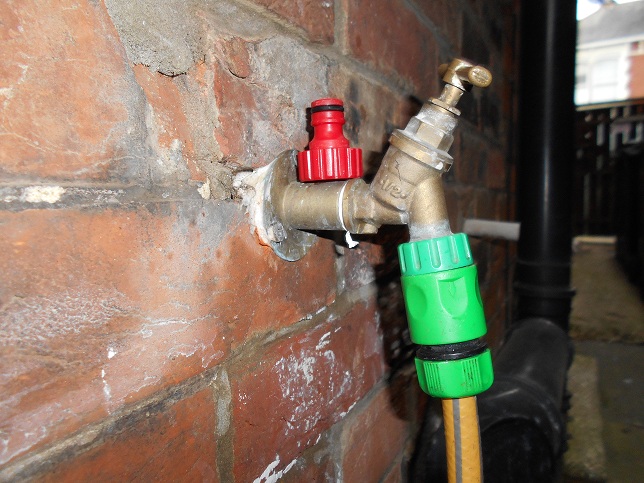

Before he went he took off the brass tap connector for the hosepipe for whatever reason. We can't find it. And we can't ask him.
I am now promoted to head gardener and tried to fix it. Turns out there are THREE types of hozelock connector of different colours attached to the Hozelook pipe reel. All totally incompatible on thread and diameter though they look the same.
Red, Green and Grey. Who designs this stuff? :confused:
Much fiddling about. I had to drill a flow hole in the green one (which was some sort of sealing cap) to restore service without drips. My neighbour Matilda loves me. She hates flogging around with watering cans to keep her climbing cabbages in the greenhouse watered. :D

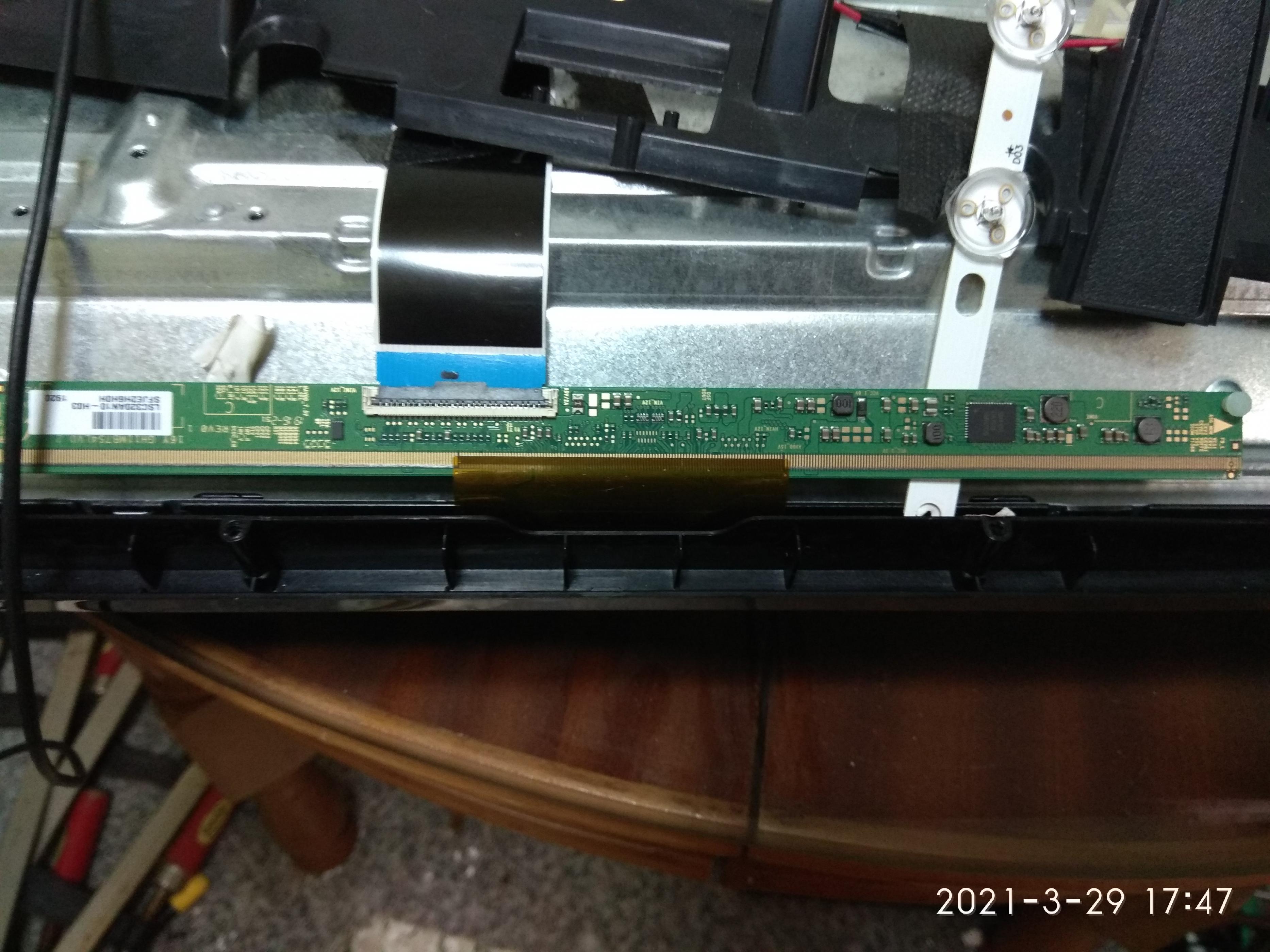

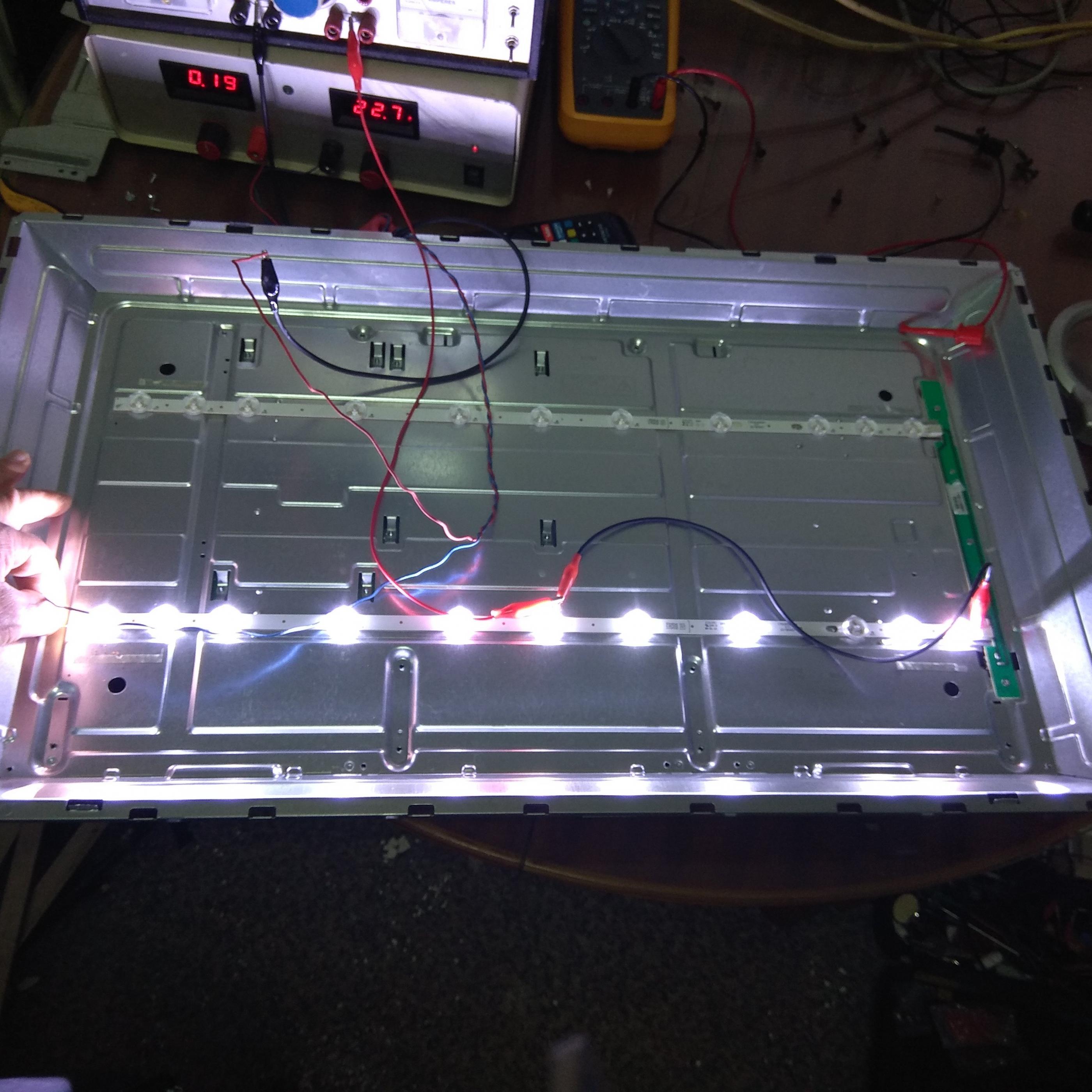

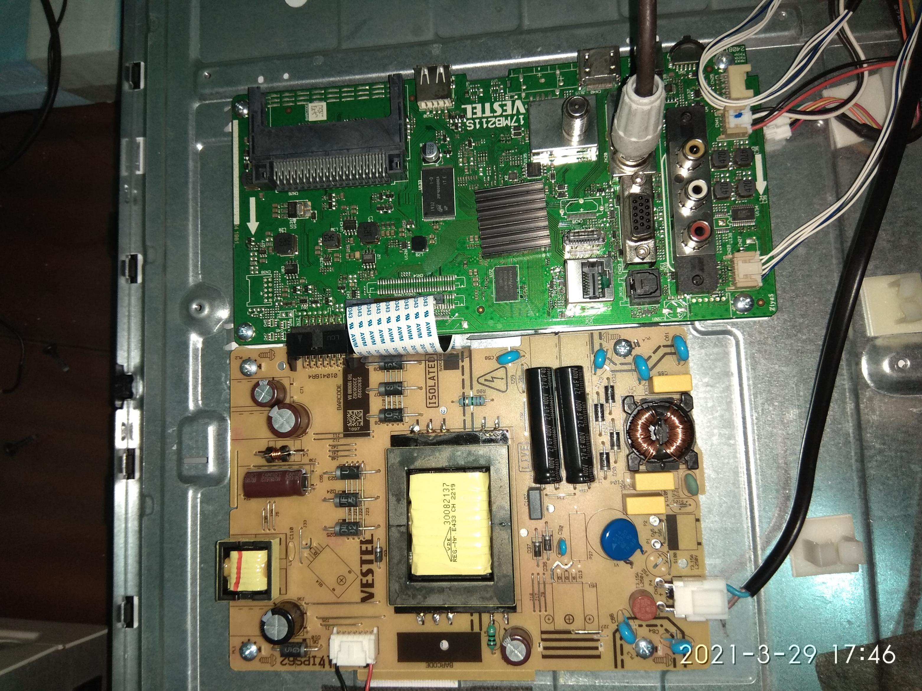

I have bad experience with a 32" Hitachi LED t.v.
When this goes from standby to on the logo "Hitachi" appears and disappeared instantly and then you can hear the chanel audio only.Led bars no light.
When the lcd panel removed i show a shorted led.
New led bars installed and then... Icd is death.
No logo at start up.
Now new led bars light and dim correctly.
Trying to scope lvds signals, i see an i.c SM4186.
I can't find any information no pdf for this i.c.
The only information i found is that is a d.c to d.c converter.
I found some voltage measurements too.
According to those, pin 1 is 15v.
Pin 2 is 12v.
I have nothing (0v) at 1&2pins.
I don't know if 1 is output and 2 is input.
I found other voltages in other pins, like 12v 5 v e. t.c.
Any help here?

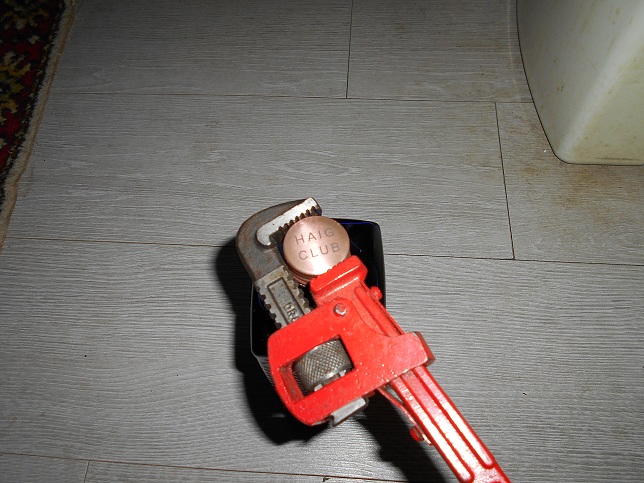

You know the old problem of getting the tops off Jam Jars and Whisky Bottles that the other half often presents you with? Usually just takes a firm and confident grip. :)
Nearly defeated myself tonight. Couldn't get this bugger off even with a cloth. :confused:
Adjustable spanner failed miserably. Resorted to an old technology "Plumbers Wrench"...
Success! System7 pickled again. What is an engineer else supposed to do in lockdown? :rolleyes:

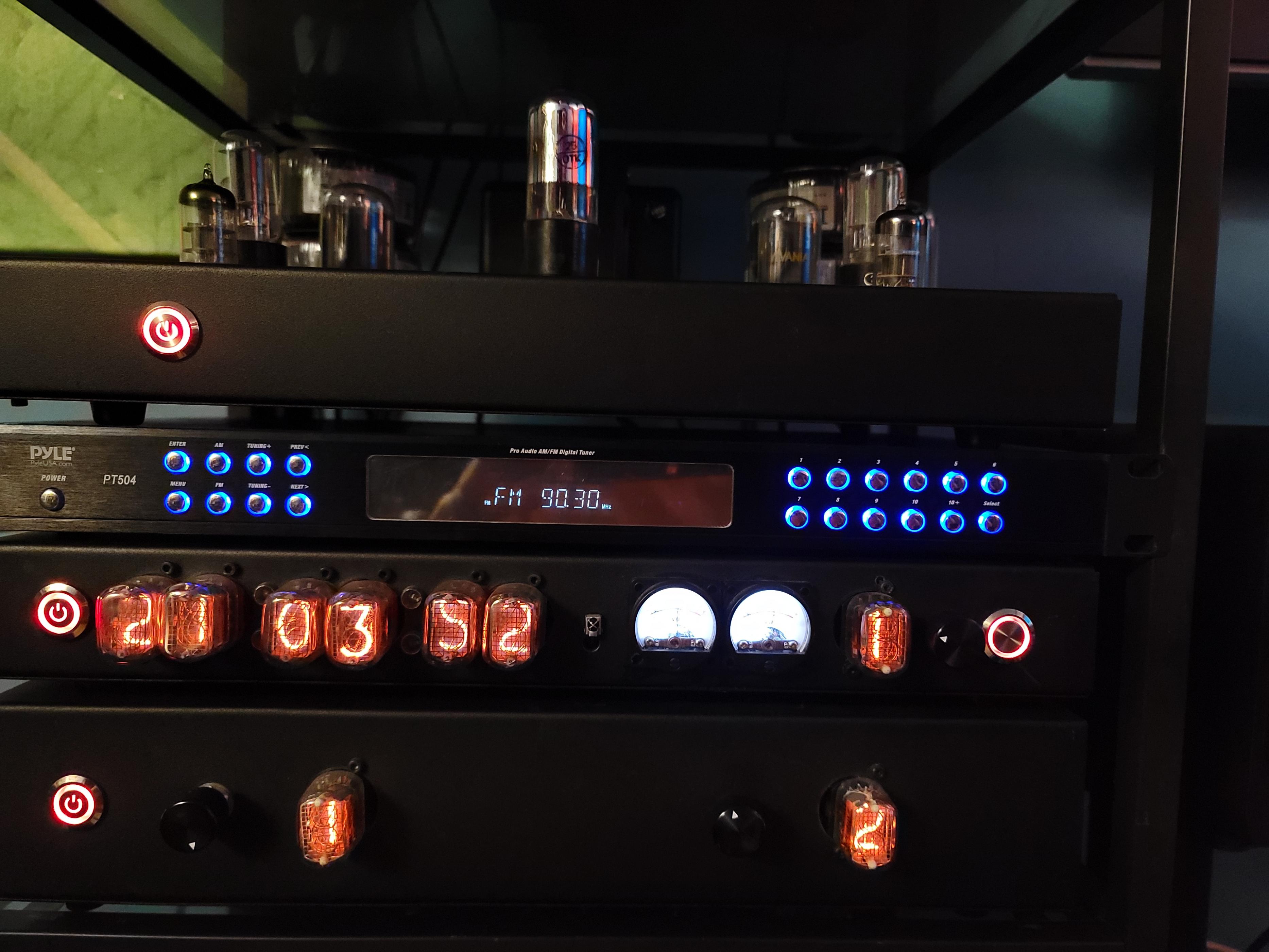

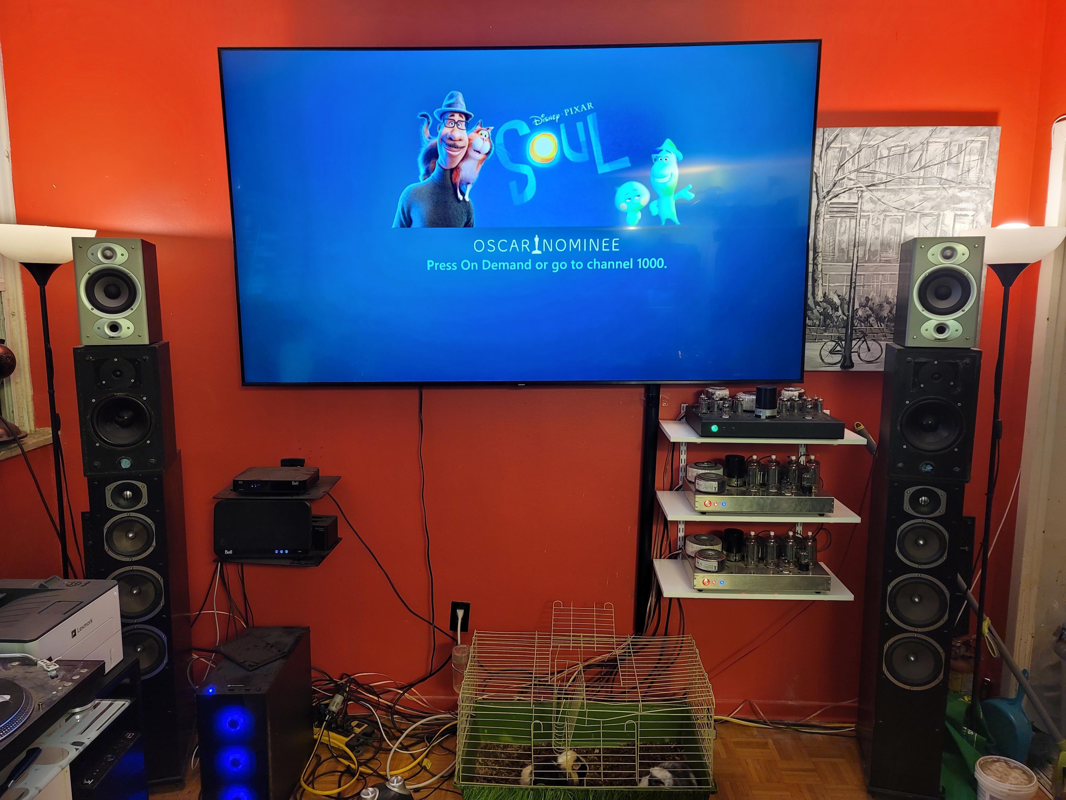

I moved the shelves with some of the amps (Stupendous on top, Monoblocs on the middle and bottom) after they fell off the wall! Apparently, the wall was thicker than I thought. It was fine until I bumped into it (pretty hard though) LOL
The relocation required a 100 foot spool of wire cut into 25 foot lengths.
If you count signal, there is now almost 75 feet of wire from preamp to speaker on those amplifiers now...
Also our Guinea pigs say "Hello!" :D

Also, I added two outputs to the back of my DAC/clock/input switch/bluetooth box, but the vibration took out the filament in one of the meters... No worry. 3 1/8" holes, and 3 white leds, and now I have blinding super meters! LOL
It's not as bad IRL though. The amp on top is using compactrons for the first time, too...
Also PYLE means PYLE of SH*T lol This tuner has less noise if I only rest the antenna lead near it instead of connecting it all of the way. The clock runs fast. I changed the LED dropping resistors. Before that, you could land a plane with it. Even for the 40$ I paid for it, it's trash.
