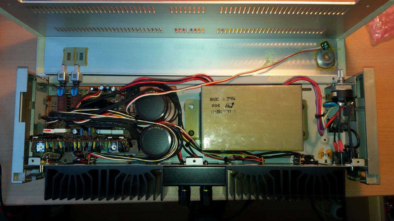

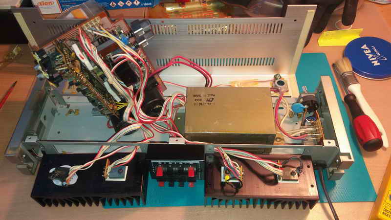

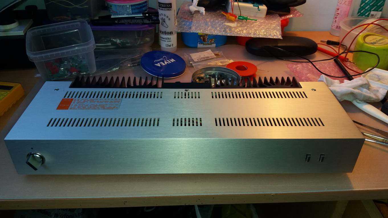

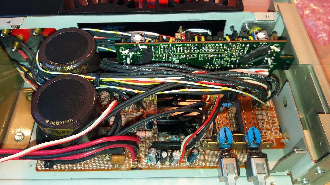

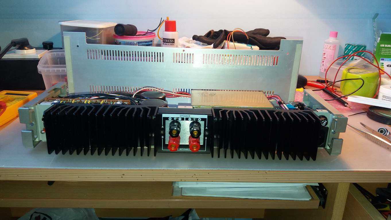

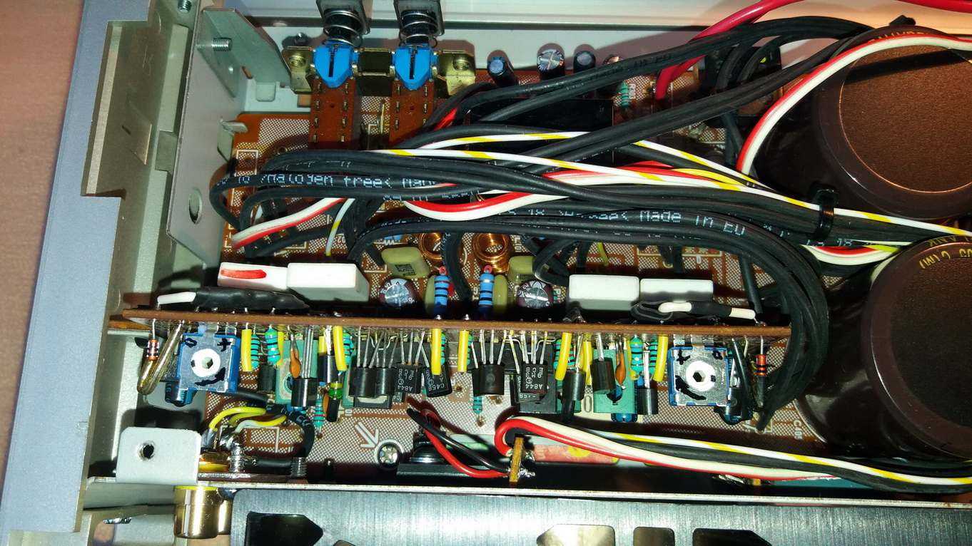

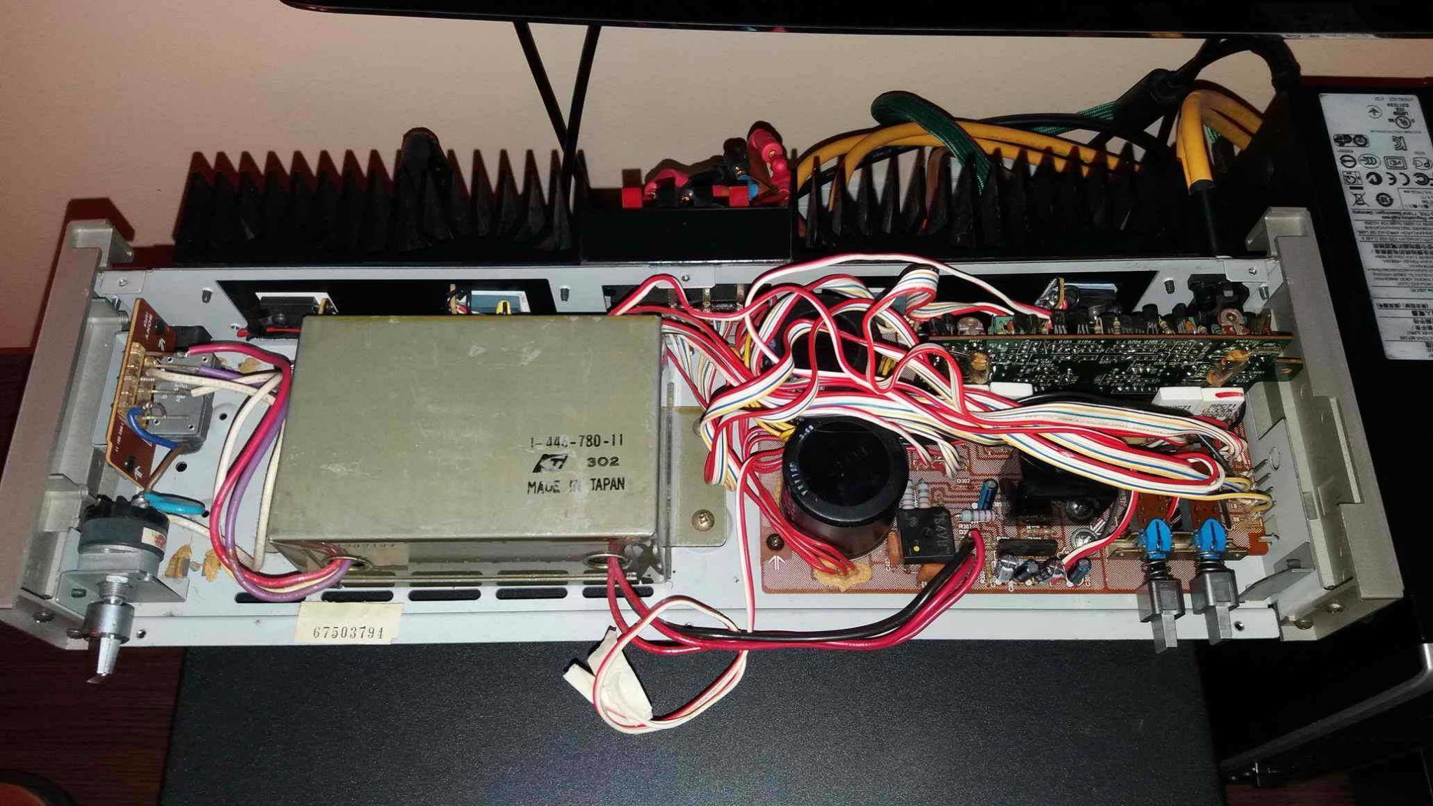

A couple of years ago, the Sony TAN-15F amplifier. Bought extra cheap as defective. One channel had a high DC voltage at the output, the other was OK. I repaired it first to hear if it was worth going further. The repair was not difficult, it was just bad solder joints. After listening, a general overhaul and modification was arranged. I replaced all electrolytic capacitors, resistors, speaker connectors and wired with VDH CS18. I bypassed the A/B switches, heavy nonsense that is. Also added an IEC connector and a safety GND. Very good quality little amplifier, for my sister and brother-in-law.

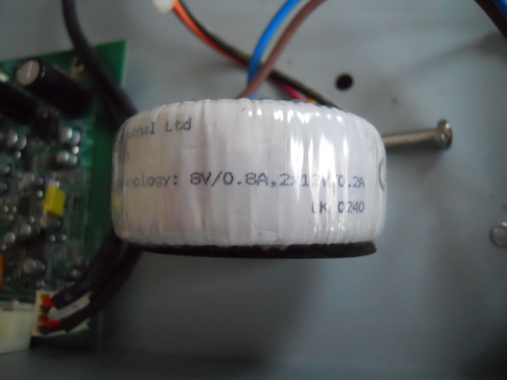

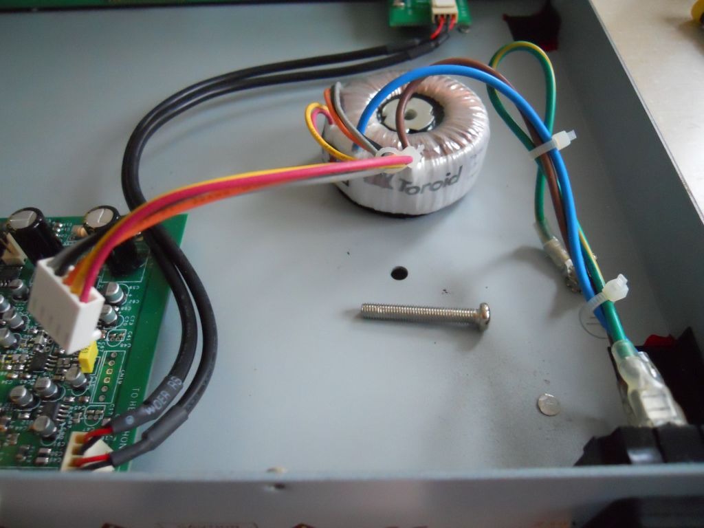

For the third time in less than two years my Pure DRX 701ES DAB tuner suffered yet another failure. This one is bad news, the small toroidal is kaput.
Wondered exactly what had happened, was listening to a CD and suddenly after hearing some relays drop out all was quiet. The amp was still powered but all my source components were 'dead'. These are all fed from a little wall mounted box behind the amp that has a single mains input and three relay switched mains outputs. The on/off command is via an optical feed from the amp.
Turns out the tuners transformer has some weird short internally. It not only blew the 100ma fuse of the tuner but also took out a 1.6 amp fuse in my little relay box.
The transformer primary reads around 180k (I know) and yet instantly pops a fuse with secondary unplugged. Lots of these tuners from the usual suspects with quite a few described as 'will not turn on'. Most faults are caps and diodes and regs. Given this is only DAB and many stations are now DAB+ I'm going to replace it with a new Rotel DAB/FM/Streamer, the Rotel T14.
