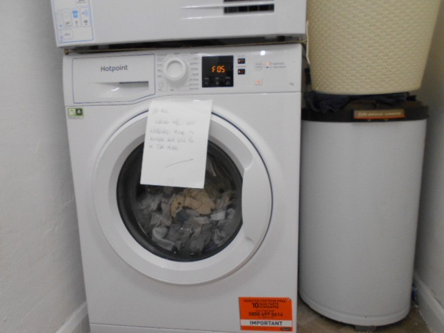

The Laundry saga gets worse. Only 6 hours after the landlord has fixed the Dryer, on passing I heard a strange humming noise coming from the washing machine on the deafening and unnecessarily high 1400 rpm spin cycle.
I didn't get involved because it wasn't my laundry. And it was house idiot Alan doing his wash.
But now I find he has broken it. I suspect he broke the dryer by overloading it too.

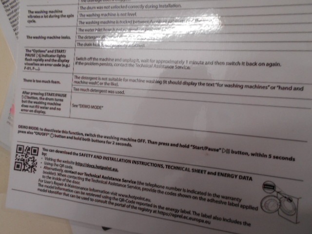

Lit up like a Christmas Tree and displaying F05 Error Code:
https://www.primerepair.co.uk/hotpoint-washing-machine-error-codes/
Means drum is not draning so probably a blockage. Usually small coins in the pipes which is why your mum always checked your trouser pockets for them when you were a kid.
Shouldn't be a hard fix for the landlord.

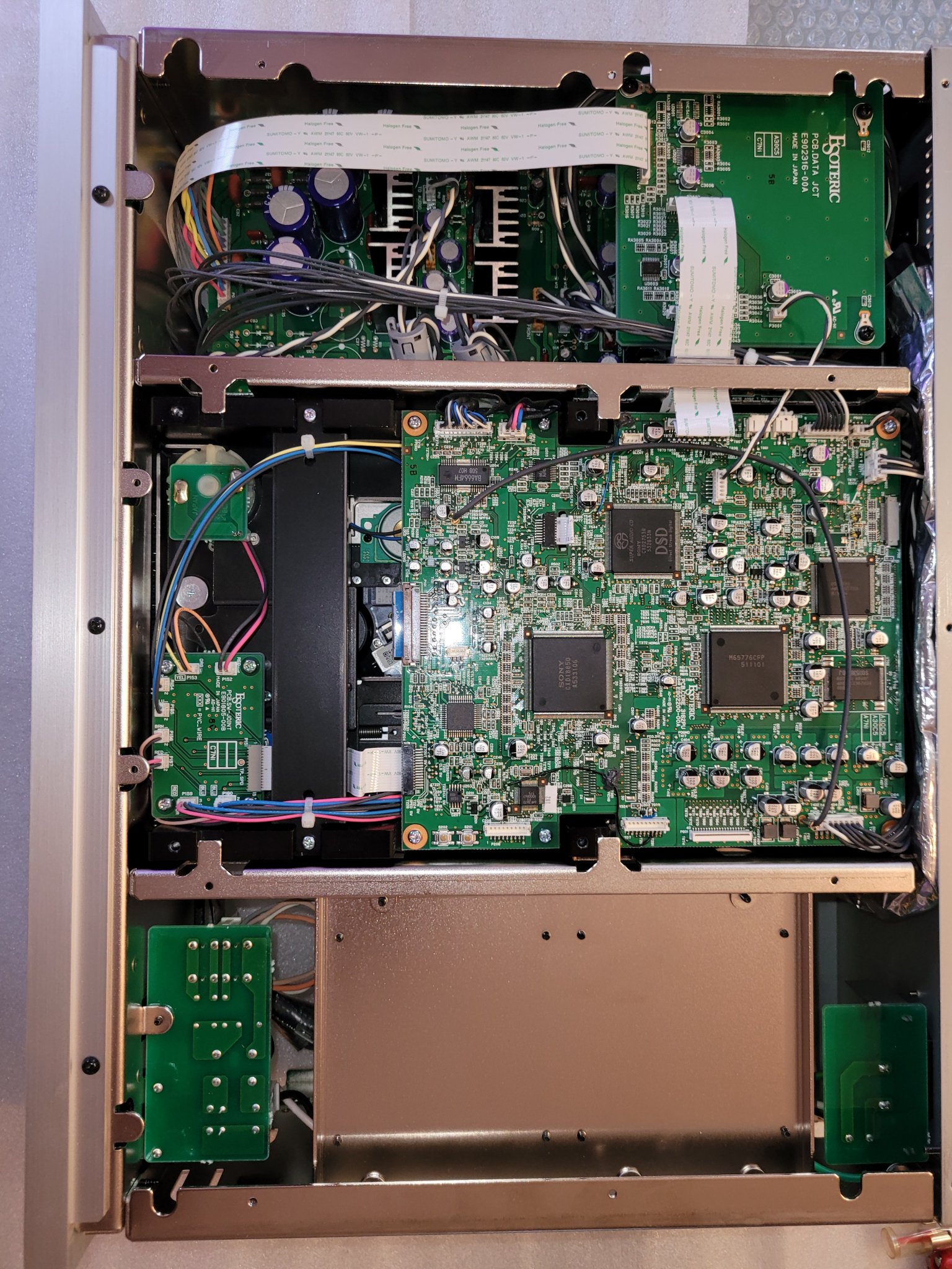

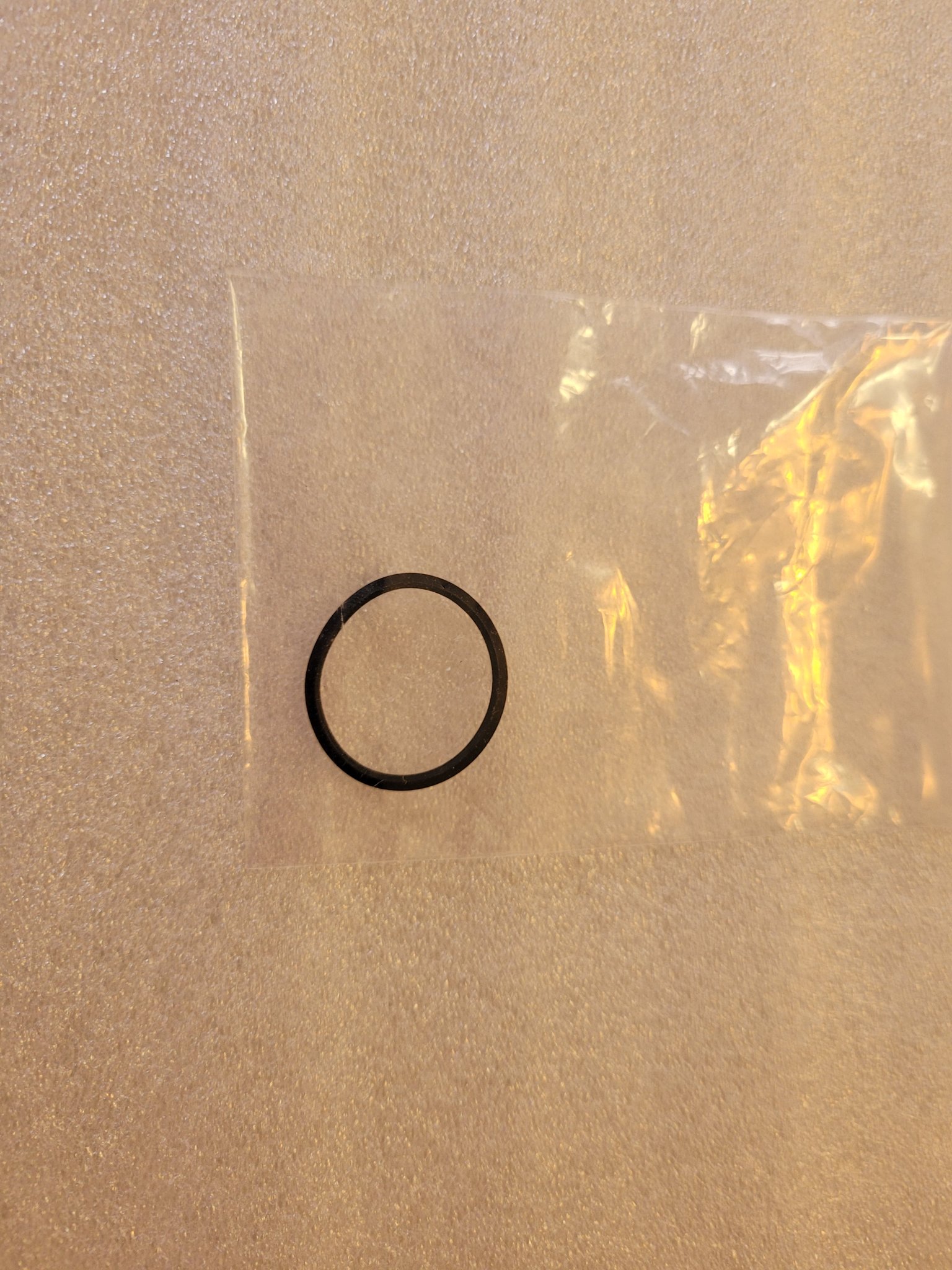

My Esoterix X03 Player why starting to fail opening the tray door... Cleaned and re-lubricated the door rails and replaced a 1$ belt, the belt that drive the opening mechanism, problem solved.
The belt is located under the large center PCB under the player. Image of the original belt showing that it is deformed and was slack in place. The new belt is just perfect. Bought it locally...

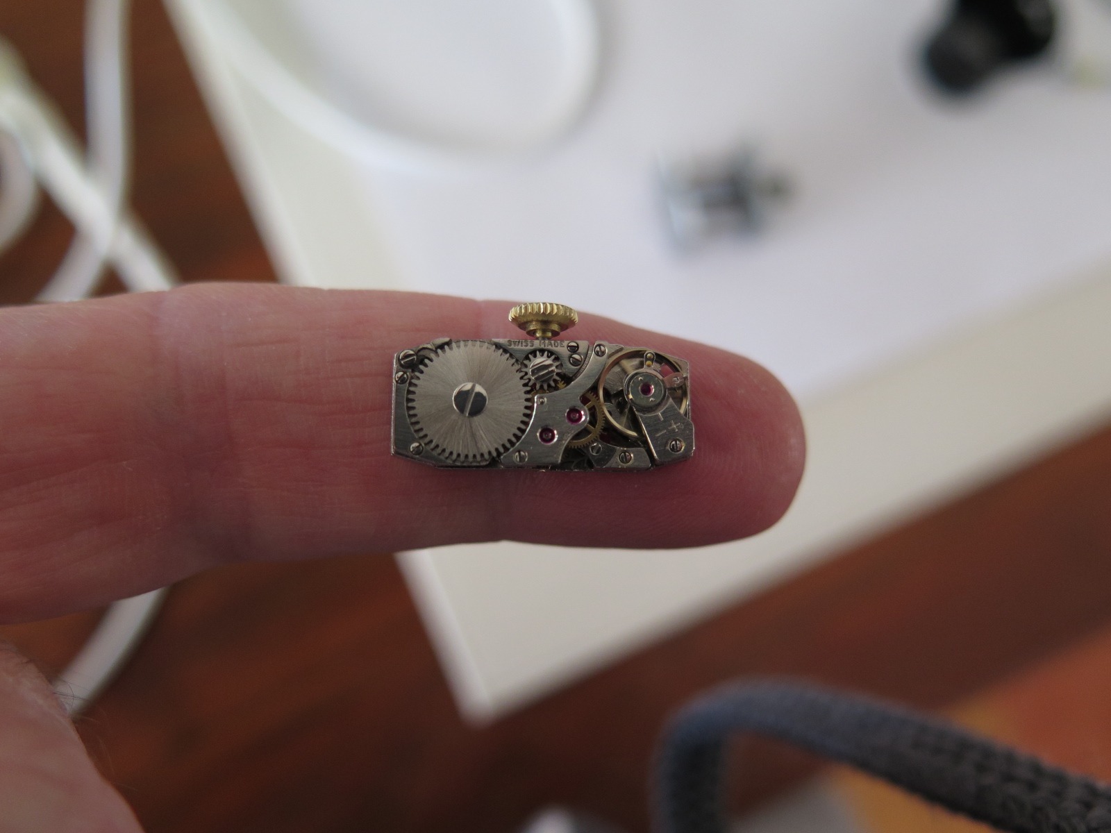

In line with the thread title, this is one I repaired earlier, a tiny Swiss ladies' watch (FHF59) that had a broken jewel on the balance from a shock. My mother in law's 21st birthday present resurrected. That's my index finger...you can see the balance is blurred as it is running after years sitting in a drawer.

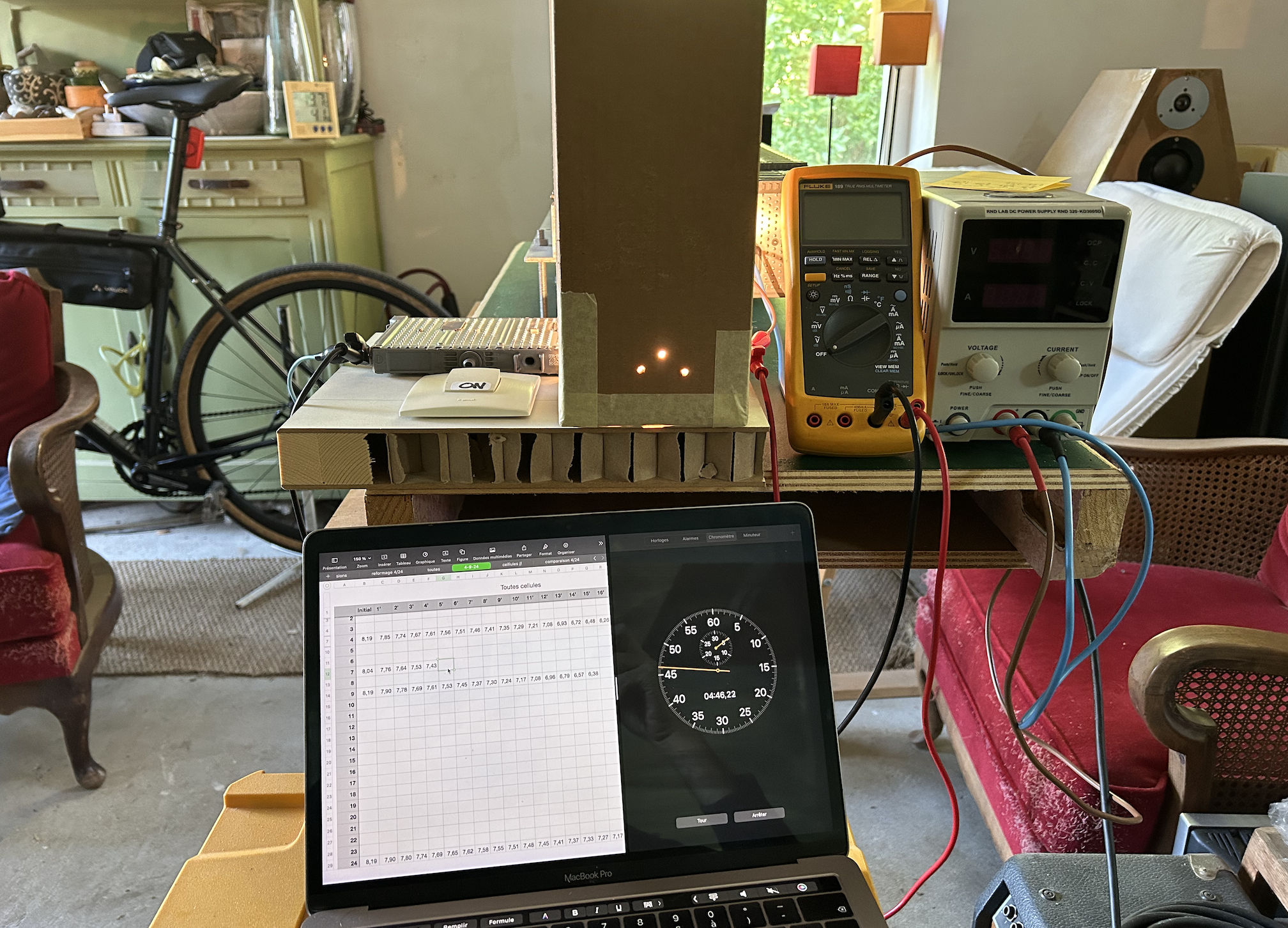

Fixed for the second time (last one?) my wife's 2005 Prius by replacing 3 cells in the HV battery. Much time to diagnose which cells to replace, which ones to keep, how to reassemble them and final balancing... but cheaper than going to Toyota for a full replacement. And more fun. Here's my little testing installation:
