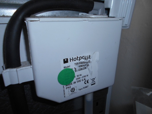

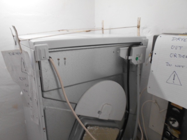

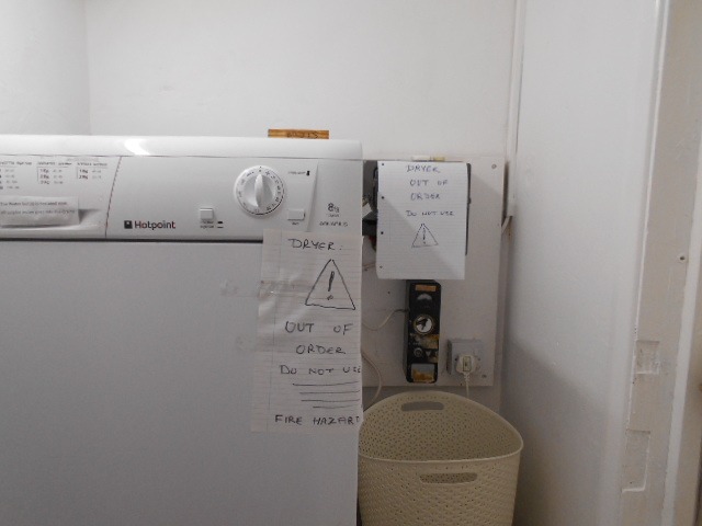

Being an extremely competent Chemist, having scored a Merit in the special paper, I beware Explosions in my Laboratory.
Thus it was that Maria was banging on my door:
"Steve", quoth she, "the Dryer is making unusual noises."
I quickly assessed the situation. Lot of smoke. Drum not rotating. Heater glowing red and menacingly. I quickly disconnected the Electric and removed all nearby inflammable materials.
Being unqualified as a working Electrician, all I could do was affix some warning notices and advise Maria to call in the Landlord.
Landlord was unable to fix it either. Looks like we must buy a new one.
At least nobody was hurt. I am a good man in a crisis. Only question remains: "Who designed this Incendiary Machine?"
Not me, that's for sure. 😎

IIRC, the motor which rotates the drum also drives a fan which pulls air over those coils, across the clothes, through the lint filter and out the exhaust. Combining the fan airflow function with that of rotating the drum makes sense in economy of design."Who designed this Incendiary Machine?"
The motor is dead or seized up. One would think it'd be replaceable. Or repairable, if you can get it to turn again and perhaps add a little lube to the bearings. A miserable lot in a life of service, those dryer motors; hot, dirty - nobody cares for your condition and the expectation is that you work basically forever! Well, sometimes they doth protesteth and say "forget it - no more!".
Machines of era 2005 to 2015 are known fire risk - excess fluff can come into contact with the heating element and present a risk of fire. The affected brands are Hotpoint, Indesit, Whirlpool and Creda!
There have been recalls -
"As part of a safety review, two types of tumble dryers been have identified as having a potential issue. Tumble dryers manufactured between April 2004 and September 2015 have been identified as being at risk.
More than 600 models of vented and condenser tumble dryers are affected, you can look up that unit's serial number and see.
My mum had the model directly after 2015, had some mods. Never trusted it!
@Speedysteve7 and @jjasniew. Good info there. Thank you. It is one of the affected dryers, but later manufacture it seems. TCM07580BP (UK)
Can't be more than three years old. And has a green sticker. Landlord is ordering a new motor.
Of course, everybody overloads the laundry machines. They often break down.
