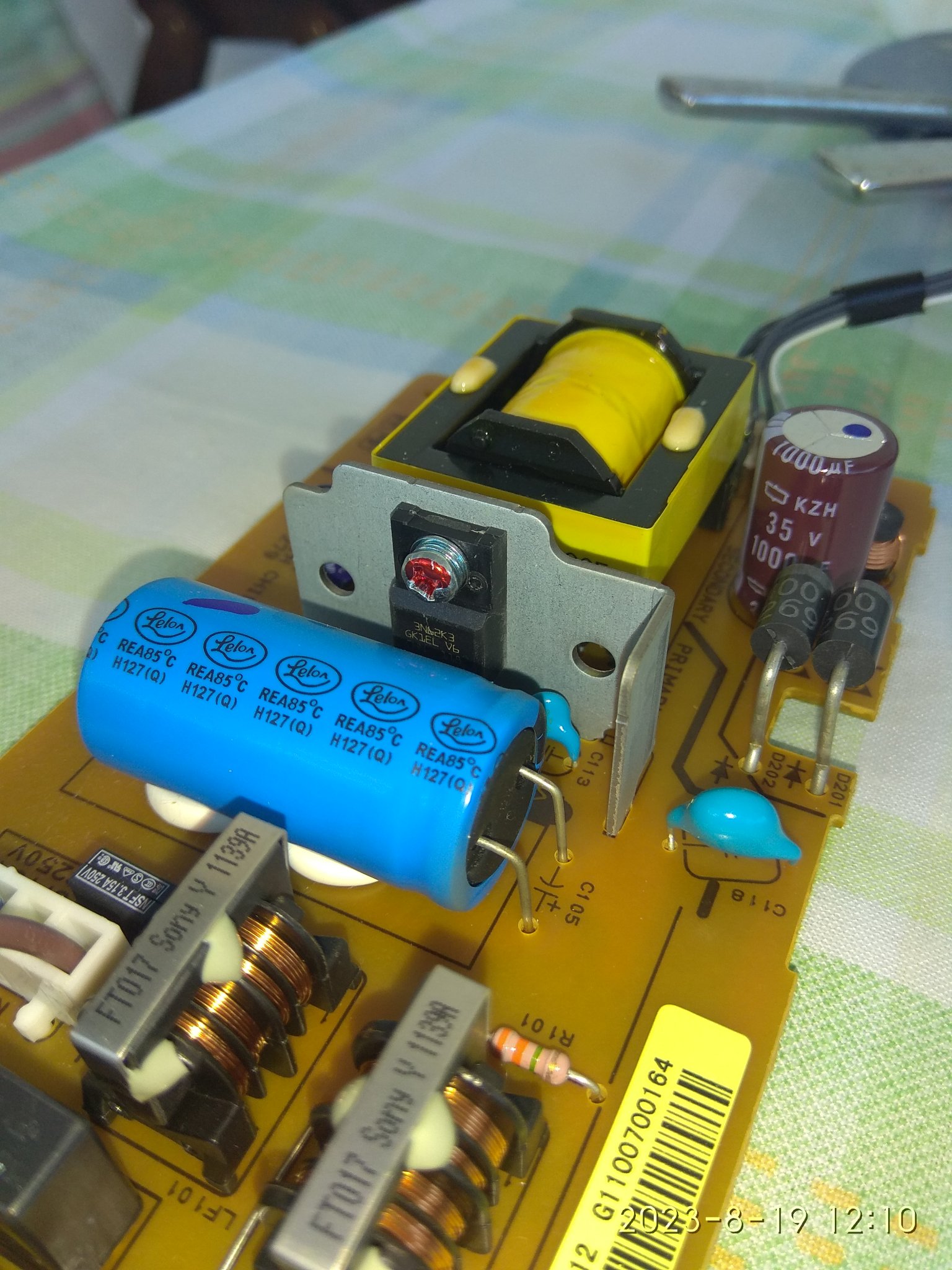

The Nippon KZH was always there? Because I wouldn't expect to see it on an SMPS that also uses a Lelon main capacitor. On the other hand it has a blue marker pen dot that looks like a factory check off. The Lelon REA has a blue dash mark.I last repair my Sony Blue Ray player.
Two parallel sotky rectifier diodes in 12v circuit.One of each was sorted.
D201.

Yes,the only part that i have replaced are two diodes,D201,D202.The Nippon KZH was always there? Because I wouldn't expect to see it on an SMPS that also uses a Lelon main capacitor. On the other hand it has a blue marker pen dot that looks like a factory check off. The Lelon REA has a blue dash mark.

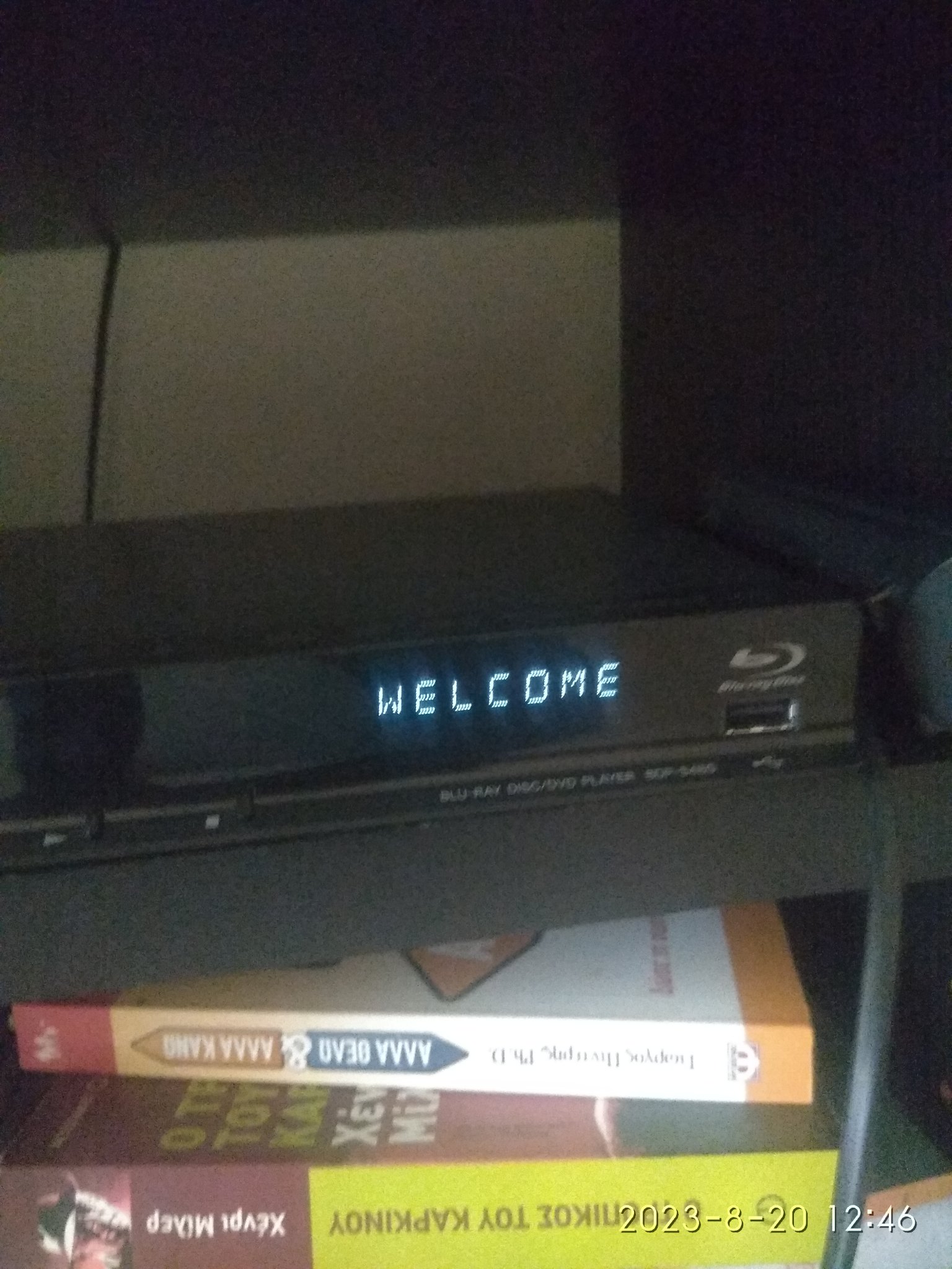

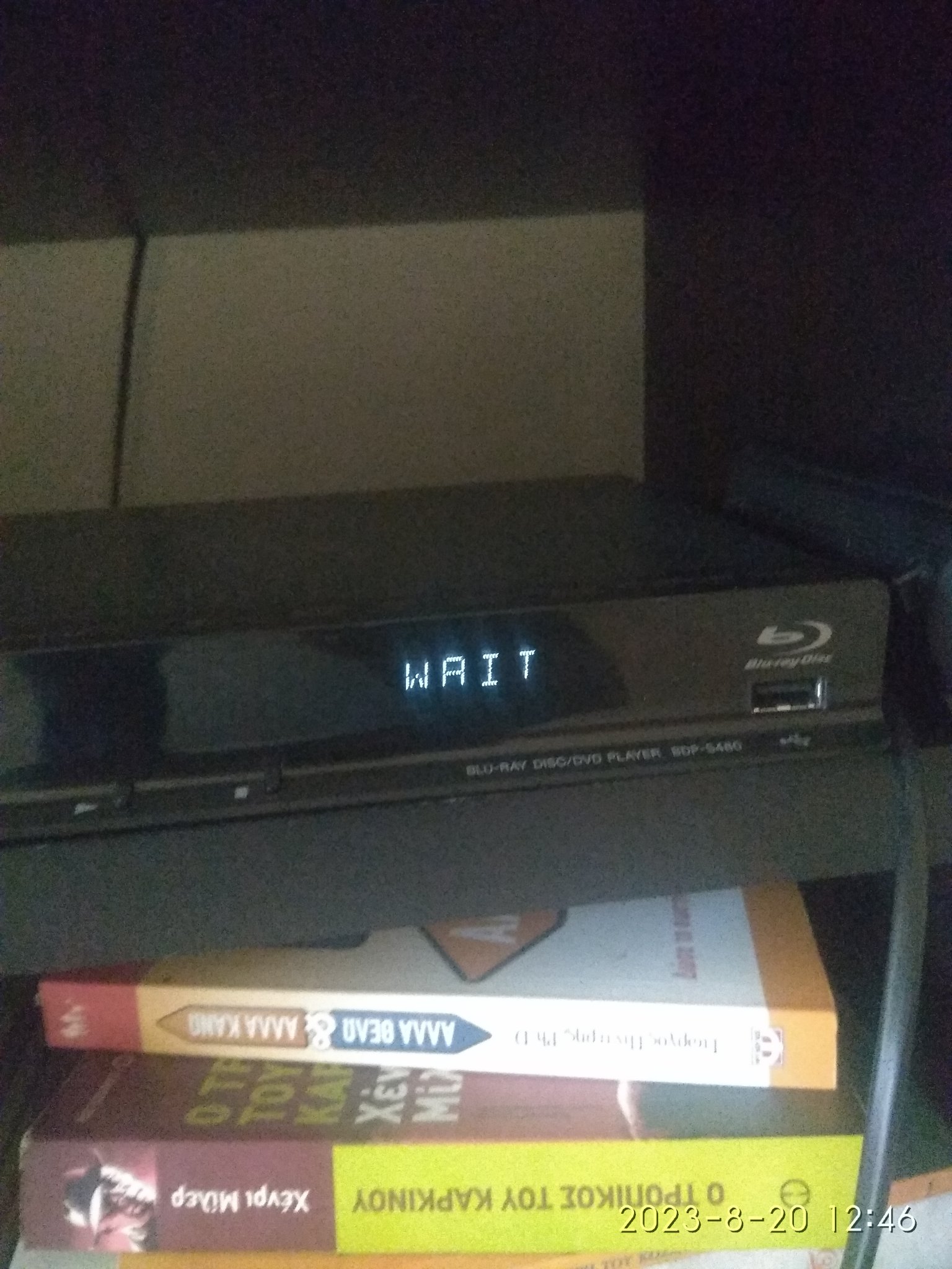

Big disappointment 😔 from this Sony player.
I have bought a long time ago,never used not in main connected,just dust collector.
Yesterday i have tried to use and this was death.
Electrolytic capacitors deformed due to have not seen voltage for years in that Sony and they acted up ugly on first power on as it seems.
A hint on how to slowly energize SMPS capacitors after a long storage would be useful.
Variac works on transformer based supplies, here in SMPS the controller would try to correct the output.
Variac would not apply in this occasion. Only if taken out and reformed. Maybe a dim bulb tester could have saved the initial surge though.

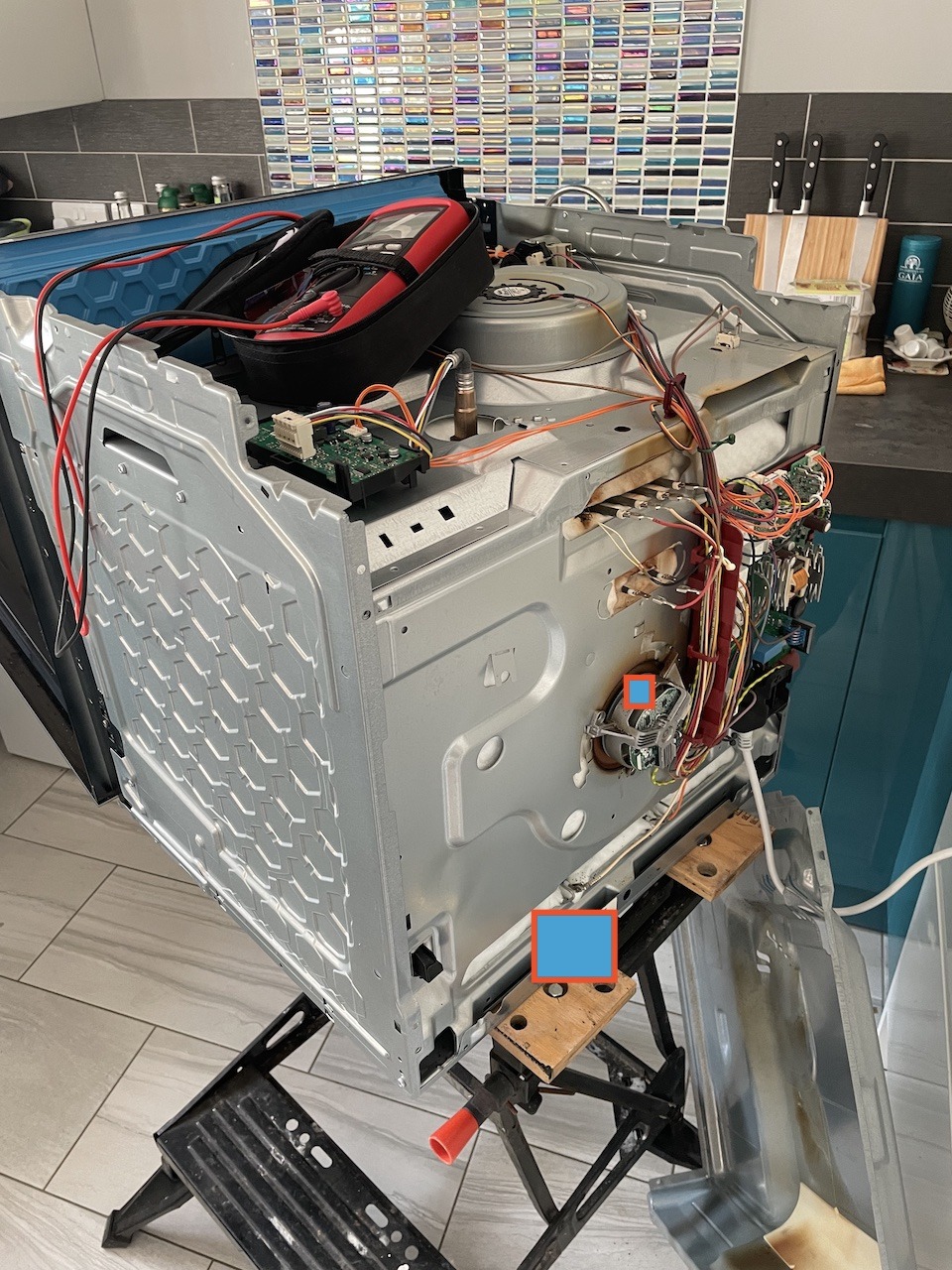

When I've replaced elements I've found they are accessible from the front (stick your head in the oven 😉) after removing an internal rear panel in the oven cavity that is over the element and fan. Usually enough free wire to pull through and get hold off.

Not in the Bosch series 8... it's screwed in through the wall from the back. You need access to remove those two screws that hold the element itself. Some awesome forward support planning from development engineering there.When I've replaced elements I've found they are accessible from the front (stick your head in the oven 😉) after removing an internal rear panel in the oven cavity that is over the element and fan. Usually enough free wire to pull through and get hold off.
