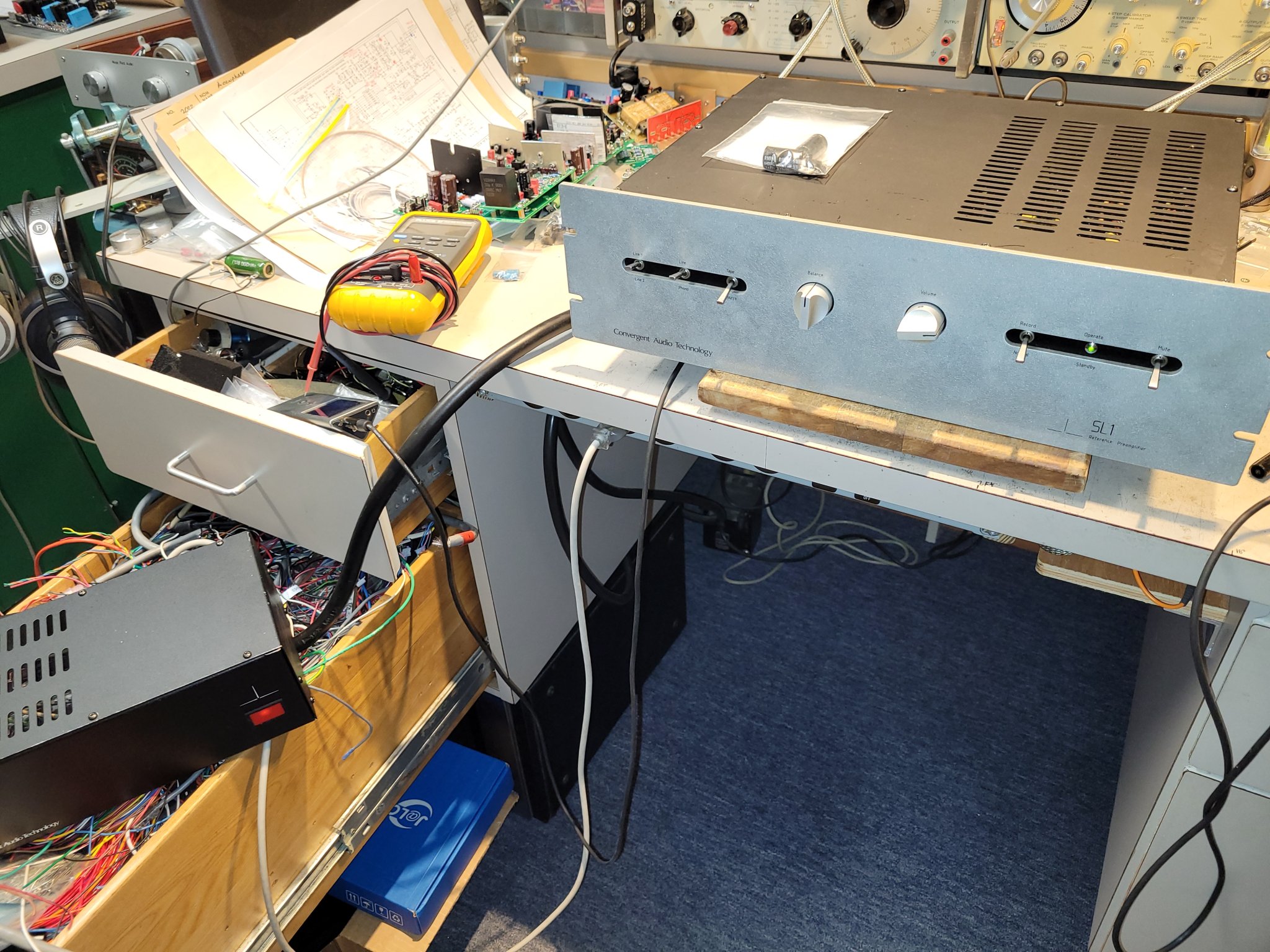

Repaired an other original SL1, that’s the one with the HV burned secondary. Replaced the power transformer, replaced all the HV regs shorted parts, included one of the four HV rectifier diodes. Then moved to the preamp, using a lab power supply checked the HV input, there was a very low 50 ohms resistance, a blown resistor, and soark mark on the main board. Replaced the resistor, remove the caps where that was a spark. Normally the HV section is about 40-50ma, using my lab supply i increased the supply current, it kept ramping up to 150ma, i could see the pcb substrate burning near one of the input HV cap pad. The original problem was that the pcb pad sparked and shorted to gnd ground plane.
Cleaned thoroughly the pcb substrate around the capacitor pad, added epoxy and insulation tape to restore the pcb insulation. Replaced both HV input caps to be sure, restarted the preamp with the power supply, everything is fine now, playing beautiful music…

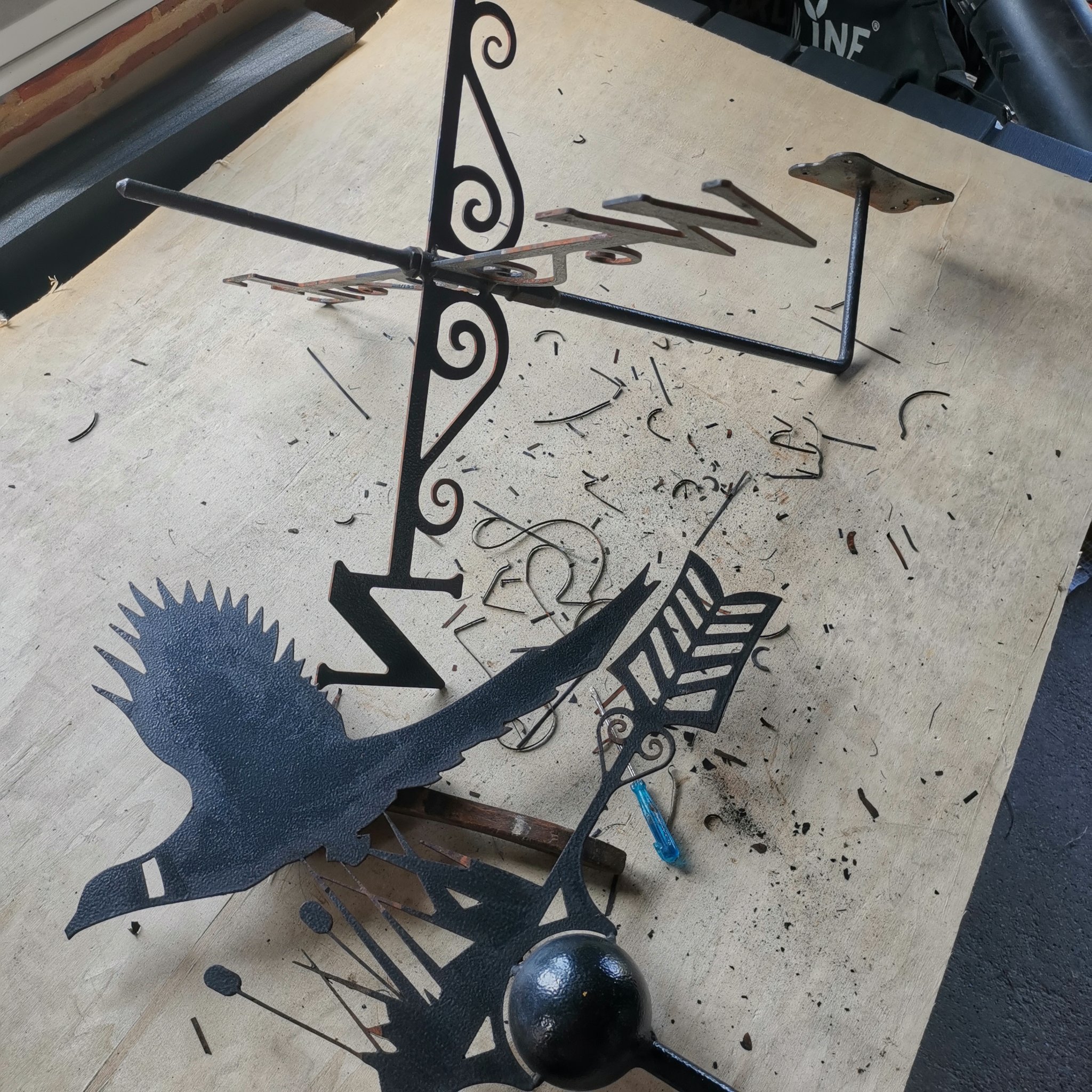

Only a little one.
A weathervane only 2 years old.
As with much of this stuff they insist on powdercoat.
Outdoor items, direct into steel - powdercoat hopeless!
It looks nice in store - utterly useless!
Just flakes off.
Once scraped off and wire rushed, I used Tetrosyl - SCS010.
Don't expect to be doing that again soon.
I remember the underside of my Caterham 7 racecar🙄
They'd powdercoated all the chassis and suspension.
Hopeless. All flaking off.
Waxolyed the inaccessible bits, POR-15 on the non UV exposed bits. Tetrosyl on the rest.
