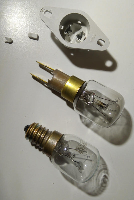

The microwave oven lighting gave up a while ago and so found today the incentive to pop the hood, and found this piece of "proprietary" bulb... below for comparison an ordinary E14 socket oven/refrigerator bulb I was hoping for to replace with, I am going to just solder the leads directly onto the socket and add some proper isolation, drop it back and call it a day.
hah, my worries was rather on a LED in that environment although the mw head should be pretty tight on its own, I will try one just for fun when I get to it.
You could check up, and get a special quartz glass bulb if needed.
Halogen bulbs are quartz bulbs, if that helps...
It’s fun to throw LEDs or NE2’s inside the microwave…..hah, my worries was rather on a LED in that environment although the mw head should be pretty tight on its own, I will try one just for fun when I get to it.

I replaced my Sharp microwave incandescent bulb with an ordinary Osram LED bulb a few years ago and it's been fine. I just soldered wires onto the LED terminals/connections and made it fit. As a bonus it's brighter and operates cooler. I was already pulling it apart as it wasn't heating, so I replaced the HV diode and fuse.
The original bulbs broke regularly. I figured it was because of the shock of the door closing as the bulb is situated at the front of the unit near the door, so when the filament is white hot and you push the door shut, it breaks due to the design of these doors - having no shock absorbing materials.

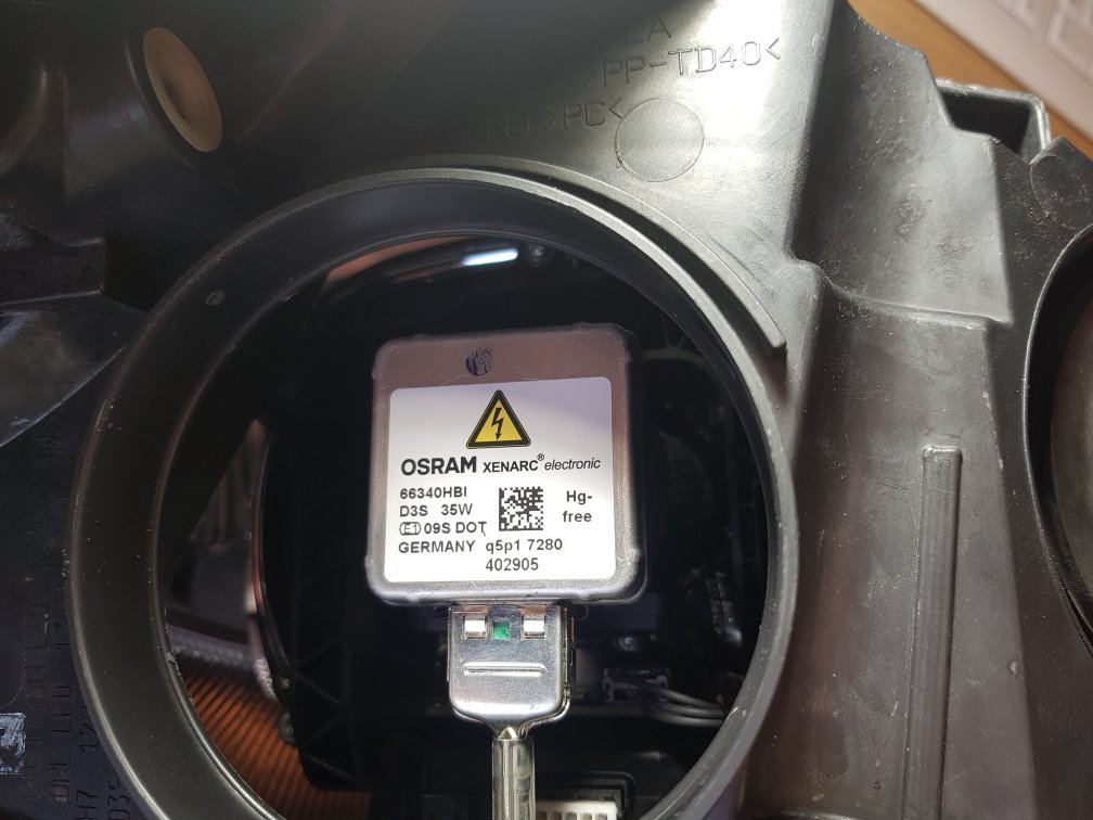

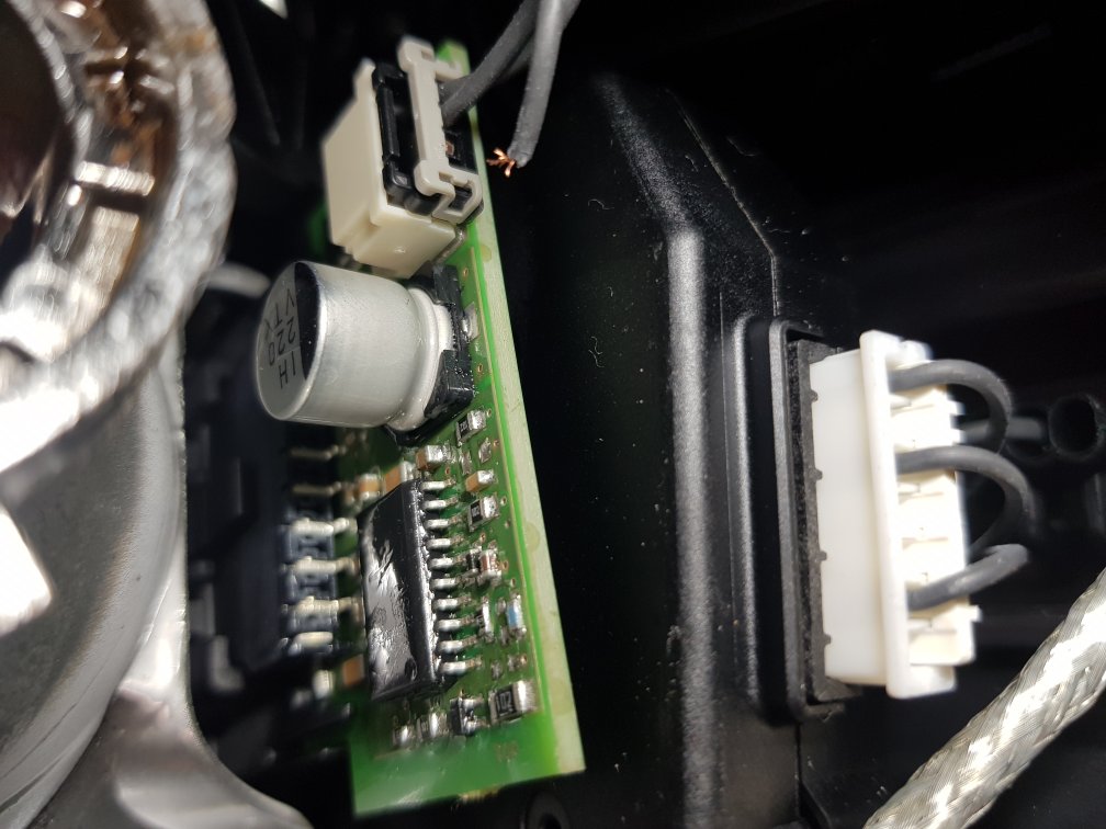

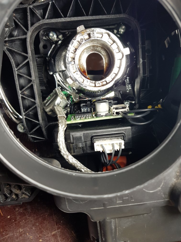

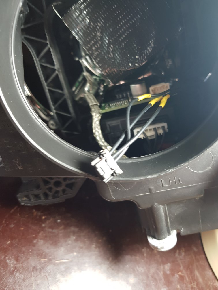

Fixed my adaptive headlights on my car. Ford don't repair them, they just want to charge upwards of 900GBP for a new one.
A bit of googling reveals that there is a very common problem with these: a loom connecting the moving bit and still bit breaks. Cracked the headlamp assembly open, and sure enough, a broken wire at the connector.
Fortunately, this is common enough that some enterprising souls offer a repair loom with the correct connector to repair it. So twenty quid later, I grafted in said repair loom. Reassembled it, refitted it, tested it: all good again. (Actually, the repair loom is a tenner. But I bought two of them; if one side has packed up the other side cannot be far behind.)
Now: What to do with the 880GBP I saved.....
