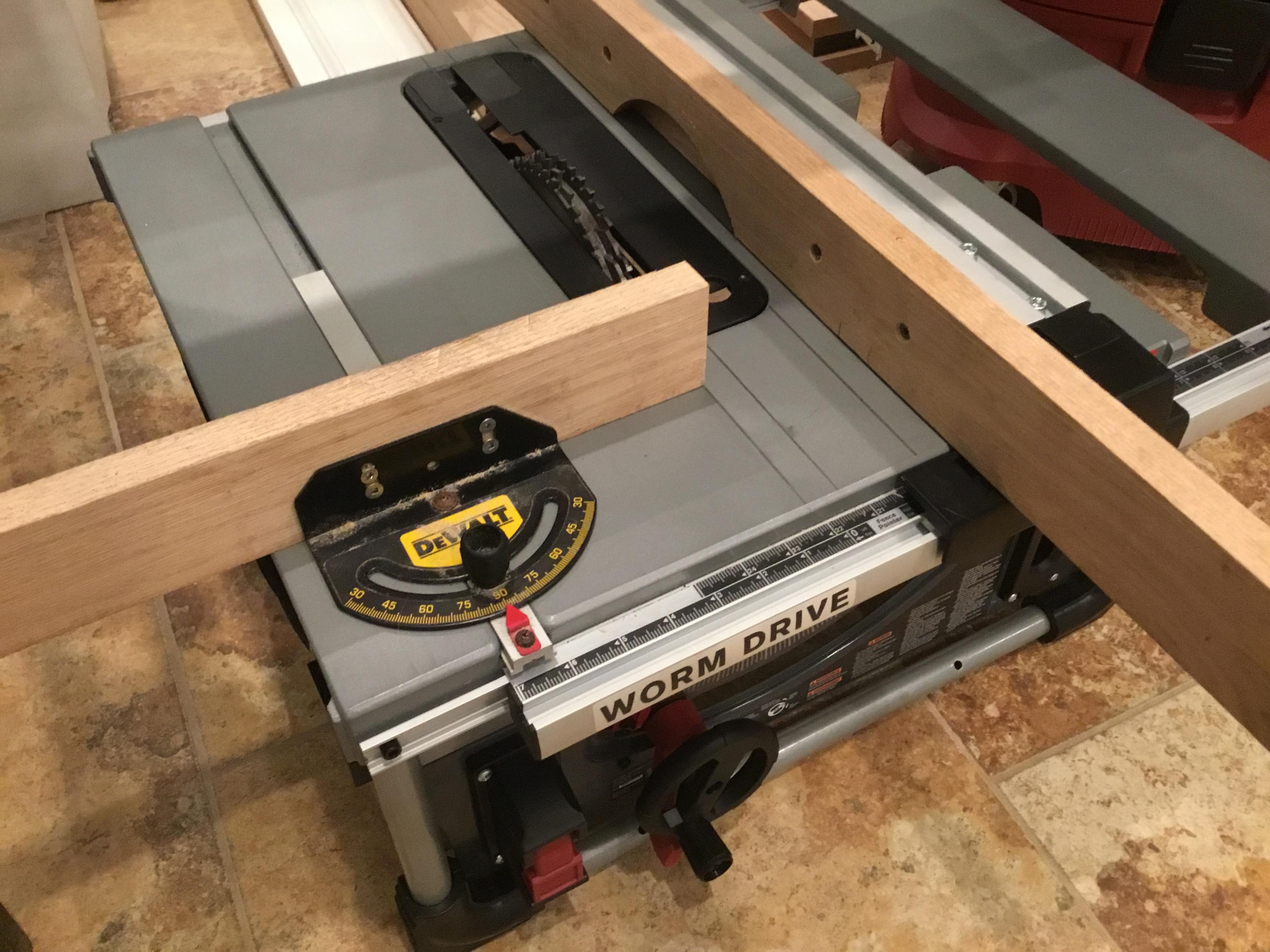

a 3/4” dado stack.
Is that saw capable of doing that, or do you just run it a wee each pass?
Amazingly it produces 5 peak hp and the gear drive gives it enough torque to power through a complete cut.
It was only equipped to handle a 1/2” stack but a little surgery and it’s good to go with 3/4”
