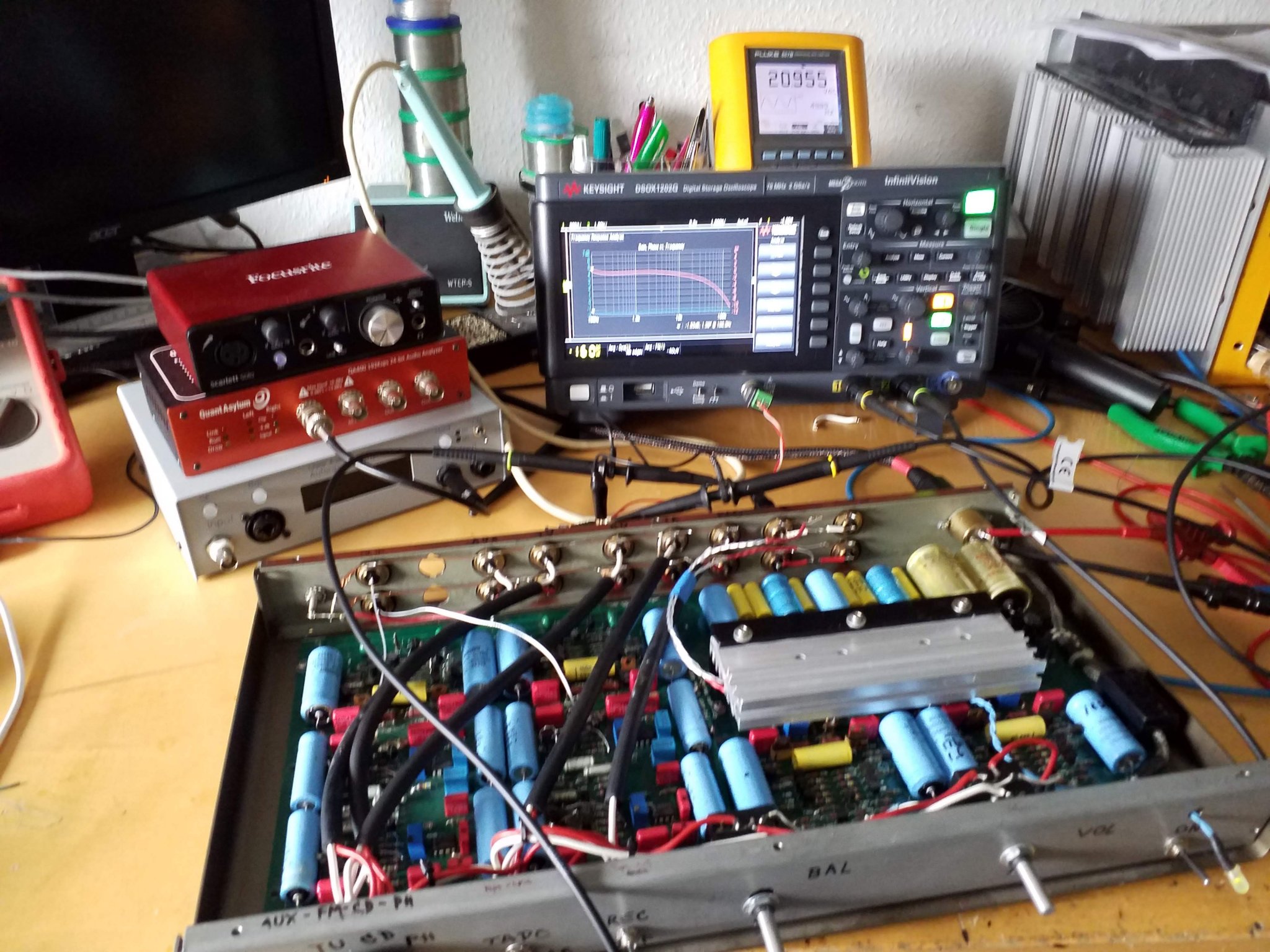

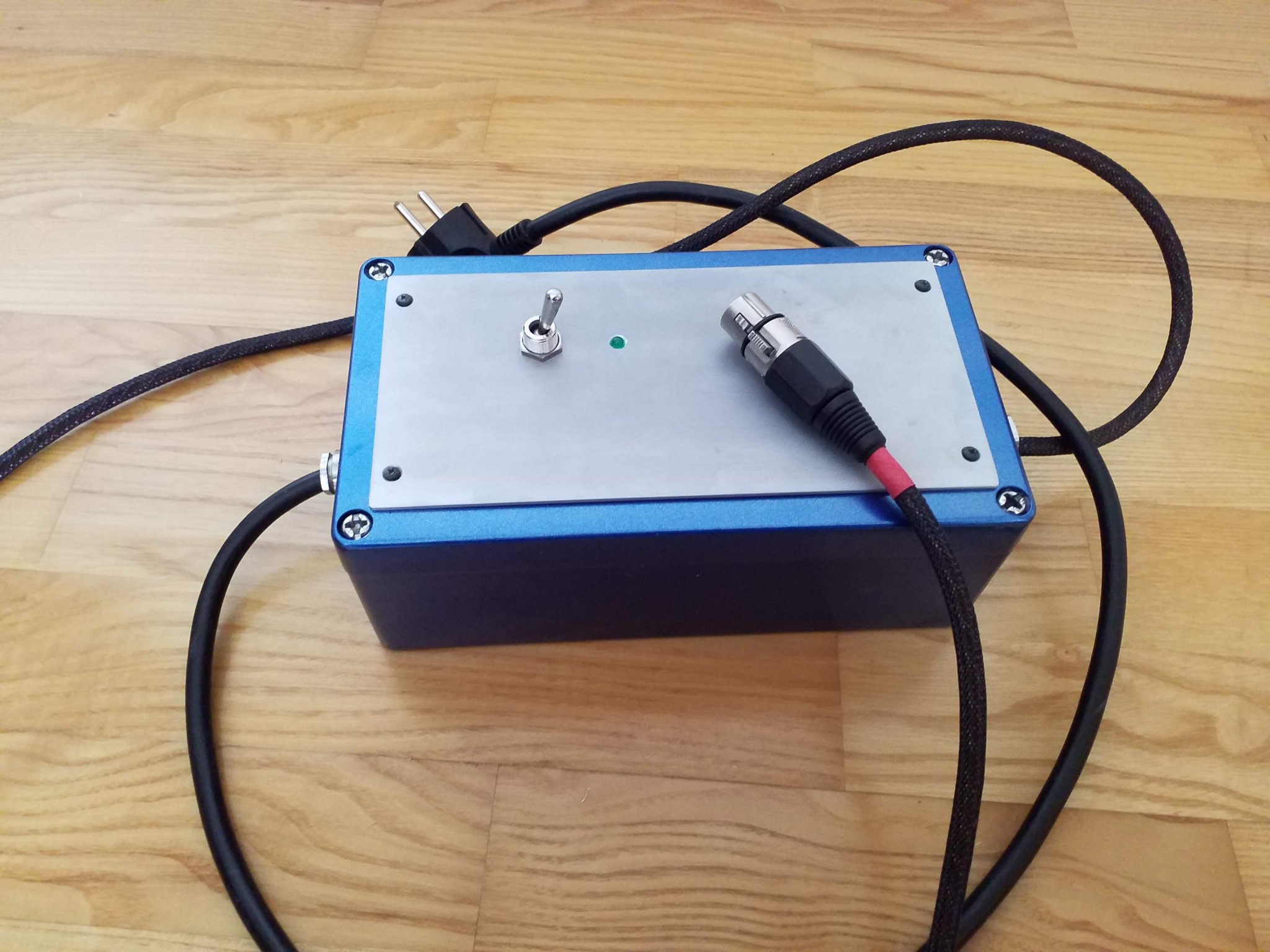

A guy approached me asking to fix his late 80s preamp, he bought it used with no clue to its function, power supply was missing, so I build a new one, external with xlr connector.
Relays didn't click either, and some resistors near power regulators were blackened, it ran very high class a on output, so I reduced it a bit.
Capacitors should have been changed, but it would take huge amounts of time, finding axial ones and replace them all, it performed nicely, so the guy left it as is..

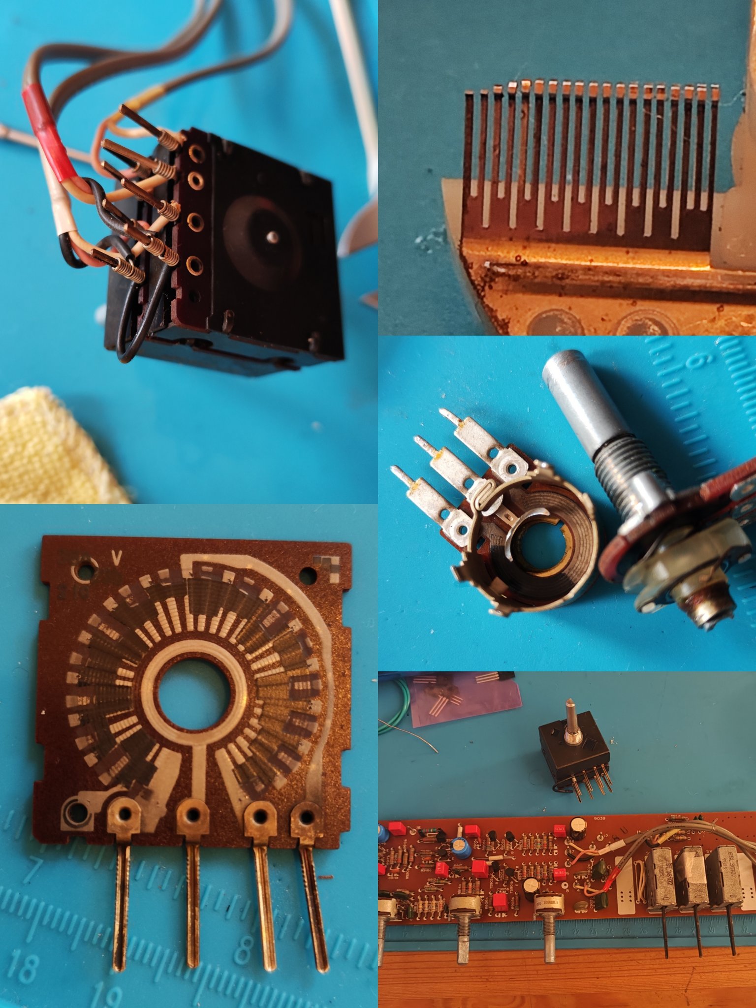

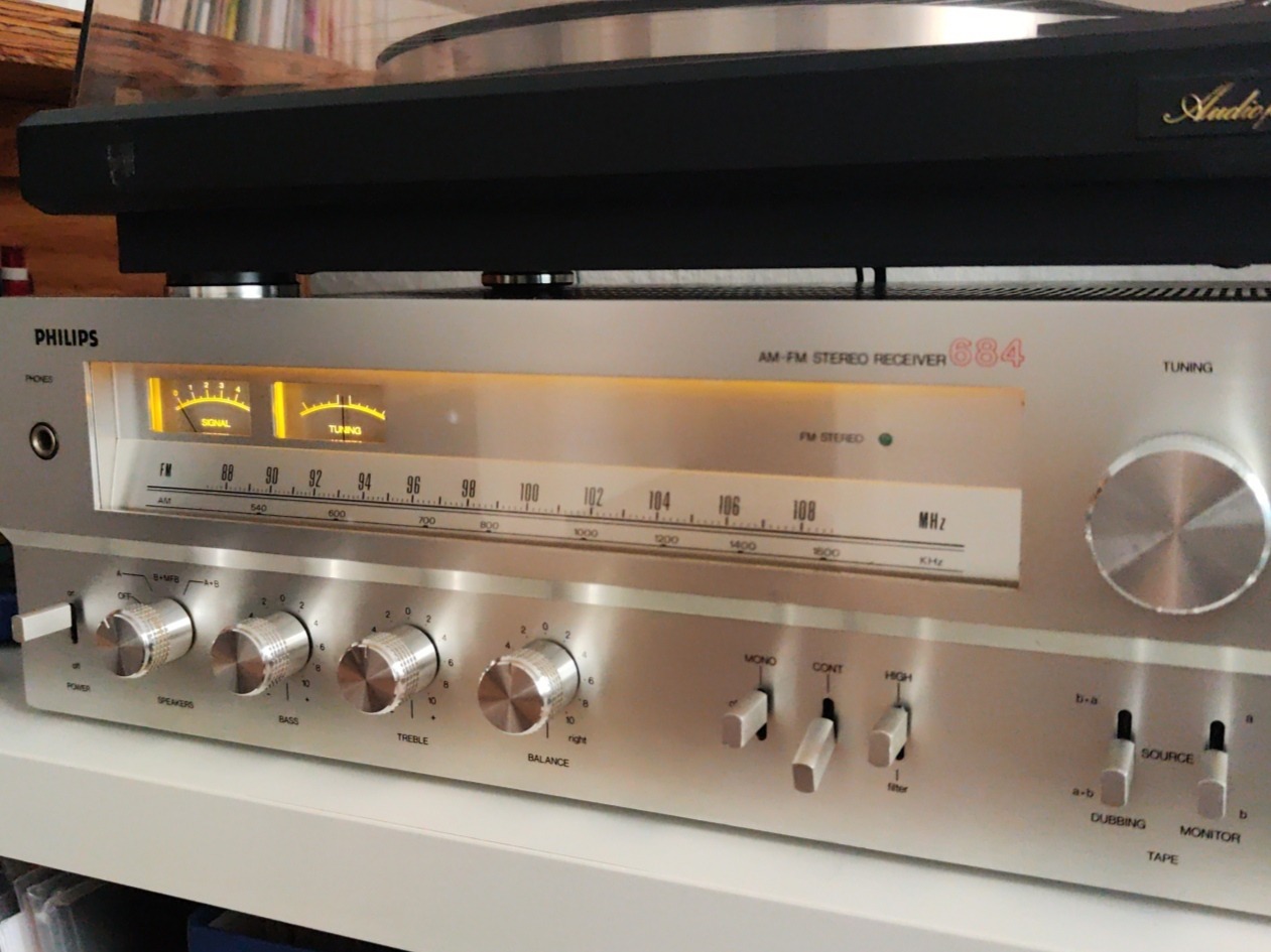

I guess fixing old pots of my friends amplifiers is my new hobby.. A friend of mine loves his old Philips AH684 receiver / amplifier, but had nasty crackling pots and switches.. I wanted to discard the volume control for a new one, but it has a special section for the loudness function to work properly.. So I cleaned it and snipped away the worn parts of the poti brushes.. Surprisingly it works very smooth now, looking at the worn carbon tracks I did not anticipate this..

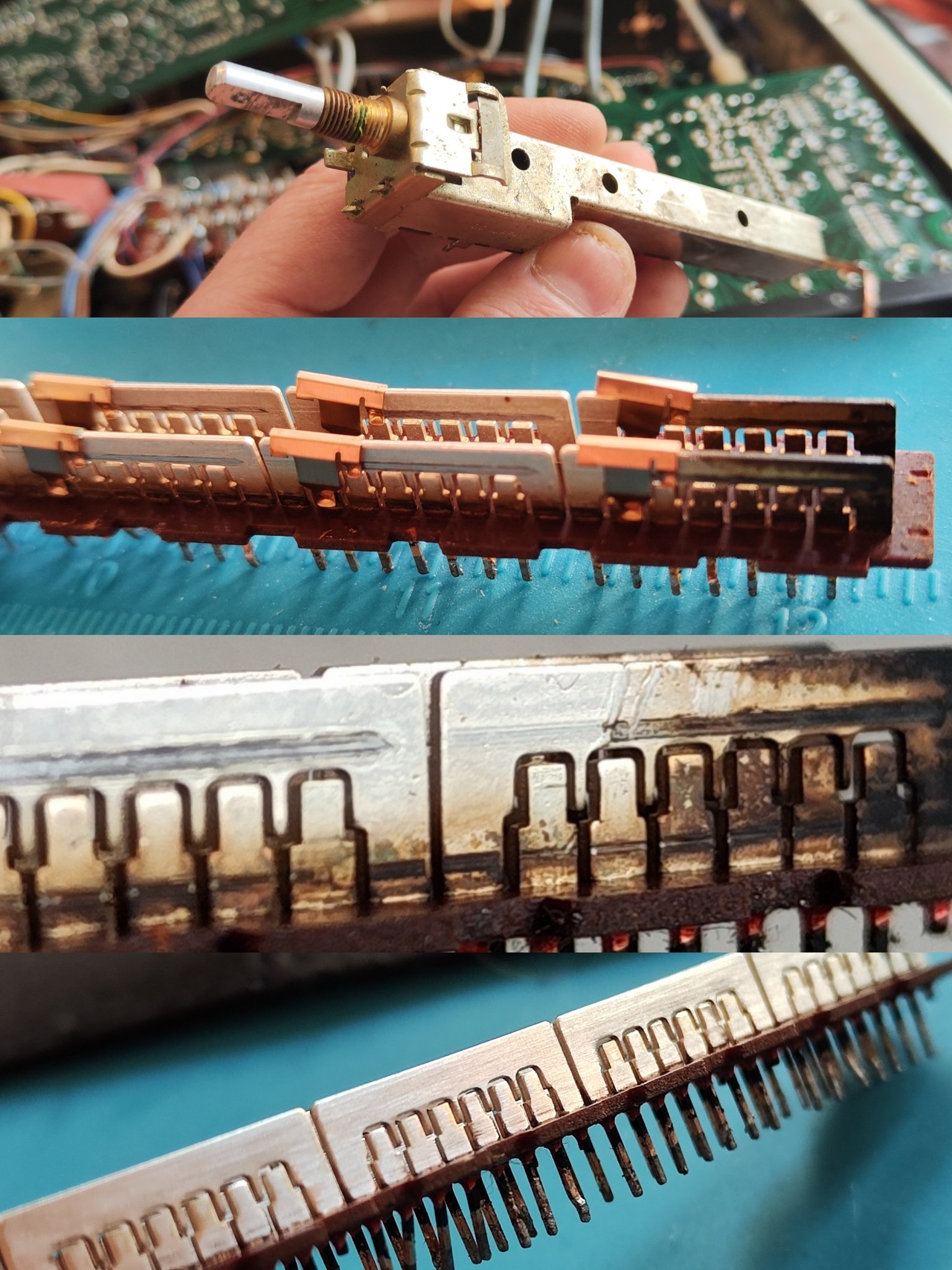

The Input selector switch looked extra nasty.. It doesn't only switch input signals but also the supply voltages for the AM / FM Radio part. Maybe that's why the contacts looked so burned?
After reassembling the tone control board and input selector I realised that there was a unwanted DC voltage on the right input channel. It took a while to realise that it came from the radio PCB through the input selector. I wasn't smart enough to figure out why the radio part injected the DC voltage. But my friend doesn't use the radio part of the amplifier, so I just disconnected the supply rails of the radio PCB and the DC voltage went away.
I also checked the fourty years old PSU filter caps and they measured perfect, so I left them alone. To my surprise the loudspeaker relais still works like a charm.. After that I replaced the defective light bulbs with some warm white LEDs. Now I hope that my friend can enjoy his old amp for some more years..
Maybe someone of you can help me with my last question regarding this project: Philips AH684 - bias adjustment - can't find the test points..

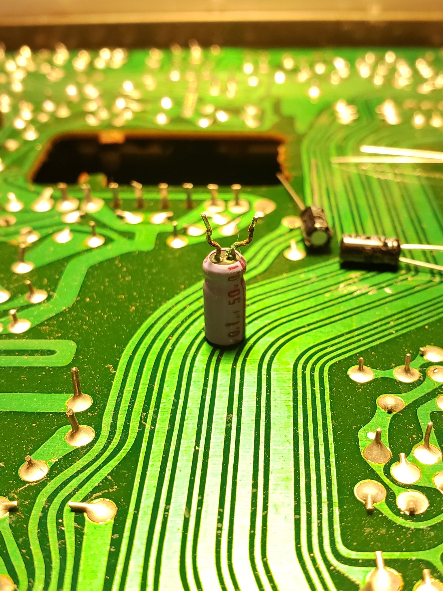

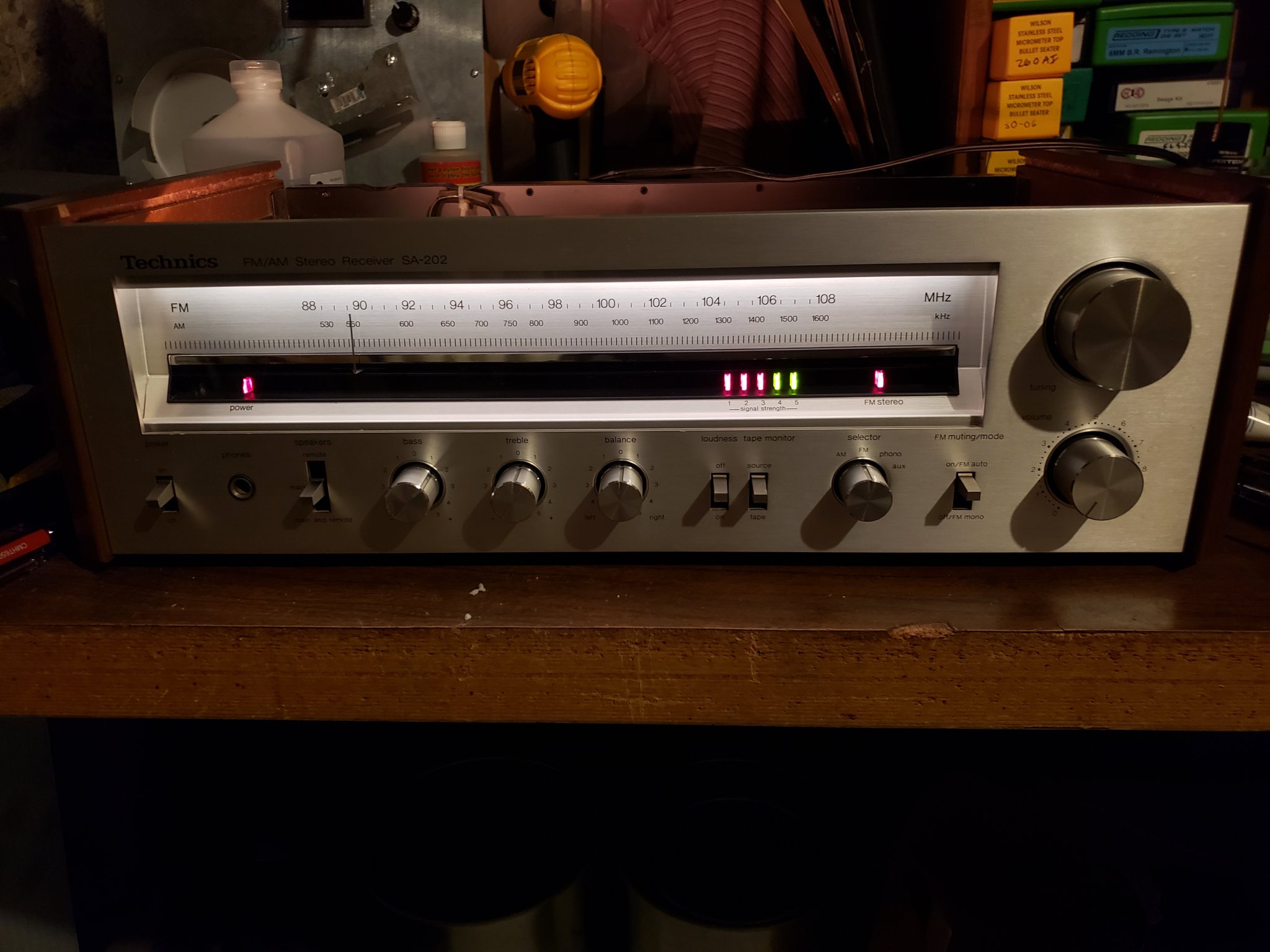

Aside from building myself new RCA interconnects of minimum length to clean up the mess this weekend, last thing I worked on was a Technics SA-202 I ended up putting into a mini system as a gift for some friends. Lots of leaky caps got replaced, new lamps, thorough cleaning and all is well again. Paired it a pair of Infinity RS10 book shelf speakers and an AT LP60 turntable for them. Their previous set up was a Crosley suitcase turntable. The fully automatic TT was a specific requirement as my friend has CP affecting her hands mostly, so she was unable to play records on her own without damaging the stylus or record. She now can play them just fine.

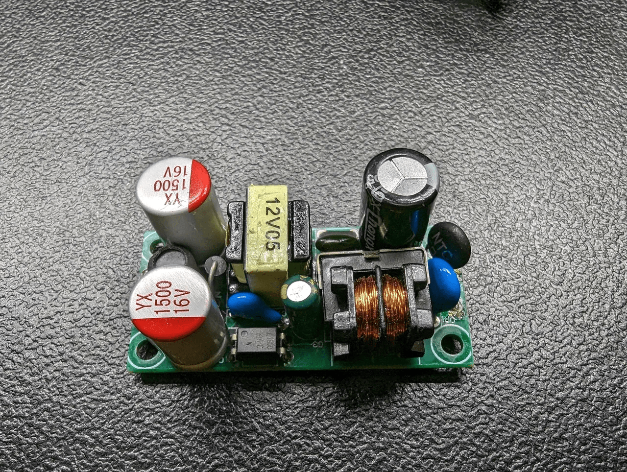

Today, after almost 4 years of 24/7 operation, the 3$ 12V500mA SMPS that powers my Nixie clock and touch power relay board called it quits while I was in the shower.
Turned on for ~5 seconds, died, lather, rinse, repeat.
I considered repairing it, but I don't have the caps that are probably bad, and they would cost more than a new one anyway.
Swapped it and all is working again.

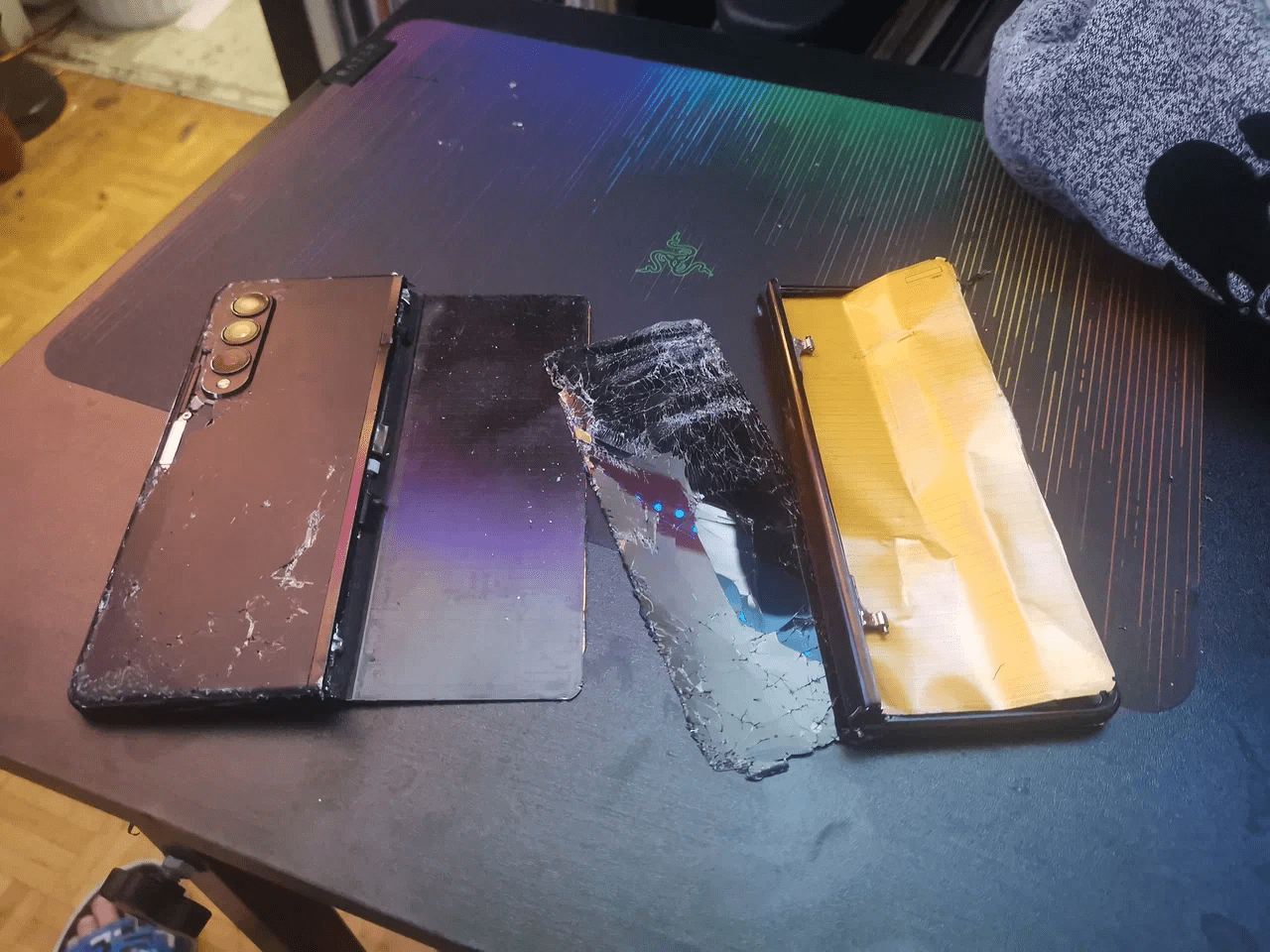

I've had several Samsung phones - most with the S-pen but my latest experience with the Fold 3 made me swear not to buy another Samsung again. Not only did it break, it ANGERED me to the point that this is what it looked like when I finished with it, but before I threw it away (and I'm still paying for the effing thing):

So that little SMPS I posted about - I ended up finding caps that I could fit... The original 6.8µF/400V is now 10µF/450V, and the two 470µF/25V caps are now 1500µF/16V. And it works again 🙂 but only after I installed the first 10µ cap backwards and watched it vent when I plugged it in lol
I didn't change C3

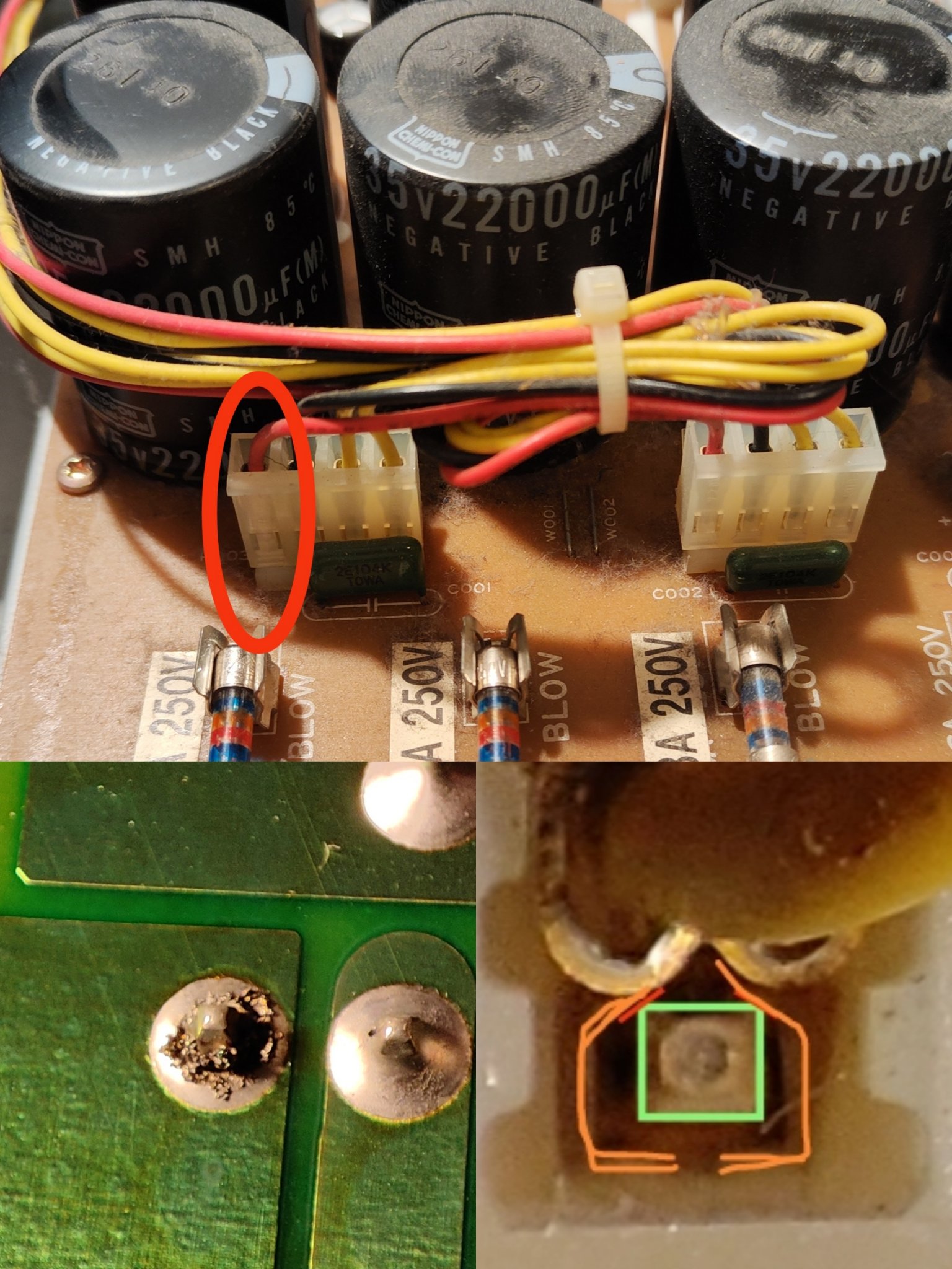

A friend of mine asked me to check the power supply unit of his Tascam M-3700 Studio mixing console. The PSU provides multiple voltages to the console, +/-15V for all the OpAmps, +48V for the mic phantom power and +5V, +8V, +12V for different purposes like VU meter background lights and so on.
The +/-15V channel was not working and initially I thought that the M5230 voltage regulator IC might have failed.
I spent a lot of time measuring voltages and trying to understand what failed. I checked the power transistors and the bridge rectifier. After I looked at the PCB from the solder side I realised there was a bad solder joint on one of the pins of the connector where the bridge rectifier plugs in.
After inspecting the connector I think that the contact surface is way too small by design and 20 years of use and oxidation lead to this failure. If it was my device I would get rid of all the connectors and solder all the cables directly to the PCB.
After cleaning and applying fresh solder the +/- 15V channel of the PSU worked again.

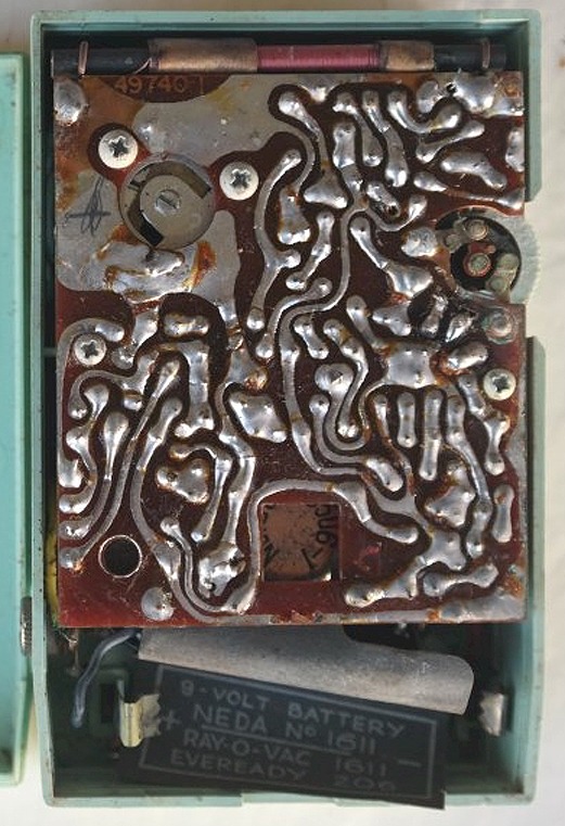

Here's a 1961 pocket transistor radio - bounced around, knocked around, carried around, for 61 years, and still playing great, just needing some old capacitors replaced.
