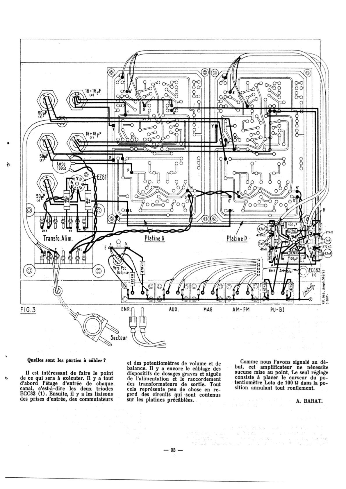

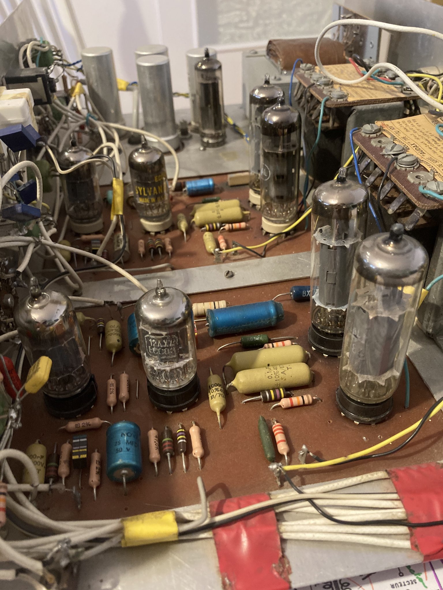

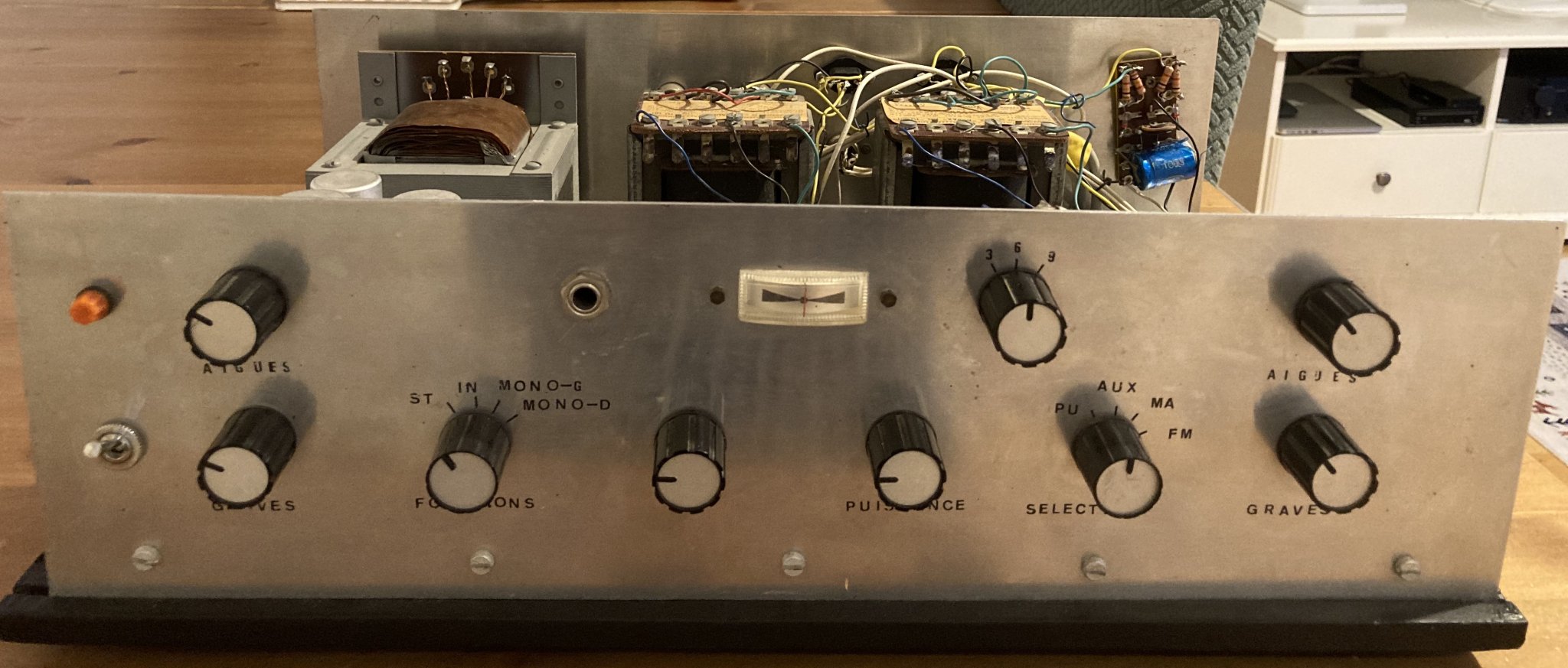

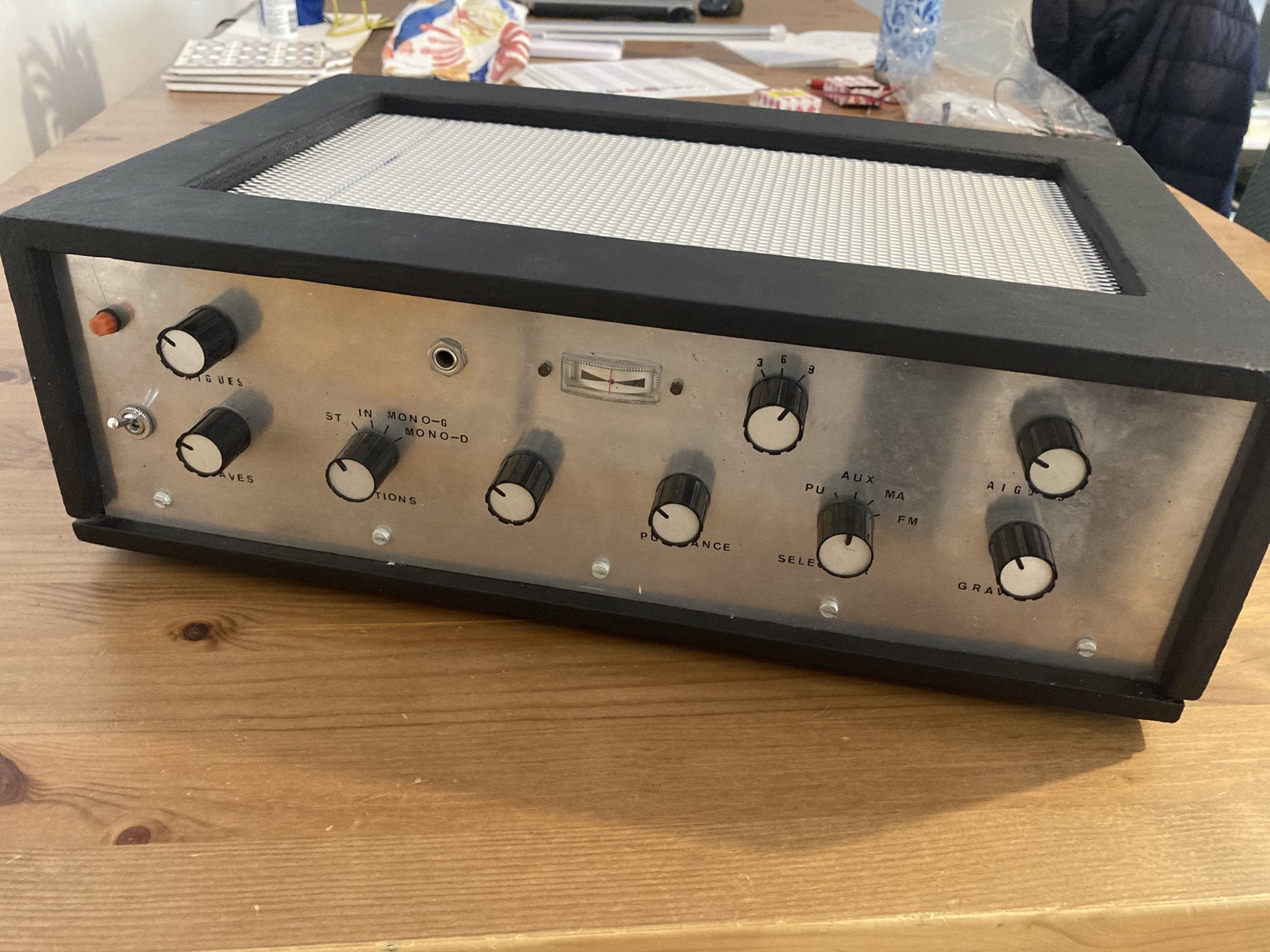

I started building some DIY kits discussed here after having to "retrofit" a kit originally made by my dad a few decades ago. I wanted to try tube amp for a while, building a kit, but i just had to refurbish his that was laying around in a cold attic.
It was a real DIY Cibot 2x10watts.
Pictures before/after available here http://idler-drive.com/index.php/fo...stauration-ampli-cibot-a-tube-stereo-2x10watt
In french but i would give explanations/details in english in case somebody is ever interested.
Paired it later with a set of DIY Full Range Foster speakers to accomodate the 8ohms output.

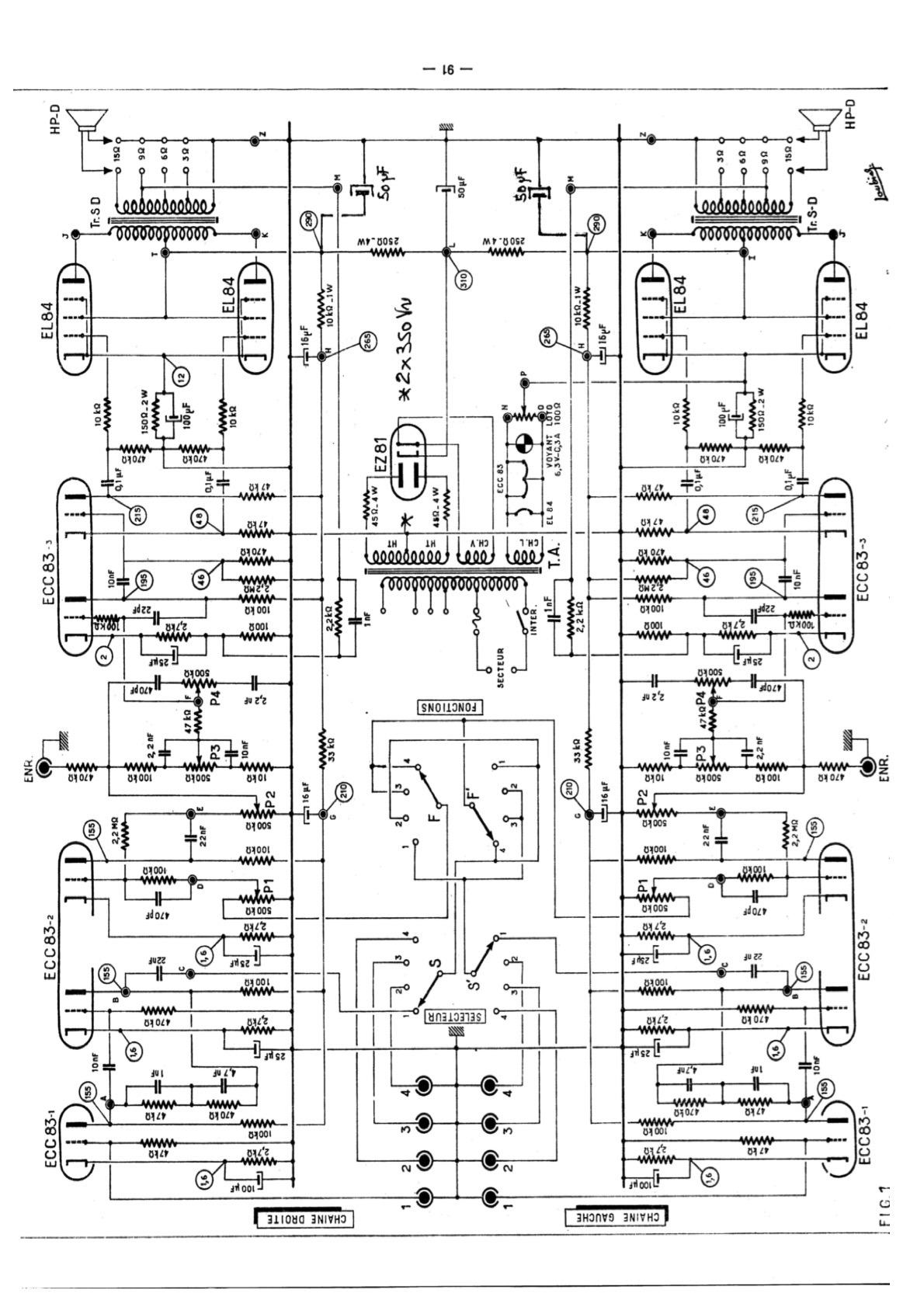

attached is a pdf of a modification to work in ultra linear mode (not done myself, but just to archive some infos)
Very nice endeavour which lead me to later build a Noir headphone amp and now a M2x!

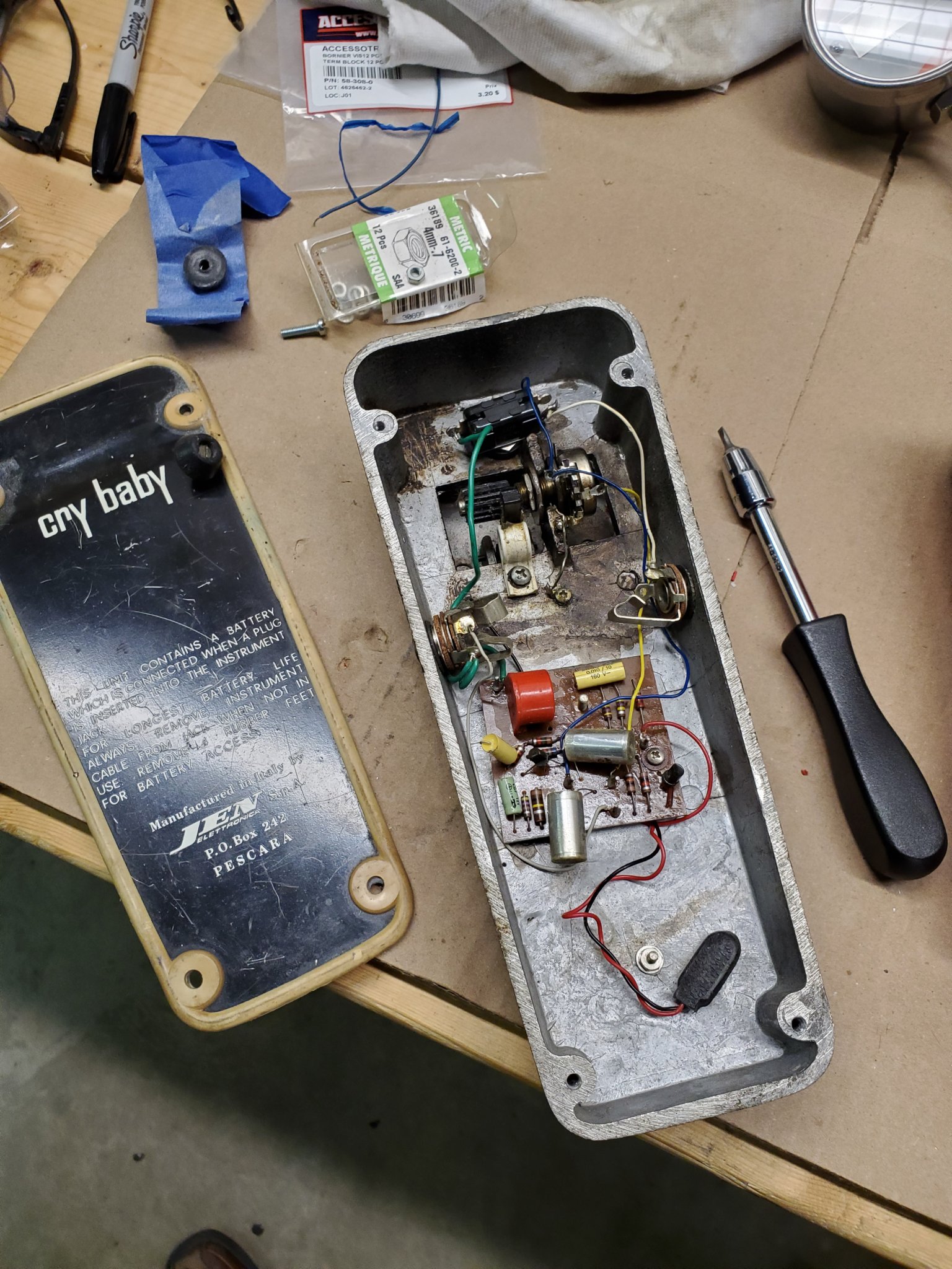

Made in Italy late sixties, the pot was crapped out feet missing, bent bottom plate, and a cap lead plus some dodgy wires broken. I rebuilt a Schaller wah years ago, that had the same aroma when opened. That filmy layer of beer, smoke etc..from many gigs in a club back in the day. Rubbing alcohol and contact cleaner in large amounts ! It's all back together, and hope it goes another 40 years..

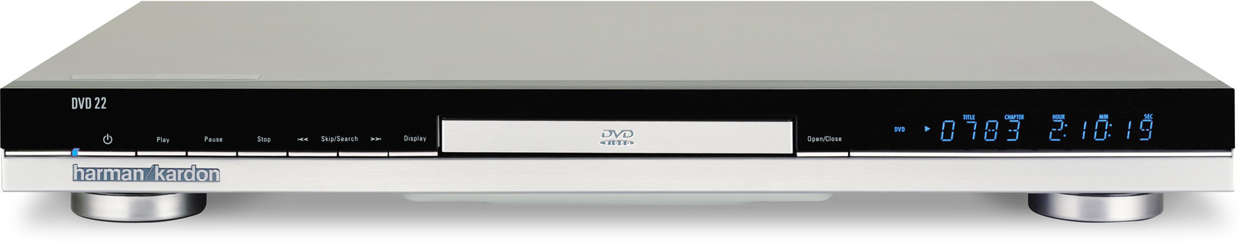

I have an H-K AVR 520 surround receiver from a few years earlier. I'm using it down at my shop now but it was the heart of my home A/V setup for many years. Still works great, except for the terrible remote, which I finally supplemented with a generic learning type just a couple of weeks ago.
I understand your point. On the other hand the guitar cable normally goes right away from the (right hand) player making input from the right side more convenient imho.
Ahh, I see now why this never occurred to me - I'm left-handed. 😛You have guitar on your neck and left (fretboard) hand, so the cord and plug is in your right hand. How you gonna plug to a left-side jack?
Ya know.... the remote for my HK DVD is also terrible.I have an H-K AVR 520 surround receiver from a few years earlier. I'm using it down at my shop now but it was the heart of my home A/V setup for many years. Still works great, except for the terrible remote, which I finally supplemented with a generic learning type just a couple of weeks ago.
It's got illuminated buttons, but the grey background with tiny dark grey text is impossible to read unless the room is sun-lit bright.
Why even bother lighting the buttons?
Who in hell designed that thing?
Here is a remote from the DVD 31, identical to my DVD 22 remote.
See the issue?
