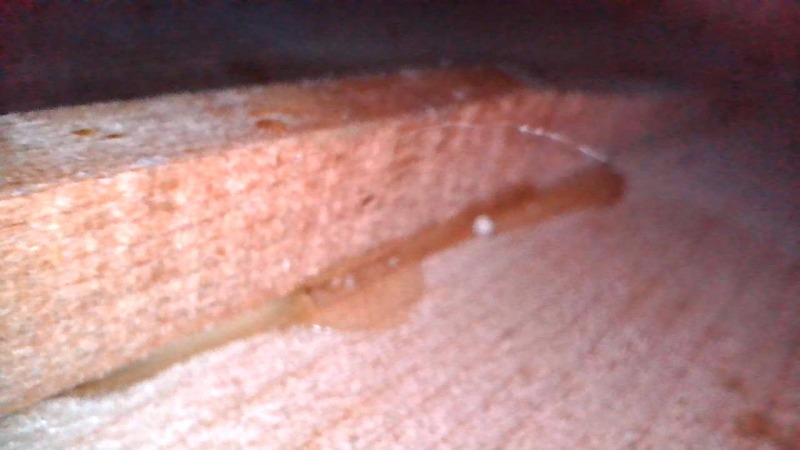

An acoustic guitar I bought has a 3 "fan" bracing scheme, where the middle one had come loose from its gluing to the bottom side of the top. This brace extends from the bridge, about to the heel of the guitar. I could barely reach in there with my hand to feel it wiggle, still being secured at the bridge end. I figured no way am I going to reach back in there with a blob of glue on the end of my finger feel around and get most of it under the loose brace successfully.

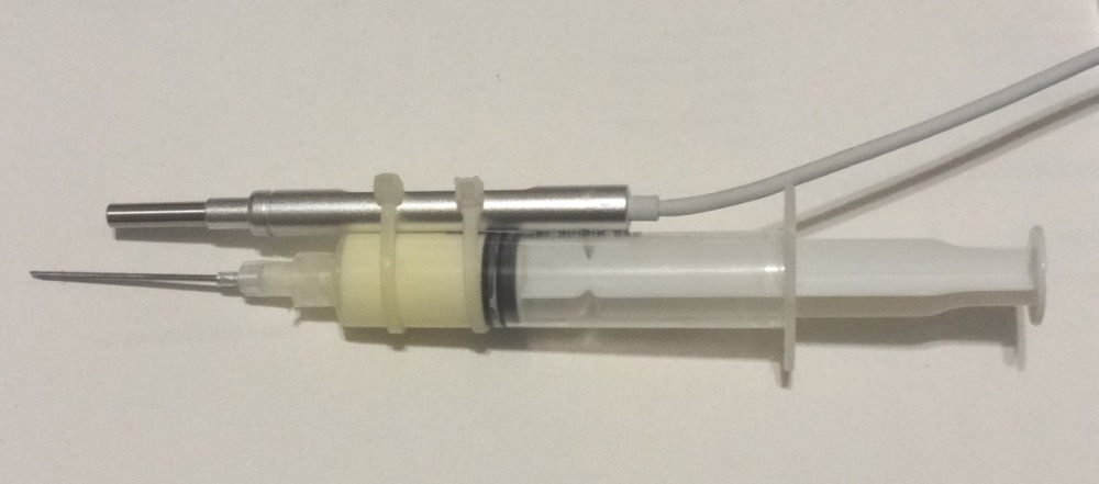

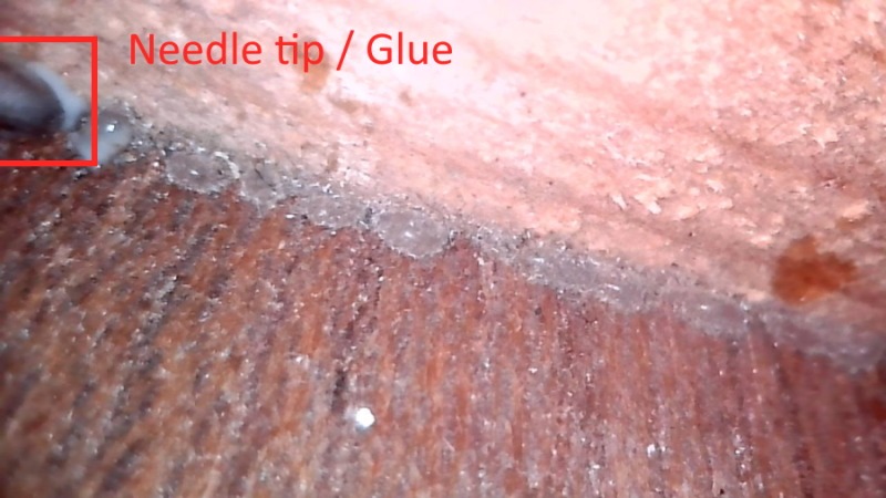

So I had previously bought this ear wax examination camera, tethered to a USB interface. Looking in there with it, I could see the offending...situation. But still no way to simultaneously hold the camera and get a fingertip blob of glue under the brace. So I went to the local Tractor supply store, got a syringe and an 18 gauge animal needle set. Took one and ground off the sharp tip;
Adjusting the camera back along the syringe axis allows me to see the tip in the corner of the PC displayed image;
I was able to - because of the extension provided by the syringe / needle, get to the spot needing to be re-glued. The camera's embedded light allowed me to see what I was doing in an otherwise blind area, making the otherwise not possible job, possible;
I did make a little spinning jack thing out of one of those metal things you pound into a sheetrock wall, to mount something to the wall with a threaded screw - this put at least some pressure on the brace to hold it up against the top's bottom while the glue set.
Well, the thread title is what did you last repair and this is one of the most recent things, albeit not electrical or audio.

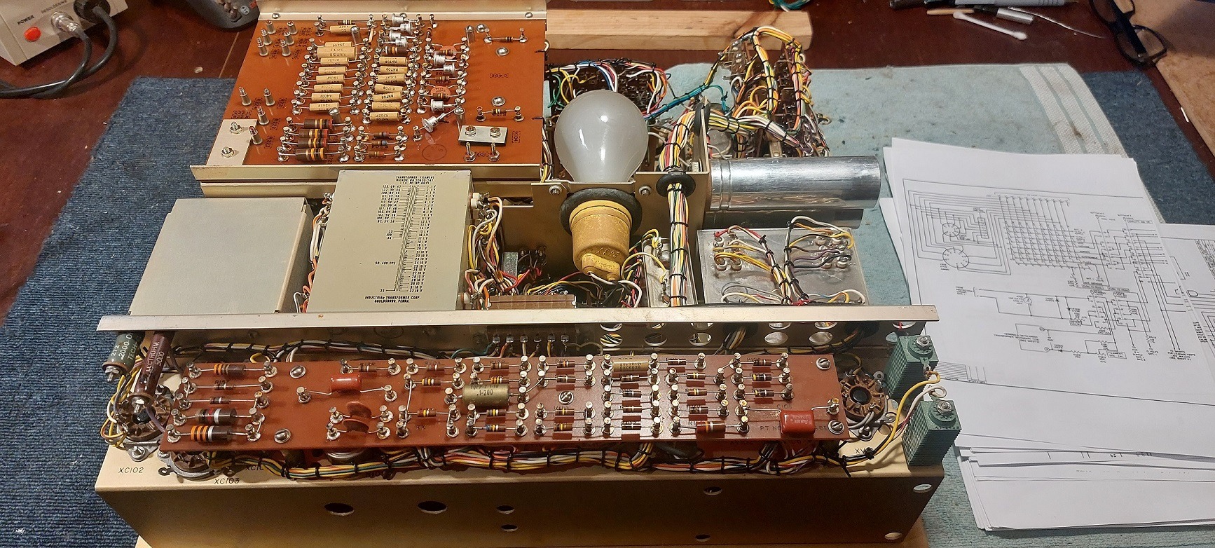

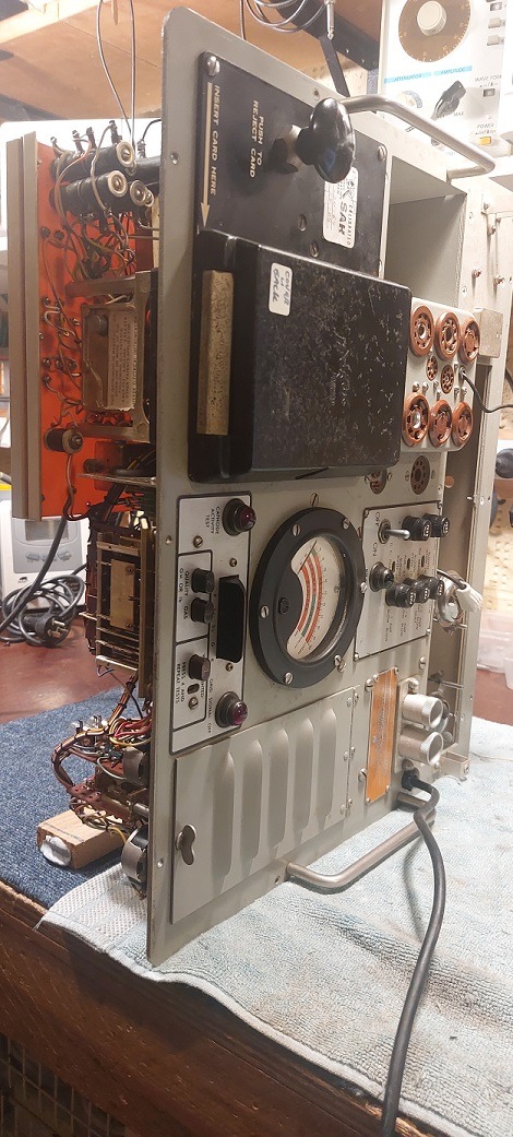

Hickok Cardomatic Tube Tester.
Bit of a minefield especially taking into account it was bought on Ebay with existing Mercury Battery Calibration Cell of which none work anymore.
Trolled the web for ages to find schematic of revised Zener Cal Cell. Lots of fun... 🙂
PS This is a full Military Spec unit and the quality of workmanship is something to behold.
