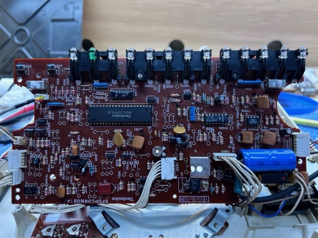

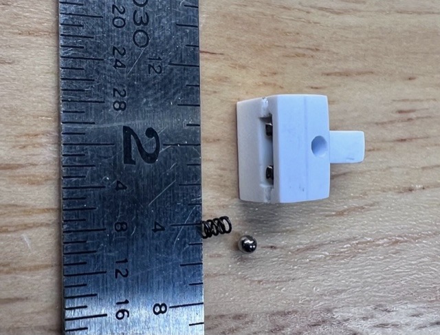

Just finished a complete restoration of a Technics SL-6. When I received it albums would play normally, but the programming functions were completely out-of-whack. Several of the electrolytics were bad, and at least one previous attempt at "restoration" resulted in the almost complete disintegration of the contact carriers in the two slide switches controlling disc diameter and sensor level. As these are unobtainium, they were rebuilt from scratch using styrene and X-acto knives (and a boatload of patience!).
The first picture shows the completed carrier prior to installation of the detent ball and spring (the curved sides don't exist, they're due to lens distortion). Final adjustment of the finished deck per the service manual was difficult, but finally yielded excellent results!
