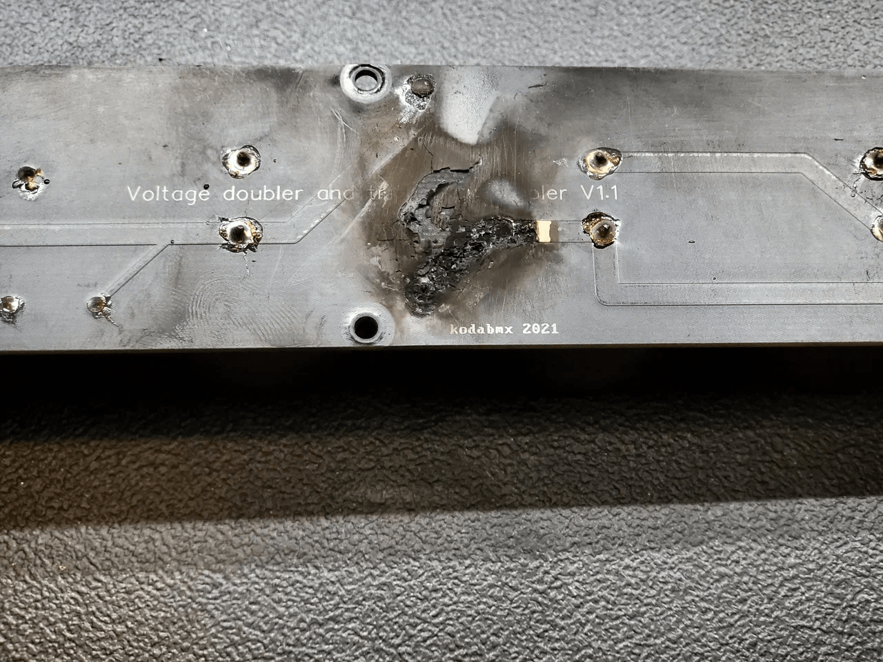

And this board is good for the scrap heap LOL
That resistor must have angered the electrical gods...

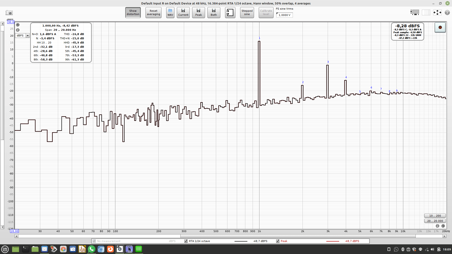

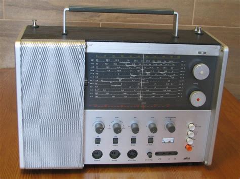

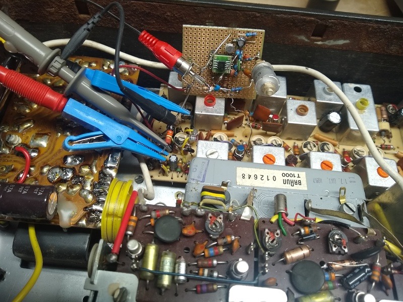

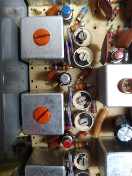

I repaired a transistor radio "Braun T1000" bought in 1967. UKW sound suffered from nasty distortions sounding like the station never was tuned in correctly. So I delved into the 10.7MHz-IF amplifier tried to tune it several times - but to no avail. A closer look to the ratio detector finally revealed a broken Ge-Diode AA119. I have a bunch of Ge-Diodes, but nothing similar to these. Finally I replaced both Ge-Diodes with a low-power Schottky-Diode BAT41 that comes quite close. At this point I could tune the IF-amp using a small FM-transmitter I had built for this purpose meanwhile. Using my soundcard setup and REW-RTA I tuned to smallest THD. Station finetuning is done by searching the minimum H2-distortion level (=max symmetric), while H3-distortion indicates if-bandwidth limits. After a long journey the sound of this old beauty now is quite satisfying.
