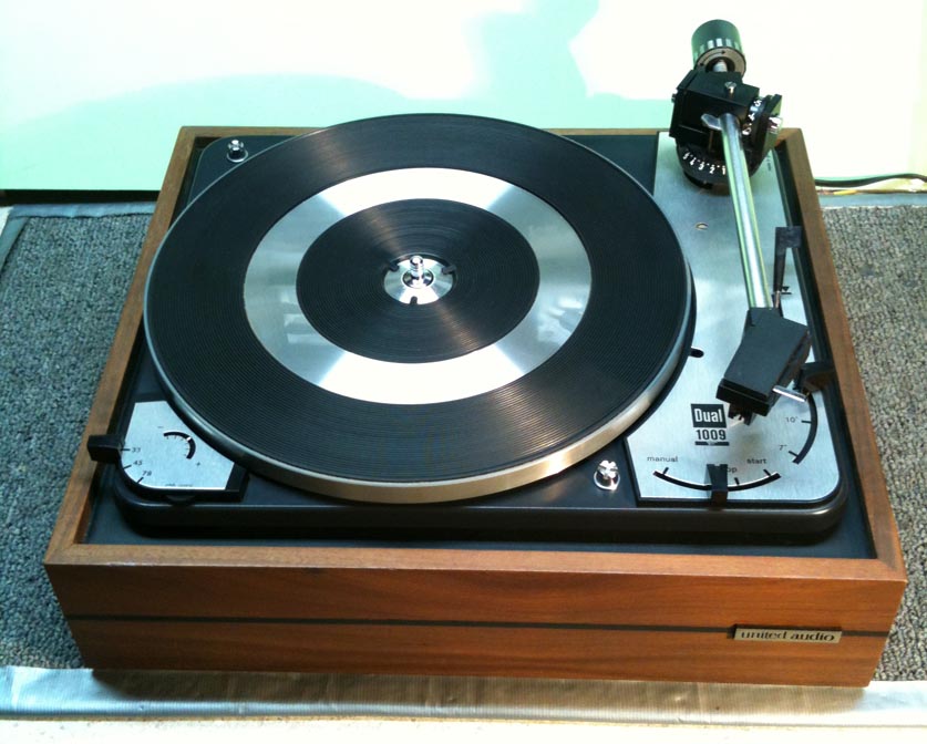

I just finished up a Total Teardown and Complete Overhaul of a sweet 1966 era Dual 1009F turntable.
Installed a new cartridge carrier that came in the mail today, and a Stanton cartridge.
I even have the stacker spindle included with it.
The thing's in pristine shape - like new, and performs better than any of the junk made today.
It's going on my Craigs List ad tonight.

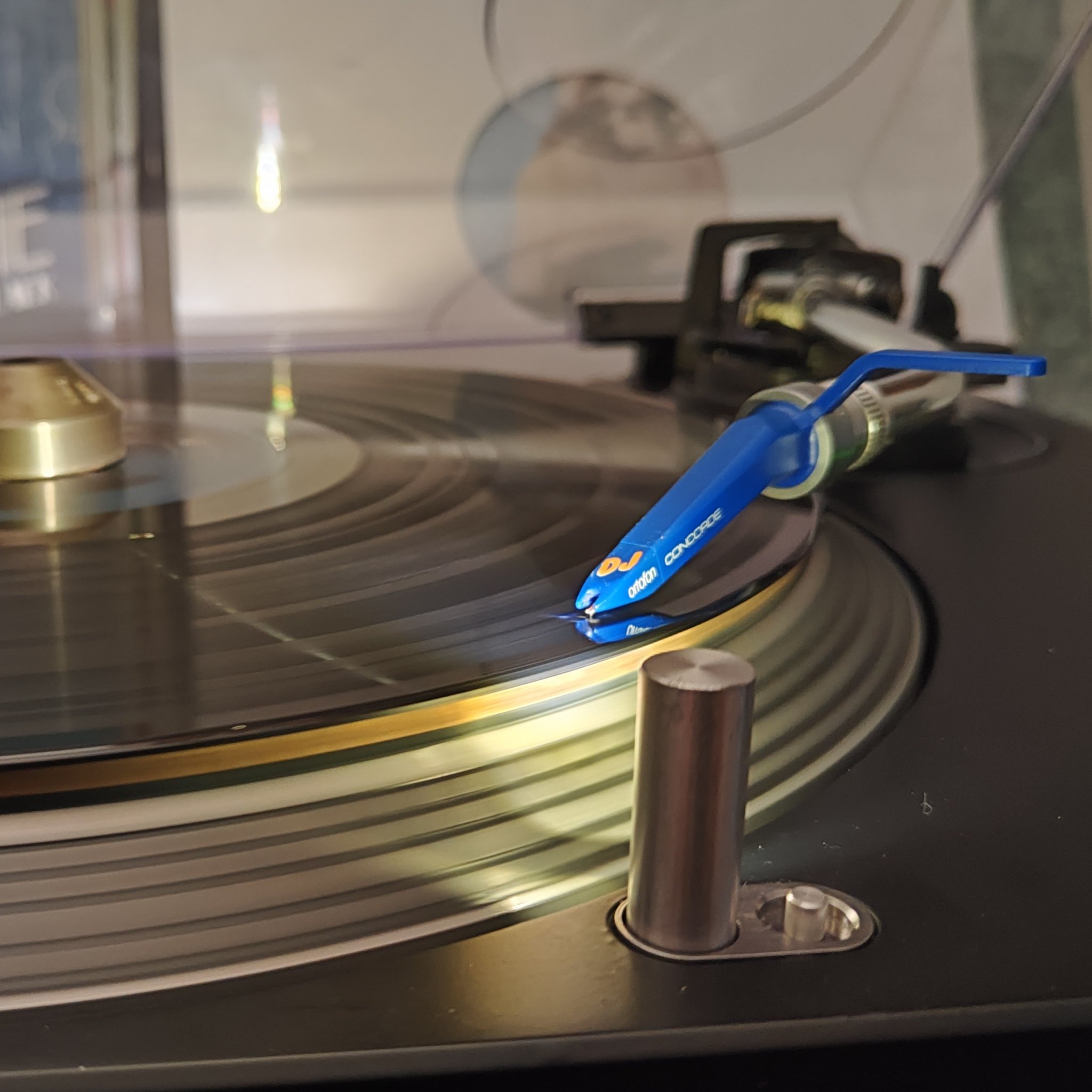

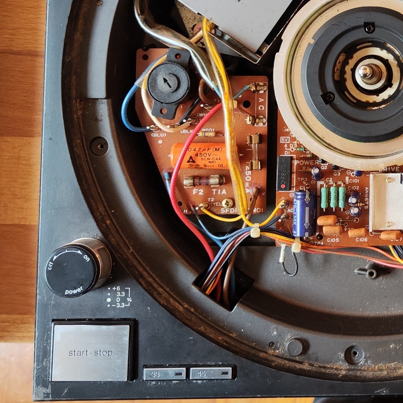

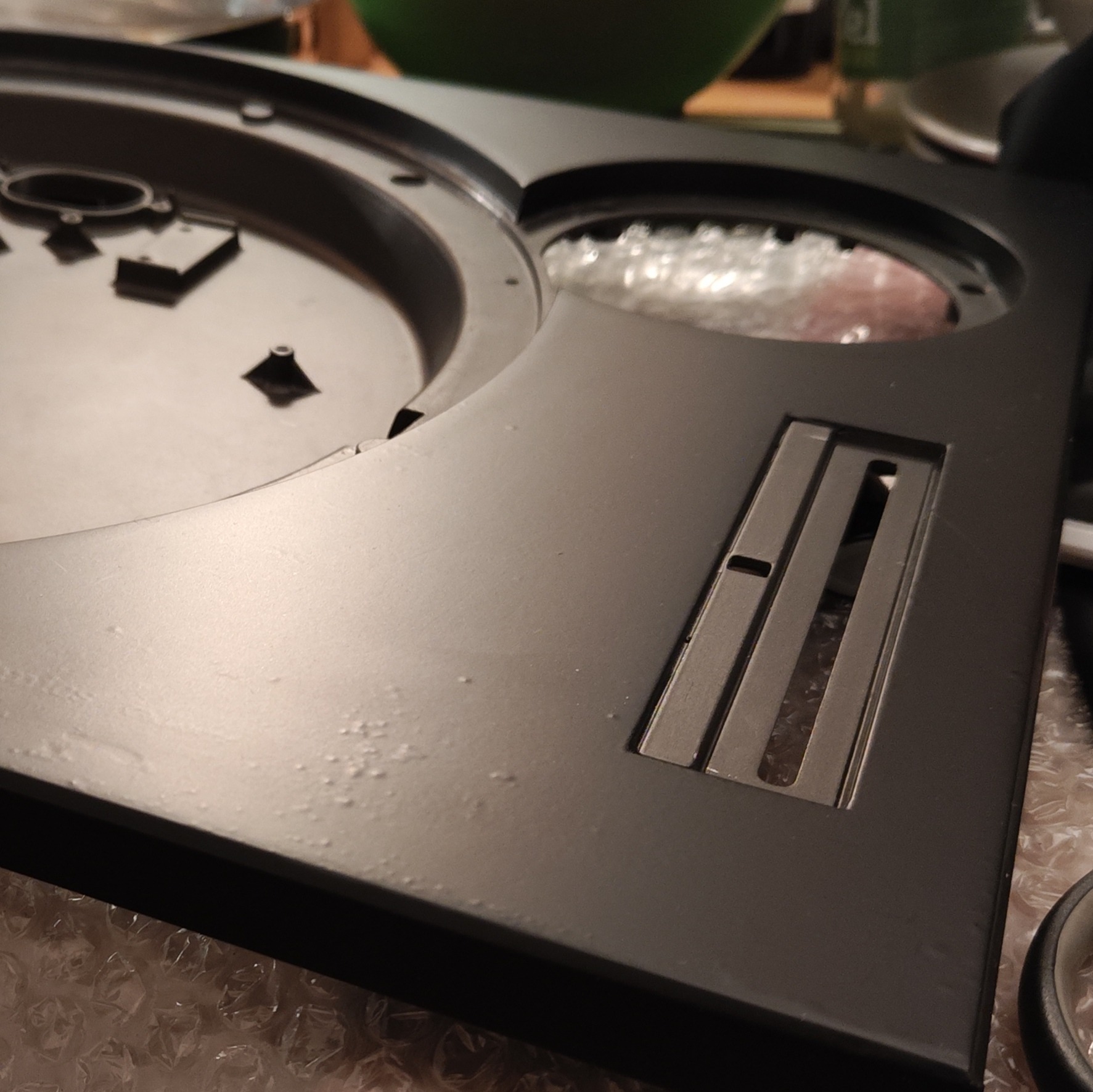

This weekend I fixed another Technics SL-1210 MK2. It showed up on my local Craigs List as a defective Unit. Seller said that pitch and target light where not working properly. It also proofed to have a problem with its tonearm. After a complete disassembly I found that one of the bearings had been mounted wrong before, that's why it was stuck. Surprisingly it turned out to be an easy fix. Some bending with a dentist pick removed the dent in the bearing cover enough to allow the bearing to move freely. It still looks ugly, but after a thorough clean of all bearings and parts the tonearm was adjusted easy. Beeing a mechanic working with adjustable bearings helped a lot.
I also disassembled the pitch fader to clean it and removed a lot of ugly debris. After the clean up the pitch adjust works like a charm. The needle target lamp mechanism also had to be cleaned and I removed the defective bulb and soldered a warm-white LED. I cleaned up every single part of the turntable. The chassis parts got scrubbed with soap and rinsed three times before they were clean. The original paint was so damaged that I tried to apply a wrap foil. That did not work too good, I have a lot of bubbles and the edges and corners look quite ugly. But it still looks better then before. The platter looks dull and shows substantial corrosion. It still has to be polished.
I assembled everything to check if it works. The first checks went great, now the music is playing 🎵

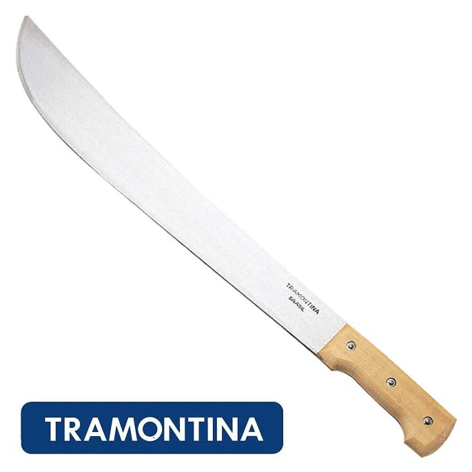

A knife.
A piece of junk because of a blade that extends very little inside the plastic handle.
Fitted with glue.
Of course the blade came off loose.
So.
I drilled through the handle and blade extension and tight fitted a pin.
Know, it is a decent knife, fixed as it should have been designed.
I keep some old kitchen knives around the shop and sharpen the blades.
Great for cutting/trimming stuff like styrofoam and foam rubber stuff.
Reactions: 1 user
