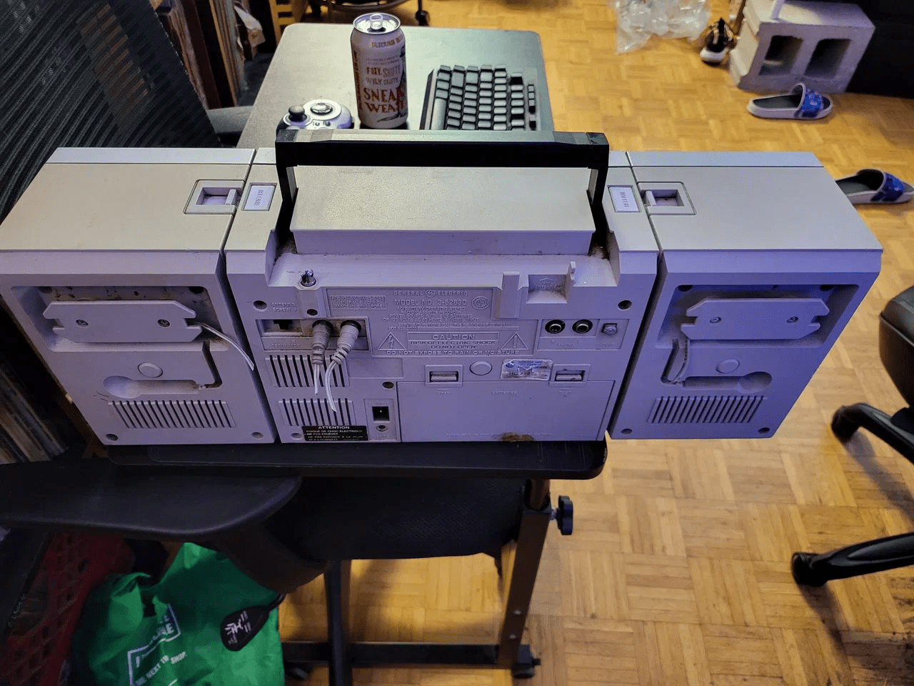

I haven't repaired it yet, but knowing what people pay for these, I couldn't leave it in the garbage.
BUT!
If you throw out electronics you don't want, there's no need to be a douche and cut the wires. These people have a special place in my heart (and Hell, actually). Seriously, I would never do this.
I've seen scrappers cut cords off electronic garbage and leave the rest for the trash man. A quick and easy piece of copper wire.
I the days of CRT TVs, they would bust a hole in the back of the cabinet with a hammer just to remove the deflection yoke for the copper.
If you wanted anything you needed to get it before the vultures came along.
Those days are over as there's no more roadside collection for E-waste, at least in this part of NJ.
Yep, that's what they do. I saw a scrapper on YT just hammering and blasting a large number of transformers. Of course, he's nearly only after the copper itself.
Seeing how transformers are super useful and can be super expensive to order and ship - not only for audio but for other domains - there could be fruitful collaborations with them, but for that we'd need to convince not to hurry and smash all of the transformers they collected or collect them at the source before they do!
