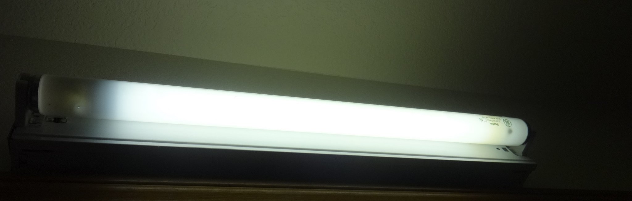

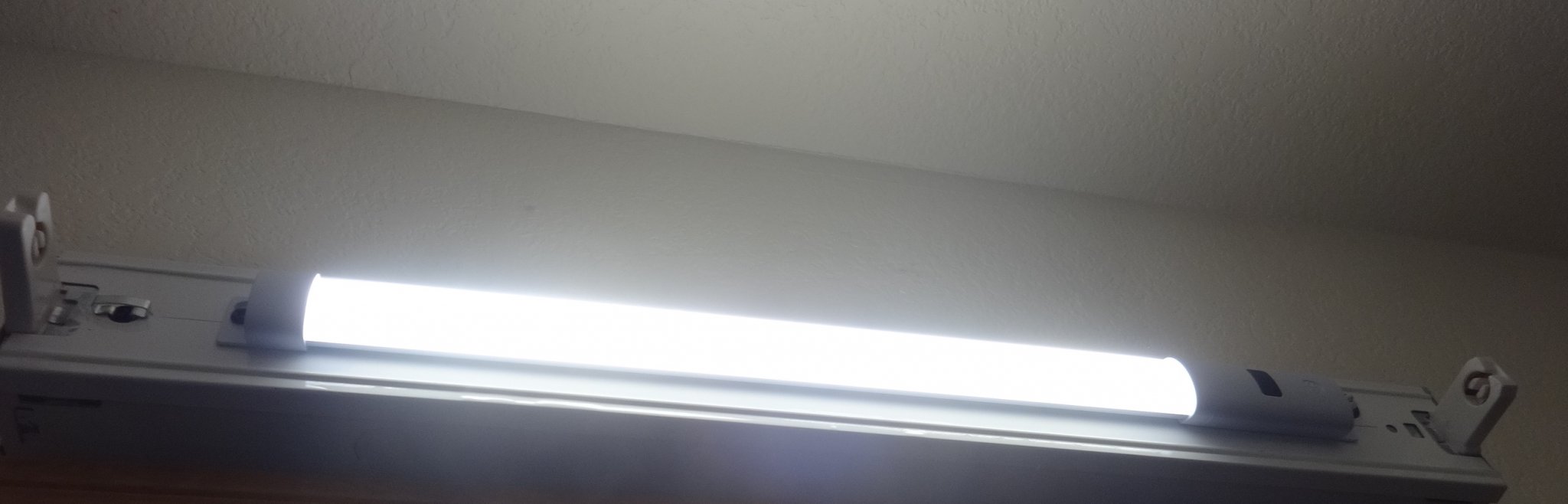

I repaired the lights in my closet. Hit Goodwill between Walmart and Winco on our weekly grocery shopping trip, scored a pair of new GE under-cupboard LED strips for $6 ea. Before and after. I kept the fixtures in place; maybe someone wants to change back to the tubes someday? The hard wired AC line to the fixtures would need a box anyway...off go the plugs!

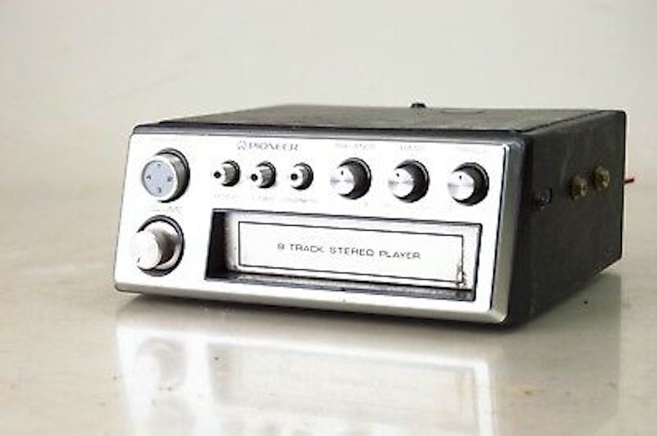

I installed an 8 track player into my 67 Firebird this year. Why Not?... a Pioneer Tp 727 from 1975. Added PRE AMP output RCA's and a line driver to get the volume just right. LOUDEST 8 track player on EARTH..... in 2022... LOL.... BDBD.2022

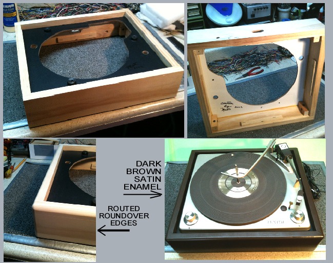

Well this is not so much of a "repair", more like a "restoration"........
I had sitting around a 1966 Zenith "Micro Touch" record changer that needed overhauling.
It was originally in a trashed console stereo.
For a VM/Zenith product, it has some good features, and needed a major cleaning, relubing, etc.
It actually sounds quite respectable with a new stylus, and I added an equalizing network to enable the high quality ceramic "Floating" cartridge to be used with any amp's RIAA/Magnetic phono input.
It also needed a "home" - so I hit the woodshop in the garage and fashioned a nice base for it, then painted it a dark brown satin finish.
I'll probably add it to my Craig's List ad and see if someone's interested.
