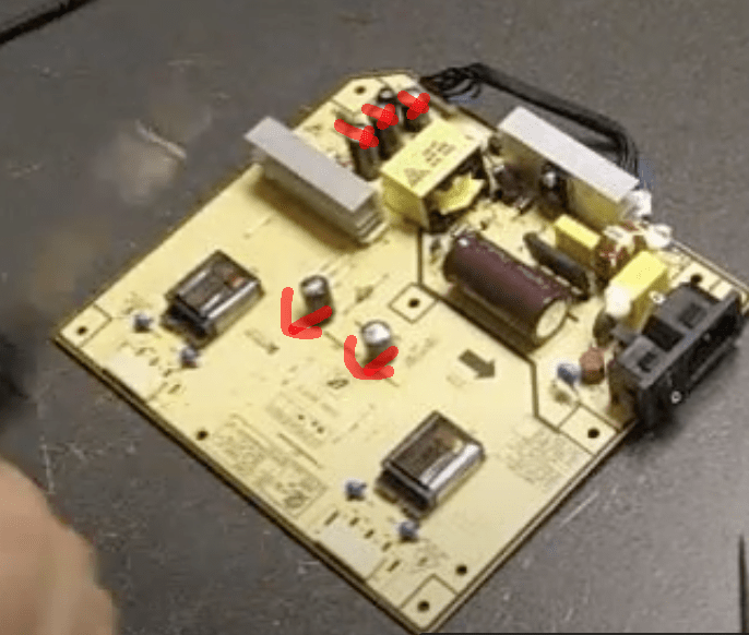

My wife is real happy, she works home with a brand new Samsung 24" curved wide and the 22" repaired, plugged on a laptop Lenovo i7 through 1*Hdmi and a thunderbolt 4 to Hdmi adapter; Now I can keep building my Pass UGS and F7 mono... and others... 😎Isn't it almost always a bad cap, eh? LOL Good fix.
To extend the life of capacitors from CFL inverters and SMPS sources in general, I additionally solder a few more ceramic capacitors (4.7µF-22µF) directly between the pins of the electrolytic capacitors. Sometimes, especially if I see signs of overheating in the area, I also add some improvised heat-sink from the pieces (usually from Cu) soldered at the inverter transistors (around them), or even in their drain.

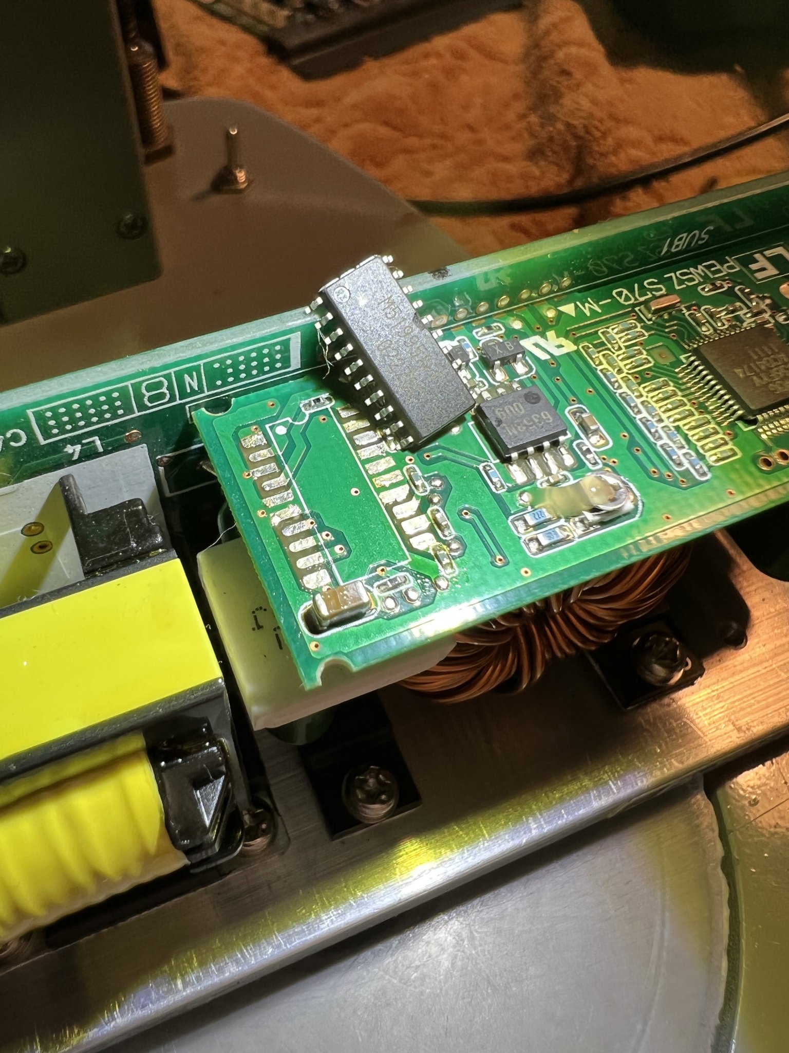

Fixed a JVC rs65u projector that wouldn’t turn on.
replaced a M5199 control chip on the ballast along with a LNK363dn chip on the back side of the board
also. I resoldered it under a stereo scope
And now it came out of the grave and works ! I can tell by the light dust on the fans that the hours counter
at 702 hours hasn’t been reset.
