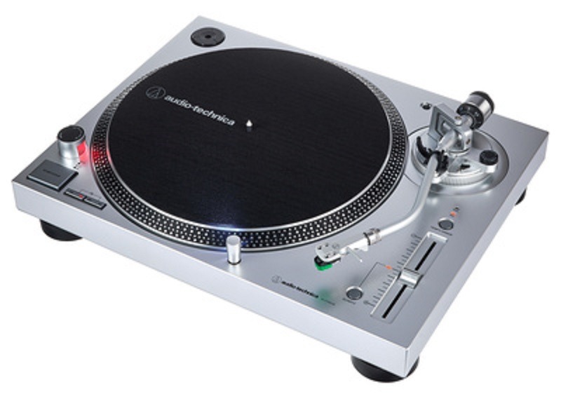

same as the ones you get on the audio technica decks
Reactions: kodabmx
There's nothing "knockoff" about it. The fact is Hanpin makes a very good product.
For 750$ you get a turntable with wider pitch control and three times the torque as a 1200MK7 that costs 1300$ and the same wow and flutter specs as a £6000 Acoustic Solid Wood Round MPX Turntable (https://hifiplus.com/articles/acoustic-solid-wood-round-mpx-turntable/)
The only turntable with a retractable light is a 1200 now, and they now use LED instead. So much cheaper to use an RCA and an LED, plus you can steer it, too 🙂
Numark makes (made) a few good TT's as well and they also have the non-retractable RCA sockets for a light. Steer-able as kodabmx notes, and the removable light is as useful as a retractable light (when transporting). But, you do need to keep track of it so it does not get lost.
