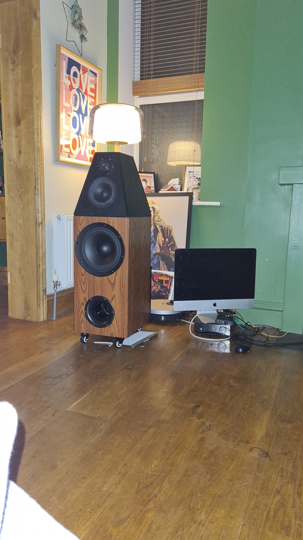

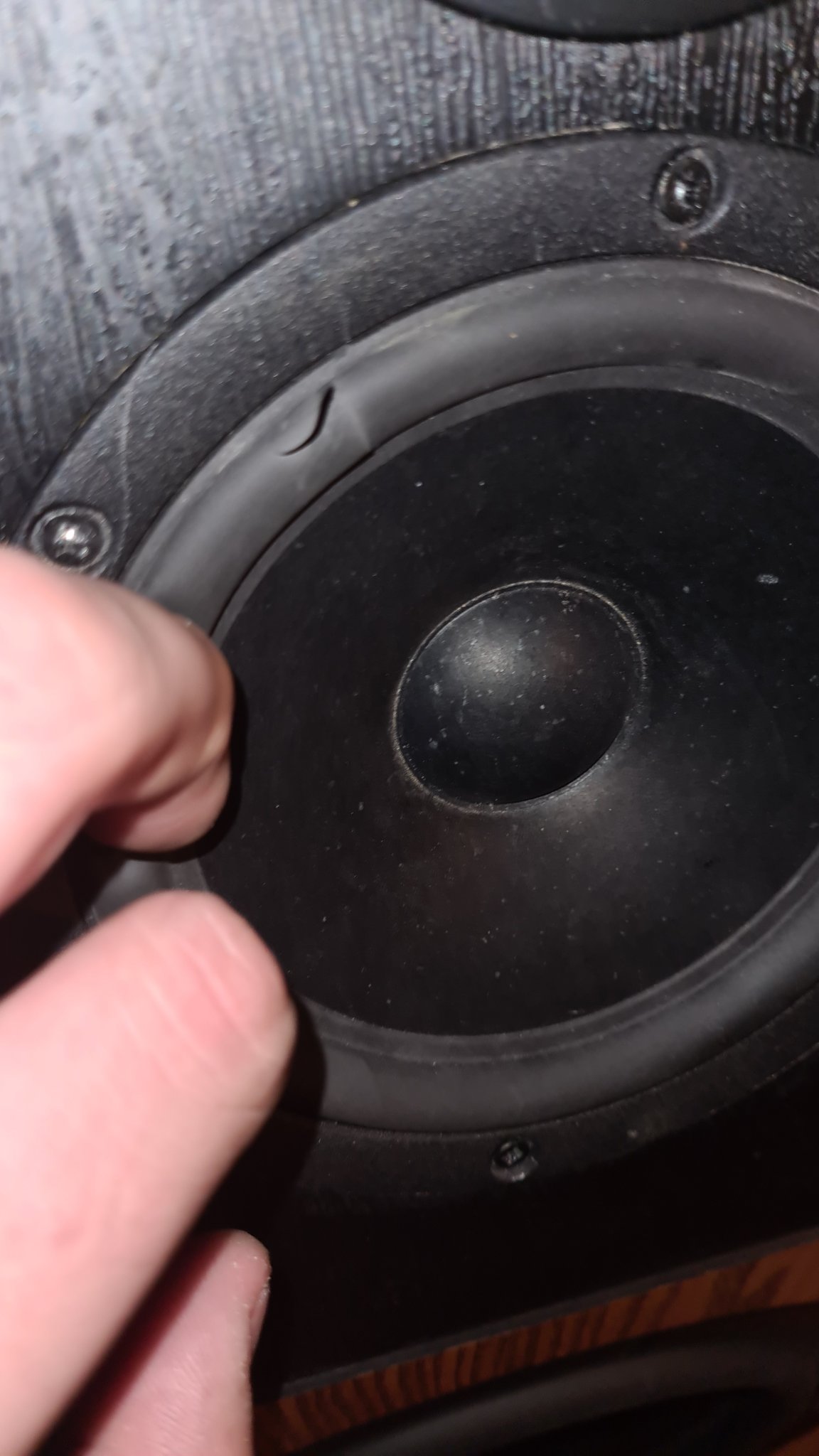

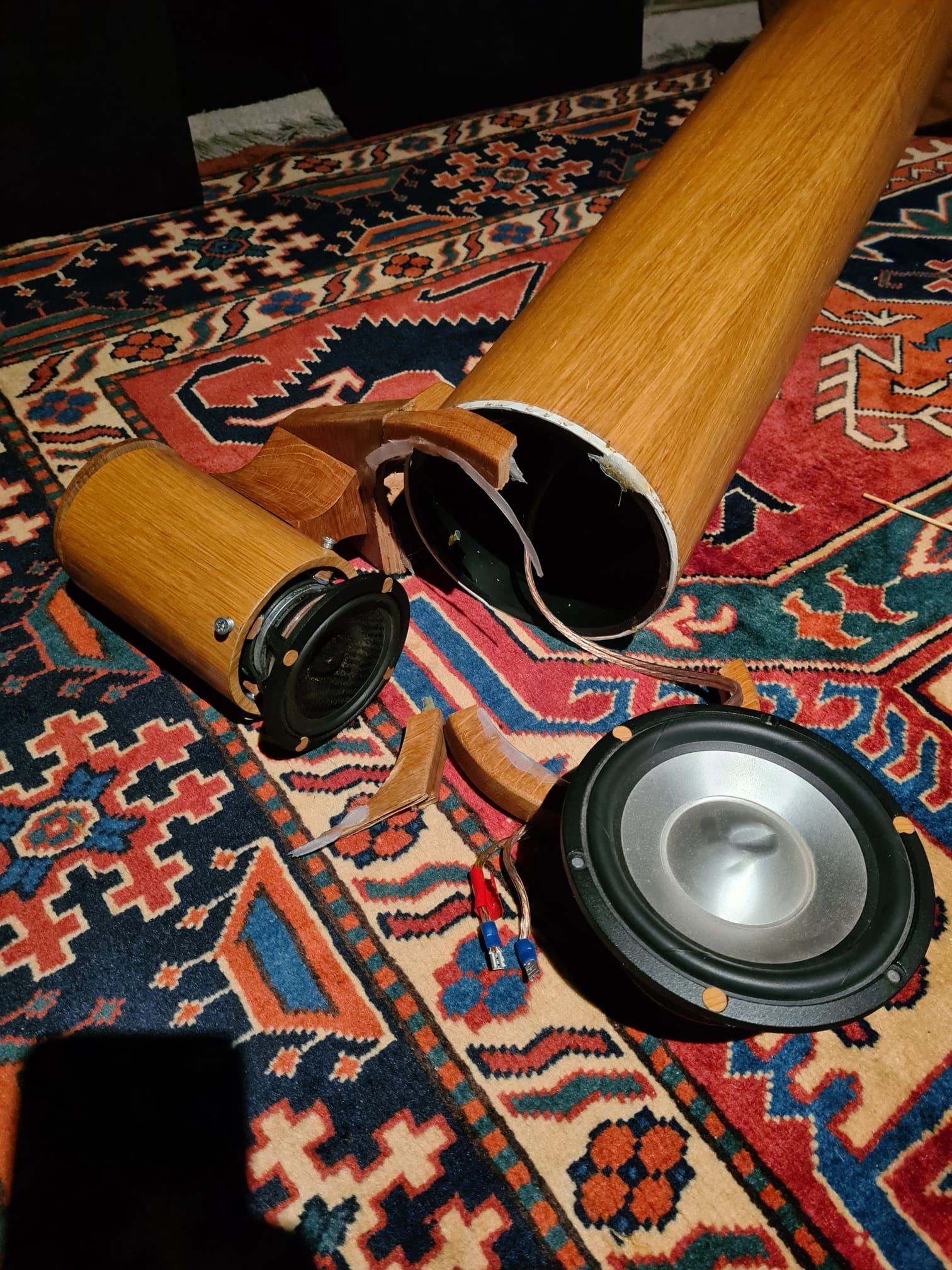

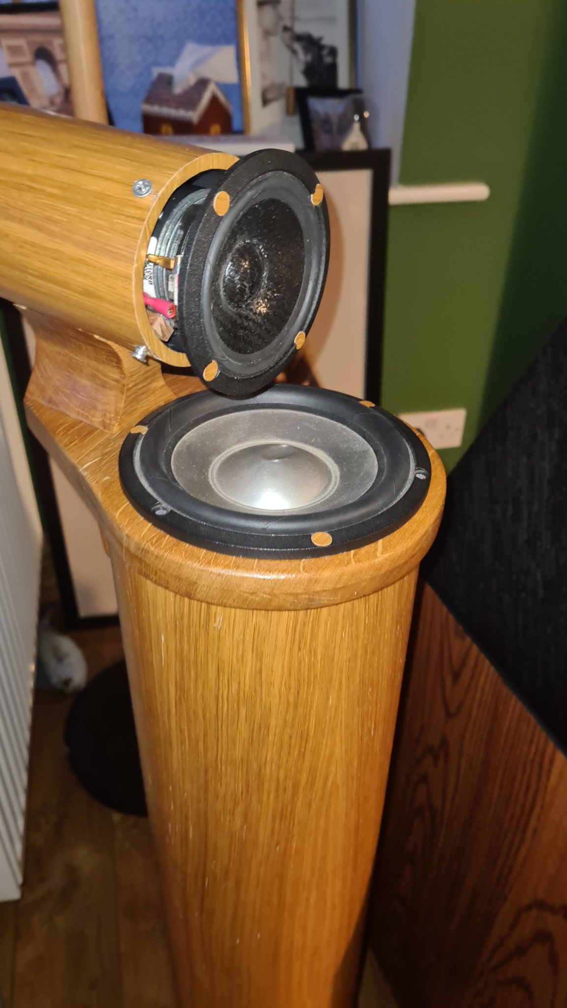

Cat attack victim linkwitz glued back together. The dent in the woofer is annoying me!
Then, last night the cat damaged the satori from my Troels sba10. I'm starting to think the cat doesn't like me / speakers. The speakers will be moving to their own cat free "safe space" later today.
If someone could recommend a good adhesive to repair that tear / slash in the woofer that would be great..

Torn rubber like ring is damaged.
Black soft fabric paint, the kind used to put decorative blobs, may work.
Or black silicon bathroom / window caulk, the non hardening type.
If you can sort of get the gap's edges close enough, use Pliobond or similar contact cement, hold in place with masking tape till it sets.
If it is a material like PU or EVA, carpenter's glue, with black pigment added, or sticker glue.
Sticker glue is used in the back of stickers, and release material used to cover it till actually sticking it where needed.
Quite a versatile material, but it becomes non working, goes stiff in the jar in about three months. Kerosene is the solvent for it.

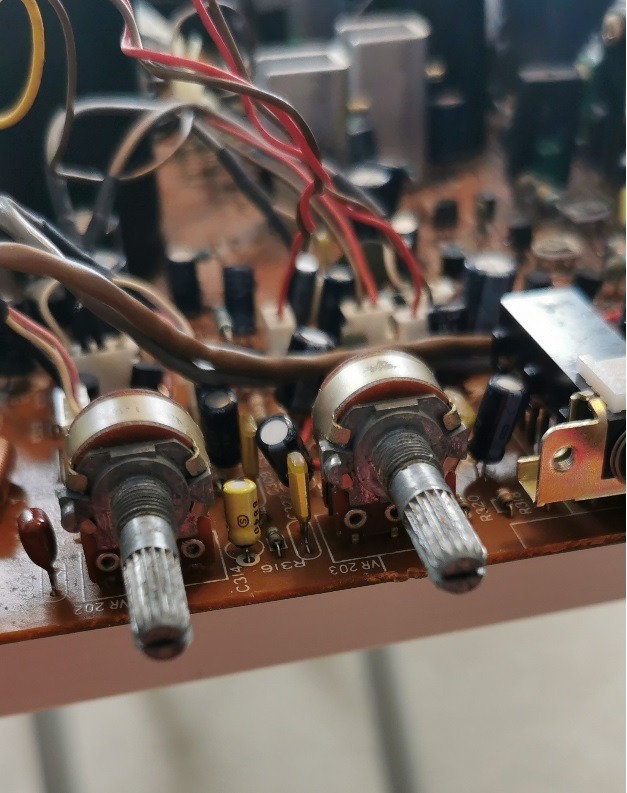

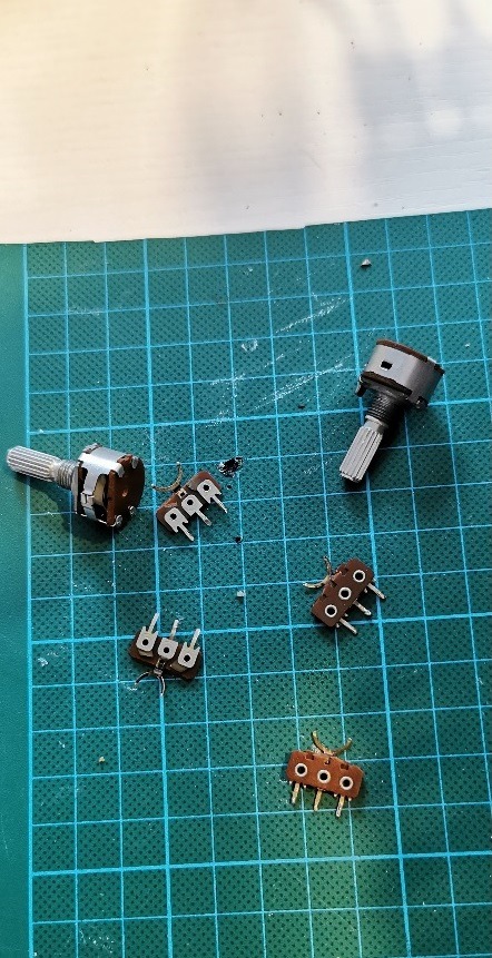

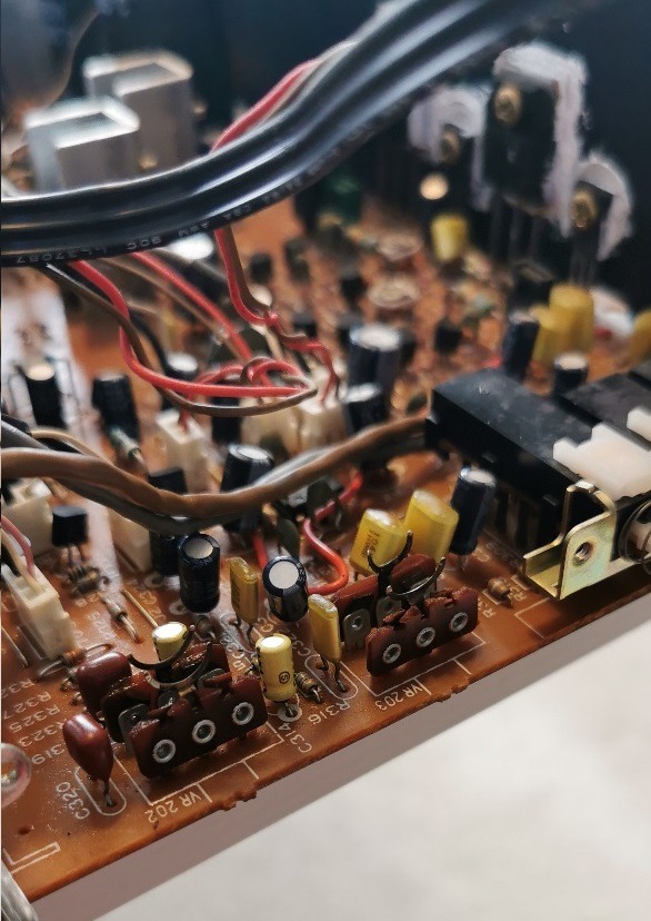

An unusual one, never seen this before in an amp-NAD 3240pe
so when tried to use the bass and trebble there was a horrible grinding from both, so i turned it off and found them both totaly broken
lucky i have original spares for these
any ideas how it may have happened, to both?? weird uh?

Perhaps an amateur repair attempt at removing the front sub panel without first removing the pot mounting nuts?
Hard to say, but that kind of damage takes significant force.
I've repaired several things with cracked / broken circuit boards because the unit was dropped, and usually the owner was too embarrassed to say so.
