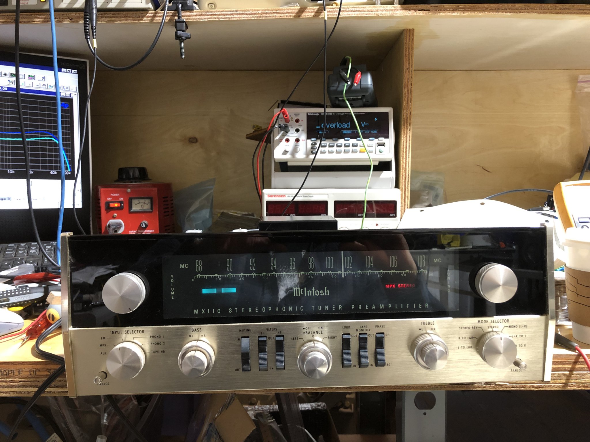

I had 2 of those 110's here for service - the older 110 with the thumbwheel balance instead of the knob like yours.Recapped and retubed a Mac Mx110. I had not aligned a tuner in many years.
A 2.2 G spectrum analyzer and tracking generator made it easy.
Both were in bad butchered shape, and flaking paint on the glass panels.
I didn't waste my time with them, thank god the owner picked them off to pawn on some other sucker.
I don’t understand the interest in them but for a friend it was fun. He has two of them this one was a little rough but works well.
The RIAA was +- .25 db and the rest in spec. I would think most people wouldn’t want to pay what the real cost should be.
