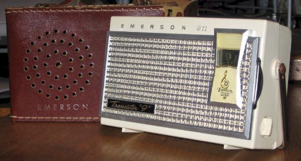

Just finished restoring a 1964 Emerson 911 "Eldorado" 9 transistor AM portable radio.
Had poor reception near the lower part of the band.
This set has an RF amp stage, 3 IF stages, so it should pull in plenty of stations, which it does now.
I had to replace every stinkin' cap in the set, including the ceramic disks.
A representitive photo of the 911....

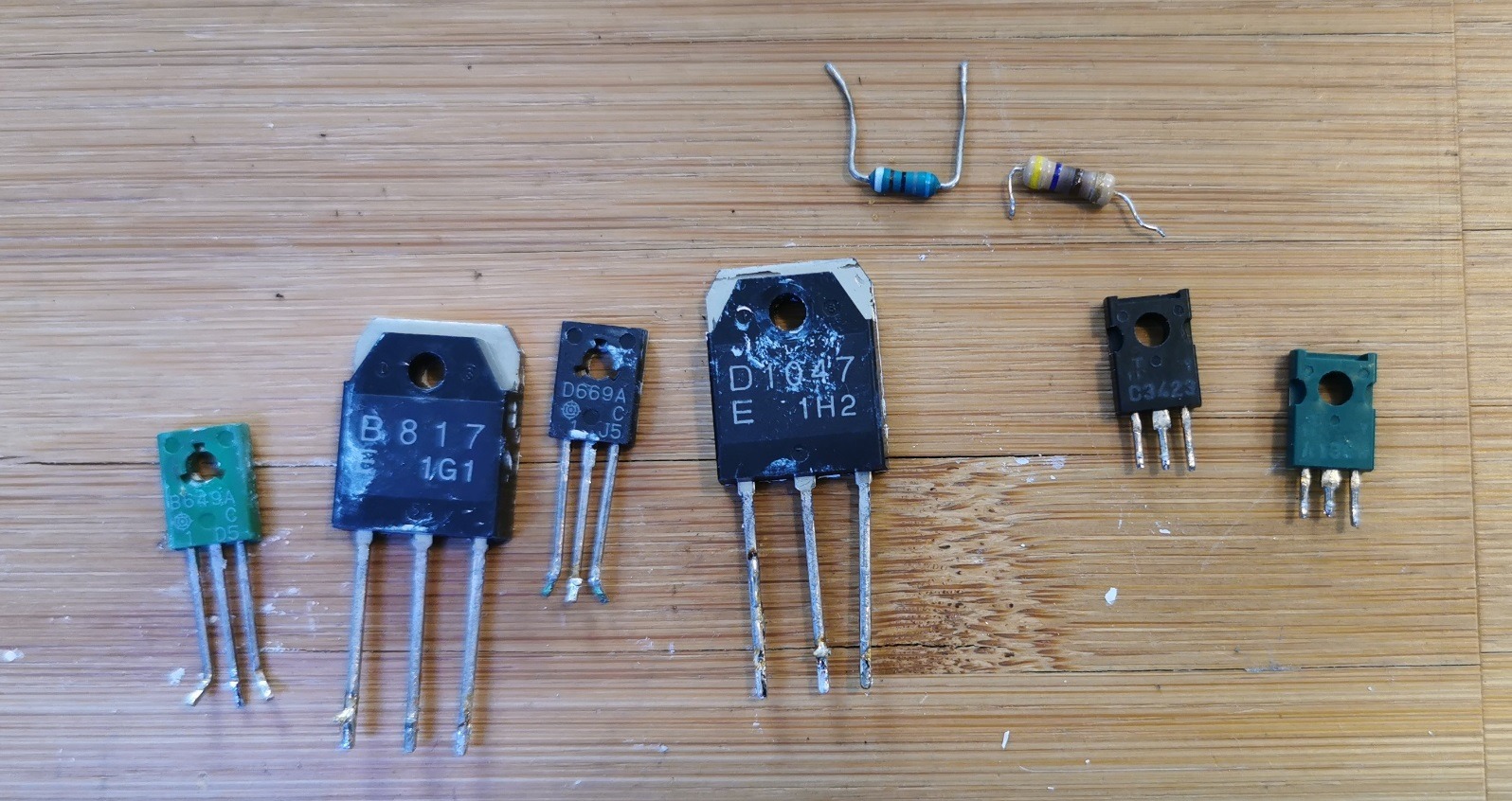

A NAD 3240pe-almost the whole output section gone-driven to almost destruction
all good now (y)

now that i like

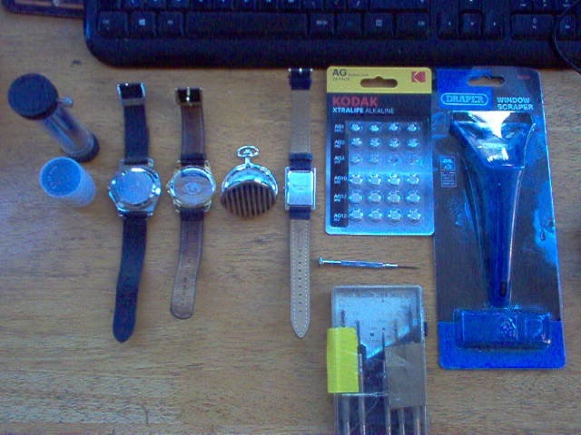

I've was given a pocket watch today that needed a new battery.
My pocket microscope reveals it was a tiny SR626. Apparently equivalent to a Kodak AG4:
https://www.batteriesinaflash.com/watch-battery-cross-reference
£1.50 for a job-lot at Poundland. Cheaper than £10-12 at the jewellers.

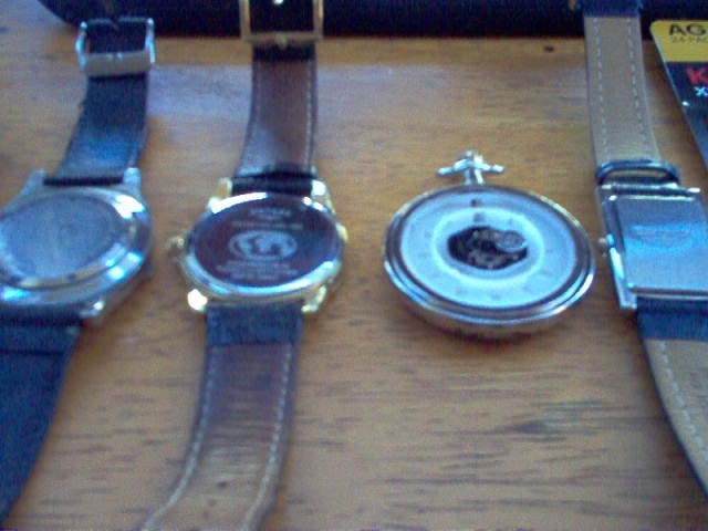

Did the pocket watch and the dress watch on the right.

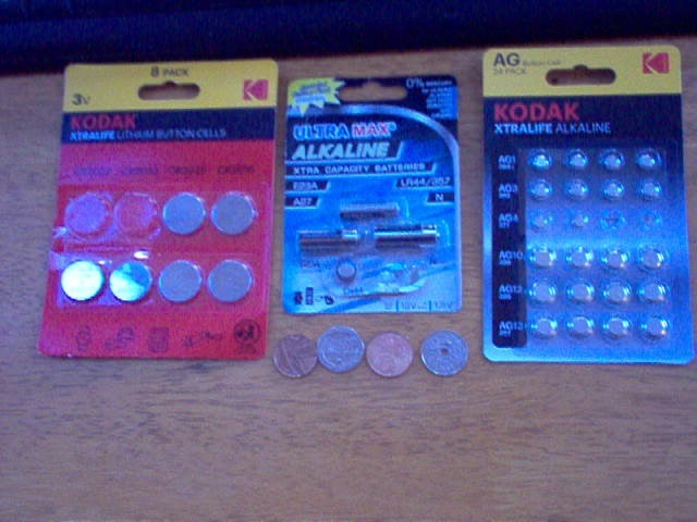

Will research the 6 slot screw thread on the left-hand Ben Sherman, and the next Rotary, which lifts of with a blade, but experience tells me has a tricky rubber grommet to waterproof.
These things used to last 5 years, but now you get about 18 months.
Tricky things, batteries. So many types and thicknesses!

Seizaken (Seiko) 30p UK
Maxell 20p UK
Each, SR626SW
Retail to me
Shops pay half.
By the way, that is 6 mm diameter x 2.6 mm thick
CR 2032 is 20 mm diameter x 3.2 mm thick
....and so on.
Chinese LR 44 were 60p for 100 some years back, still must be less than 100p, that is right, 1 penny for a cell.
