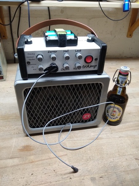

Today I was called to a customer who had an annoying noise problem around his home studio that made it impossible to do any recording. He told me on the phone that it was worst with single coil p.u. and the expensive mains filter could not fix the problem at all. I assumed a magnetic field interference caused by some loop in the electric installation. So I soldered a small 47mH inductor to a guitar cable, plugged this into my tiny battery amp and set it to max gain using its high gain distortion channel. With this "sniffer" we checked the cellar and finally landed in the garden where the noise was all around. It turned out there was an electric power loop layed around the hole garden and the noise source was the pond pump. Removing it from mains solved the problem immediately. Talking more about this I learned the noise problem has been around for about 2 yrs - since the installation of the pump.
Resuming this is a quick and dirty work-around and next summer the problem with the pump has to be fixed. Personally I do not have a clue what makes this pump generate excessive noise on the power grid. Nonetheless the customer is happy now being able to proceed with recordings.
This was the - totally uncalibrated - h-field sniffer:
