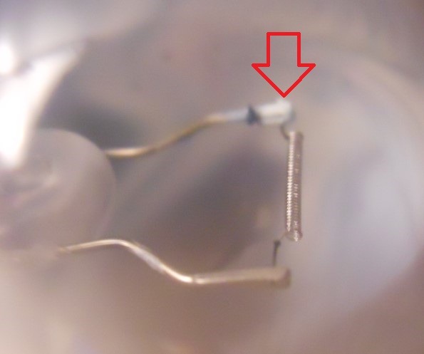

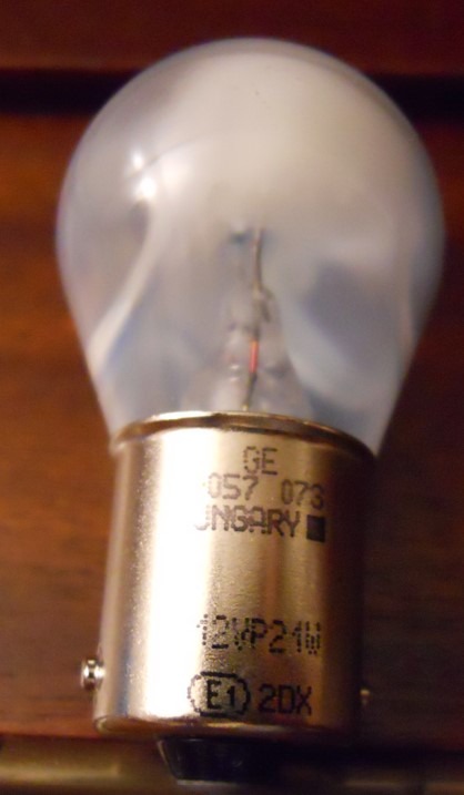

Two reversing lights in a 19 year old Toyota. Both bulbs had failed seemingly within a short space of each other. The filaments are intact but the filament to its support seems to be the problem. Never seen this before. I might try putting a higher voltage on it to see if it breaks down the white deposit and regains continuity.
You must have a lot of time on your hands.Two reversing lights in a 19 year old Toyota. Both bulbs had failed seemingly within a short space of each other. The filaments are intact but the filament to its support seems to be the problem. Never seen this before. I might try putting a higher voltage on it to see if it breaks down the white deposit and regains continuity.
i saw this once on an old cortina i had years ago where the lamp had lost its vaccumI've seen that before - I assume there is an air leak.

Those bulbs are scrap, vacuum lost, corroded filament support, unsafe.

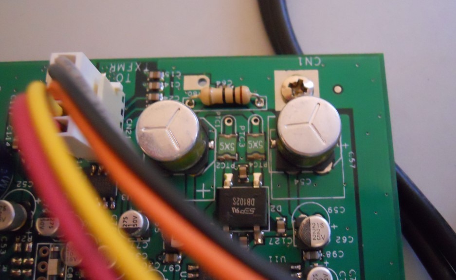

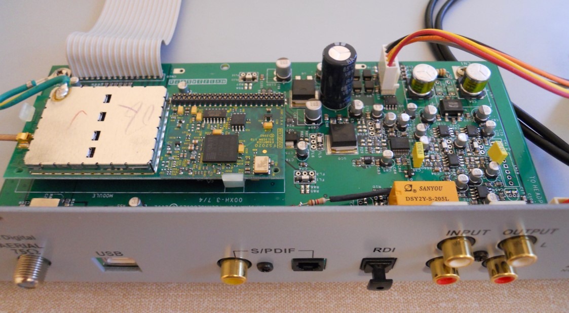

lovely and cleanMy beloved Pure DRX-701ES DAB tuner had a little attention today. The caps in the PSU have been known to cause trouble and the two 470uF/25v reservoir caps were slightly bulged on top. The 2200uF 25v also got replaced. The board was already drilled out for leaded parts and so these are what I fitted, some quality Panasonic 35v replacements. Those odd looking do-dahs between the caps are marked on the board as PTH so presumably some surge limiting thermistors.

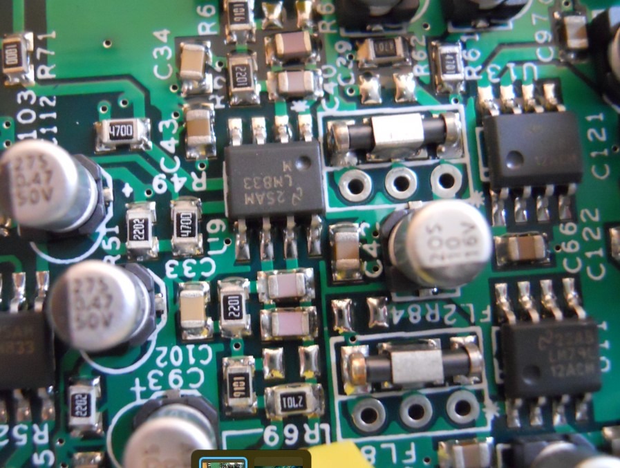

The opamp's which were generic something or others got swapped a few years back for LM833's (not the old LM833N but the TI upgrade which uses a quasi complementary NPN output stage). These are an under rated chip imo. The chip removal and soldering was all done by hand using a Philips soldering station and large bit.
I should have measured those curious looking things next to that particular LM833. Could be some kind of filter or coil. Seems to be one for each channel.View attachment 1009997
