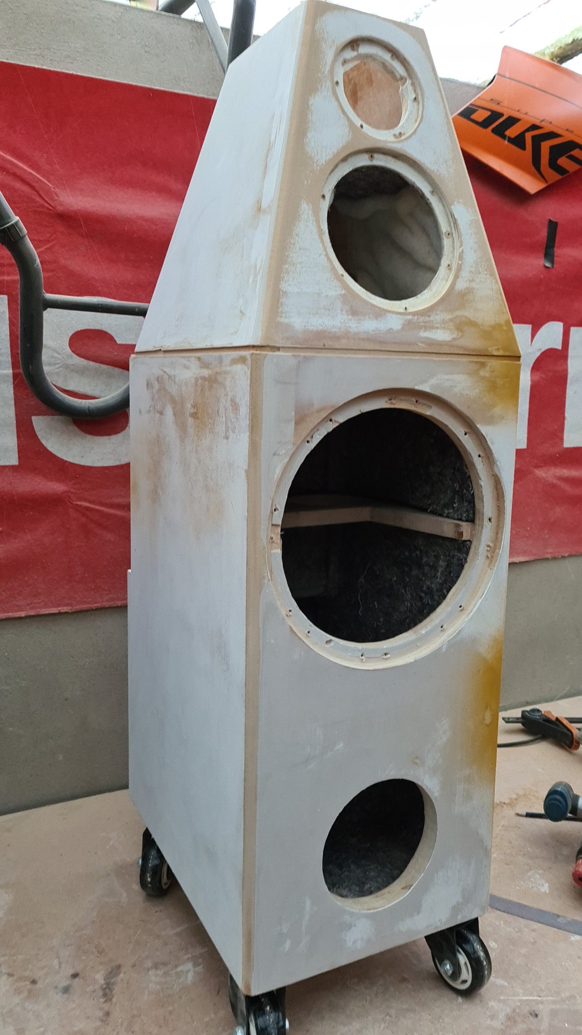

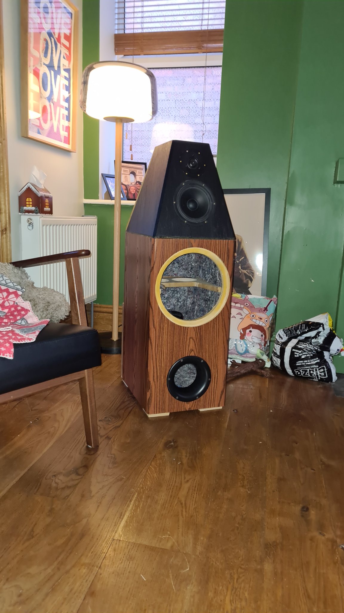

Finally managed to get a vinyl wrap on the sba10 'fixing' them. I was always a fan of the old kef 105 which inspired the wood (plastic) colours. I'd been listening to them unfinished for approx 6 months.
They don't look perfect but if I saw them in a thrift store i would think they were 'vintage' rather than diy. The vinyl looks surprisingly good in person.
Next up is repairing my lxmini the cat smashed..

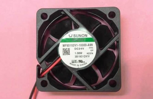

Well, our HP laptop started acting up again...the thing was damaged when someone, (who won't fess up)...the individual picked up the thing by lifting it away by the screen, the hinge on the left broke...of course near to a cooling exit vent & the power "ON" button. As the substructure got damaged, the cooling passages "changed course" and the fan started making noise, maybe from a bad sleeve shaft off the motor. So we had it "repaired" at a shop..they merely slopped some epoxy inside trying to get things lined up again. All was well for awhile, but the fan started making noises & recently a warning would come up as over-temps were showing. We added a fan table to get some more circulation...but frankly this fan-table couldn't blow out a candle...weak AF. Now the thing is going into temp shutdown. Never could get the plastic covers off the back...Found a spot on the back as likely an air "intake" some 50mm by 50mm horizontal slots, a perfect size for a little 12V microfan I had, but looking closely, behind the suitable slots, was a sheetmetal structure with tiny holes for airflow...the airflow with maybe 1/3 rd of the slots in surface area$%$%%.
As the plastic panel was perfectly flat, the little fan I have fit perfectly... Superglue sealed & bonded just right. Rigged up a switch off a 12V wallwart...then a simple three-sided wood riser for some space between this "fan-table" & the Laptop itself for the clearance of the outboard fan...Let's see in time if the ^&^%$# thing stays cool.

Find the service manual or a tear down video, and open the cover, change the fan near the CPU, some of them are like miniature blowers passing air by the CPU. Noisy fan needs lubrication, or replacement.
The plate for the vent may have small holes to prevent small bugs getting in. If you feel like, remove it.
Broken hinges are a common issue with laptops, and if needed, you can reinforce the area with fiberglass woven tape, used for motor insulation, a similar cotton tape is not suitable.
Some plastics do not bond well with epoxy, I found that cleaning the area with epoxy paint thinner, and adding epoxy paint thinner to 2 part epoxy (Araldite, standard grade), made it bond to a printer cover which would not stick with epoxy earlier. Only enough was added to make the epoxy a little more fluid, and it worked.

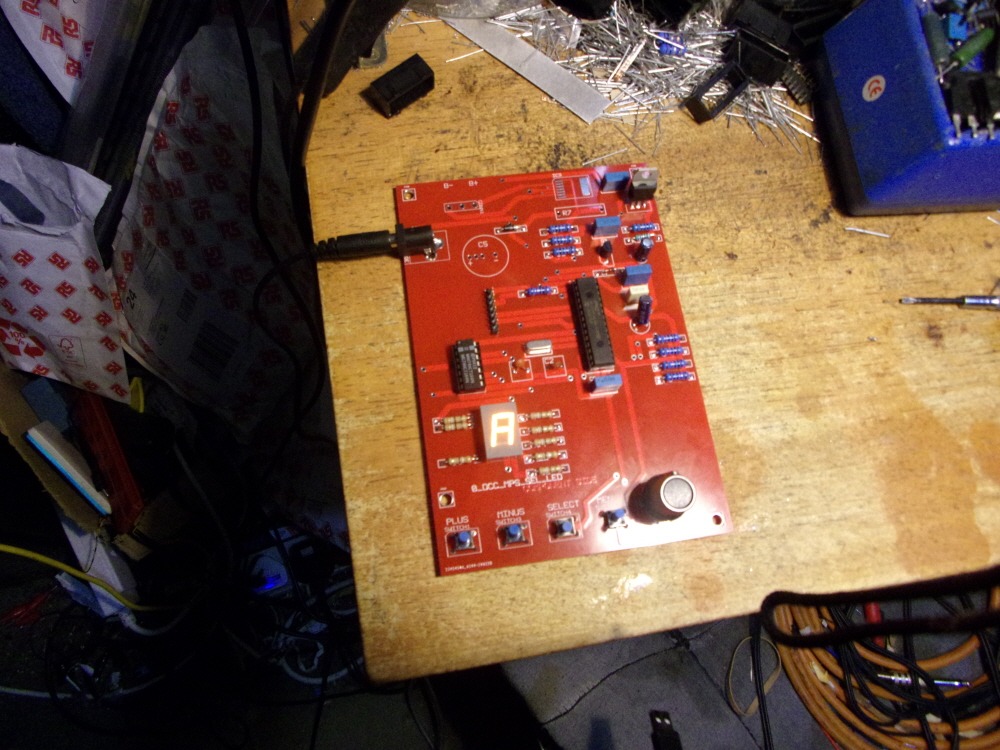

I designed a circuit and while waiting for pcb I wrote the software.
PCB arrived today and tried the software and found some bugs.
Was sending bit 7 first into a shift register instead of bit 0 so 7 segment display was backwards.
Its basically a model train controller but minimised to keep costs down.
One 7 segment display and four buttons (plus. minus, select and menu)
Its a bit cryptic to use due to minimal user interface.
So I blank out display between numbers so you know it was entered ok.
Once control function is done I rotate the display to confirm done OK.
