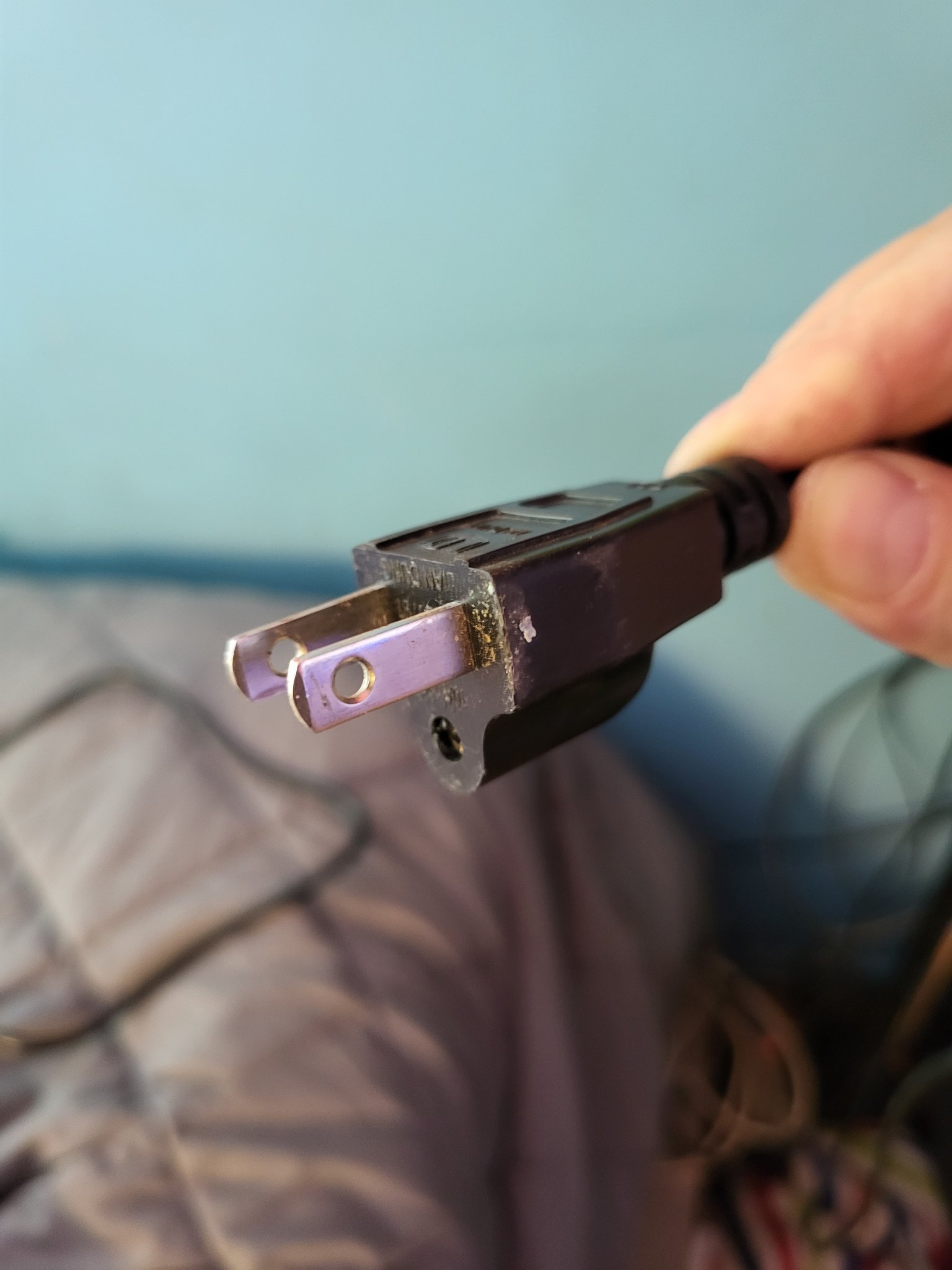

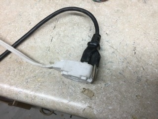

Oh I know LOLAnd how you‘re supposed to get rig of the hum….
It didn't even fix the hum - it just moved the loop elsewhere. Today will be a rewiring session to find the hum.
