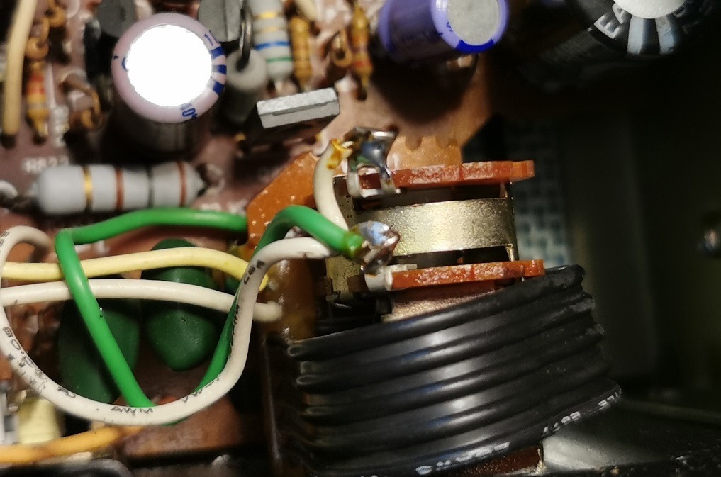

replaced the volume control of a Nad 3140 stripped the old one down and cleaned it up to keep as a spare and gave it a good clean!!

Opening controls wherever possible is the very best way to restore them. It allows you to clean the track gently with a cotton bud and iso and also clean and if needed re-tension the wiper. If the wiper can be moved a fraction so that it contacts fresh unworn track then that is even better.
That looks like a pot with a fourth pin? used for the loudness circuit. Those are pretty much unobtainable I think.

Thats why i always keep all parts, strip them down and clean them. I have quite a few spares for various units, lots of pots and switches
Not only are the parts scarce, or more non existent, it keeps the originality when doing a repair
Its one, but not the only reason i repair the Nads, there were so many amps and recievers that had interchangeble parts
for example i brought 3 realy trashed old 4020a tuners, realy cheap,i think £20 for all 3.
Nobody realy wants these any more, they all want DAB, but if your smart, like me 😉 you will notice all the switches, knobs and more importantly the button heads for the switches, are identical to the 3020 series 20, A var and B var amps, and people want £10 each on ebay for those button heads
These always come loose and pop off, and often get lost.
so for £20 i got 5 switches and 5 button heads 😉, clean them all up, and almost good as new, ready to replace a defective one.
One could establish a business of replacement volume controls for the Pioneer receivers of my youth...excepting that most have gone to the boneyard. And as observed, the 4 legged variety are nowhere to be found -- but can be replaced with some ingenuity and an Arduino.
