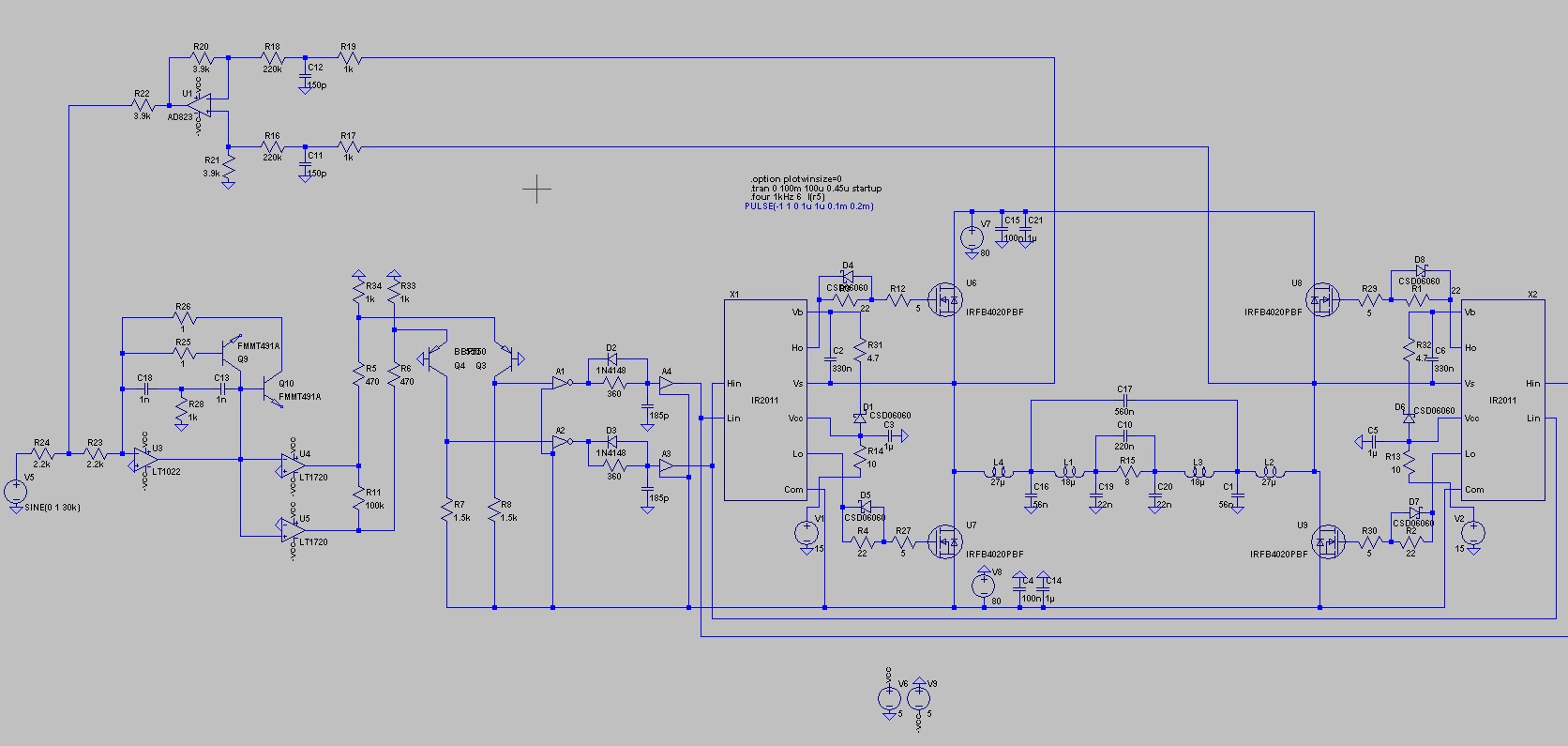

here I did a full bridge, with a single ended input, a trhee level is also option, but then we need pulses on the zero transistions otherwise we get crossover distortions, we can clock these pulses and inject them there, did see something about the a while ago, do not now where.
The full bridge does supress the even harmonics but I see more uneven harmonics with it, of this sounds bad I do not now, mine ciclotron has also this problem, it is due of balanced technology.

Here is the schematic for ltspice, just play with it and let now.

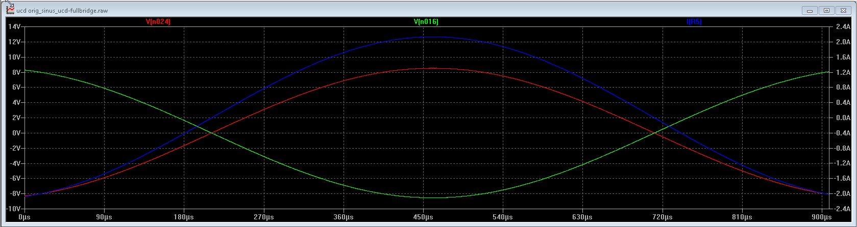

I have done some sims, but the UCD version and the delta sigma are the best, delta sigma is even without postfeedback low in distortion.
Here some results, also with squares, maybe time to duild one to see and discover the sound, I am curious about this technology.

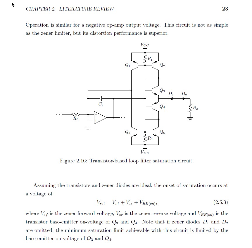

This one is on UCD principe like phillips did, with a extra intergator op.
Some I do not understand yet is how to setup the integrator, bandwidth etc, what frequency it is tuned at, I need to now that because
this I did not read in the papers, it seems to have a lot possibilities, the 90 degree shift do it keep it that way until bandwidth audio who is setup
in low pass, or has it something to do with the carrier, need the intergrator set up on carrier frequency as I did see in some, the fase shift versions
has a integrator working in the feedback filter, and ucd in the opamp itselfs and feedback.

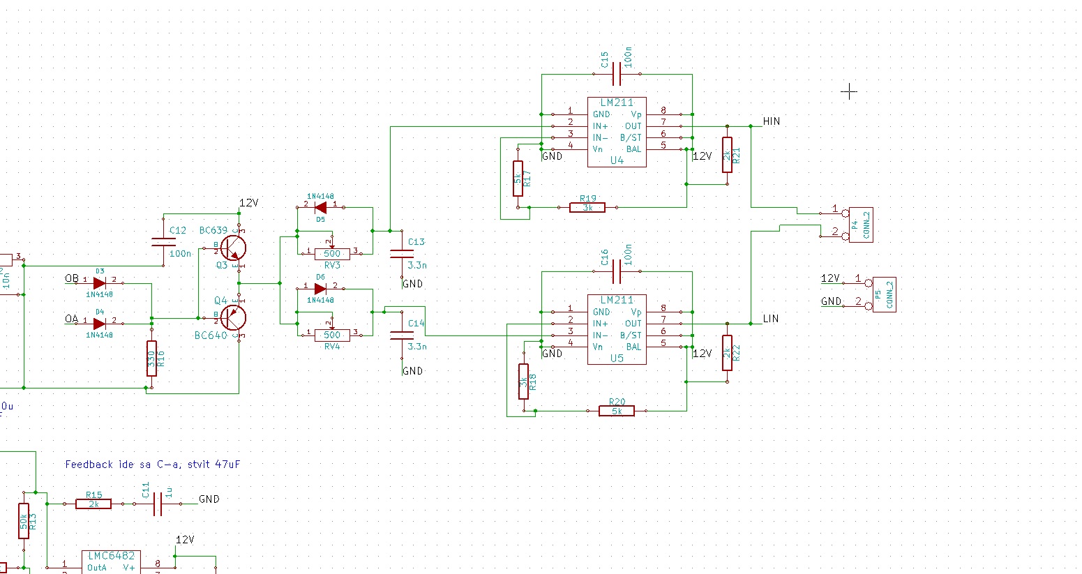

You claim you need real circuit to vary dead time to see how feedback affects THD.
In reality you can change dead time using the same diode resistor(trimmer) capacitor network + comparator. You vary every rising edge...
Here is one of may schematics using for some buck power supply. This way made for real and works.
HIN and LIN are input to classic low side and high side mosfet driver without internal deadtime, IRF manufactured like IRS2186

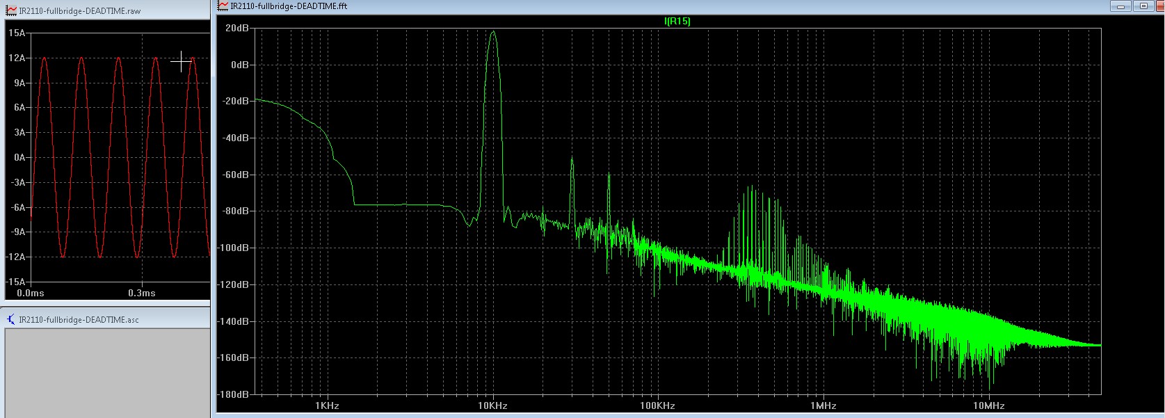

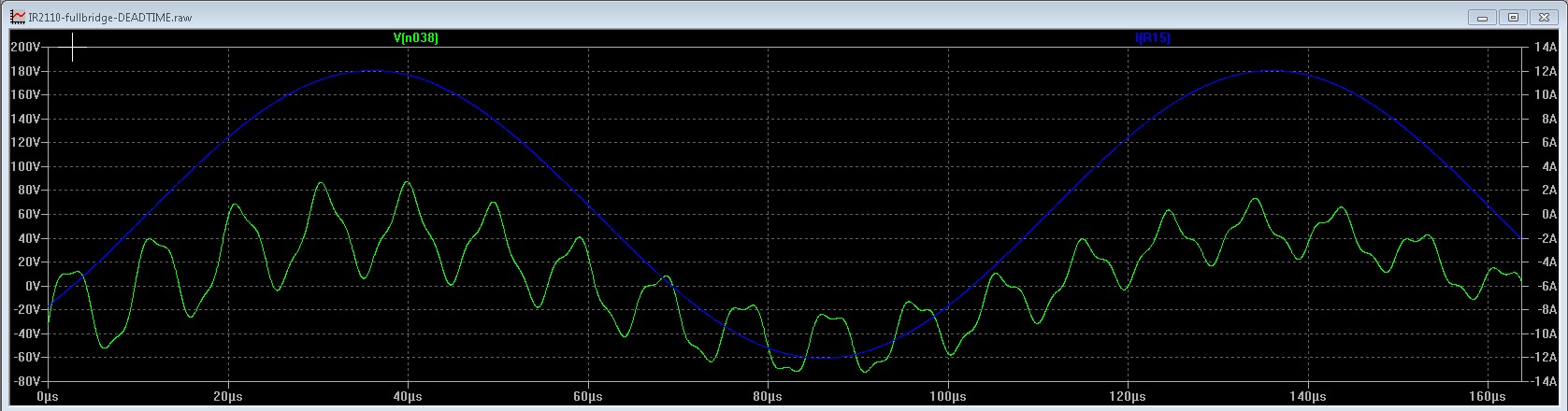

I have drawn one with the ir2010 models and the dead time generator from your sim schematic, I see it does give low distortions, and it is full bridge however when I adjust deadtimes it is difficult, to much and I get shoot through but also when to little.
I think because supply is differential plus and minus 80 volts deadtime setup is difficult, it always crossing wrong? Maybe because of this people do use one supply voltage and a ref level.
Last picture you see what happens, get it not right, not to do with sync such full bridge amp?
regards

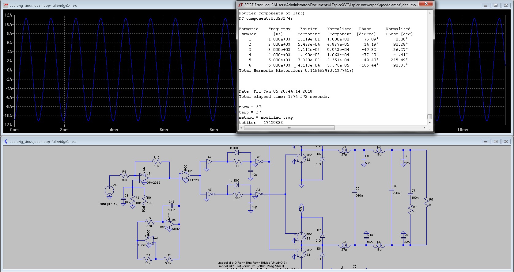

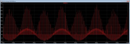

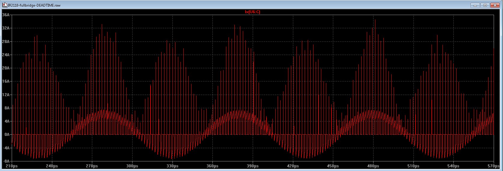

Look at these, picture two is the above menstion one and one is with your ideal switches, there is a loop error in the ir2010 one, I think only build will give answer on the very strange output voltage whie the current looks perfect and low HD.
Good models is what you need when sim a class d or a smps.

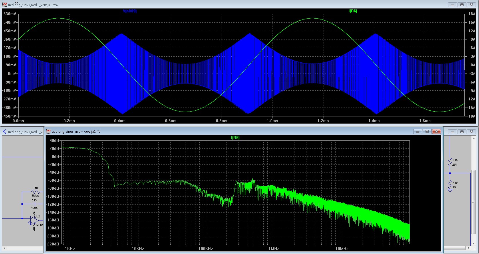

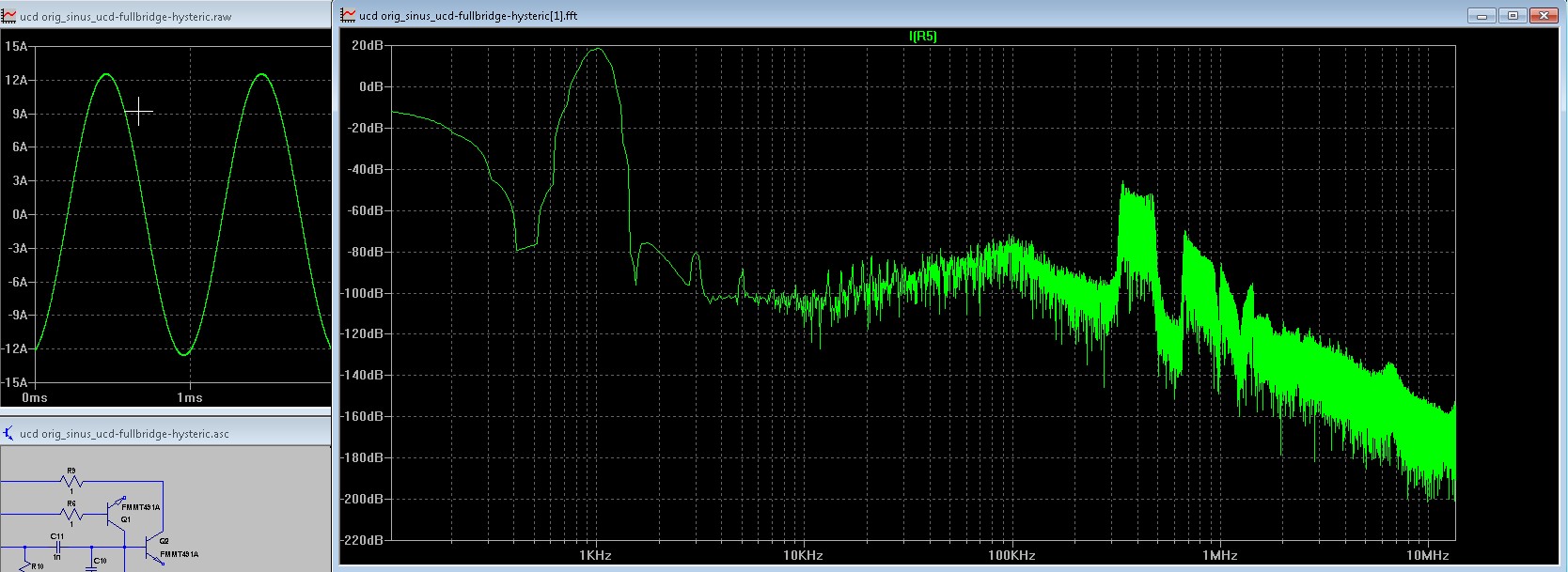

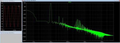

Build myself is much more fun, and this amp has not such low dustortions, 0.05 % for 1 watt, 10 % for full power.
The delta sigma ucd did much better, for sim that is.
First picture hysteric delta sigma and the other is een openloop with triangle osc full bridge. All sim so not build, but go do that soon.
