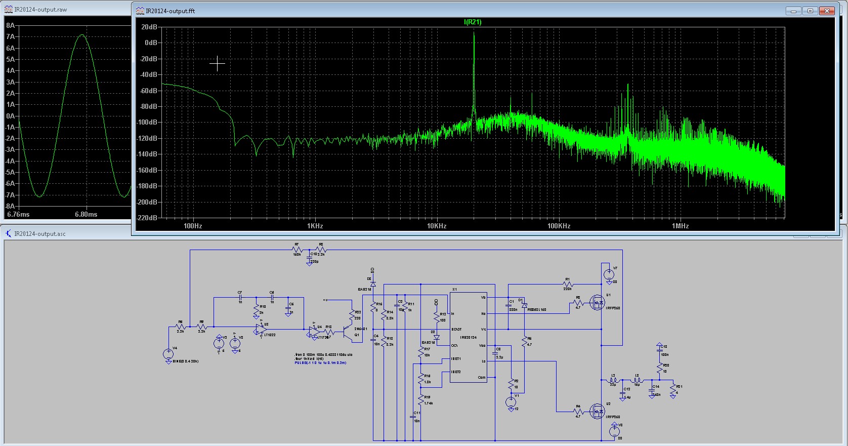

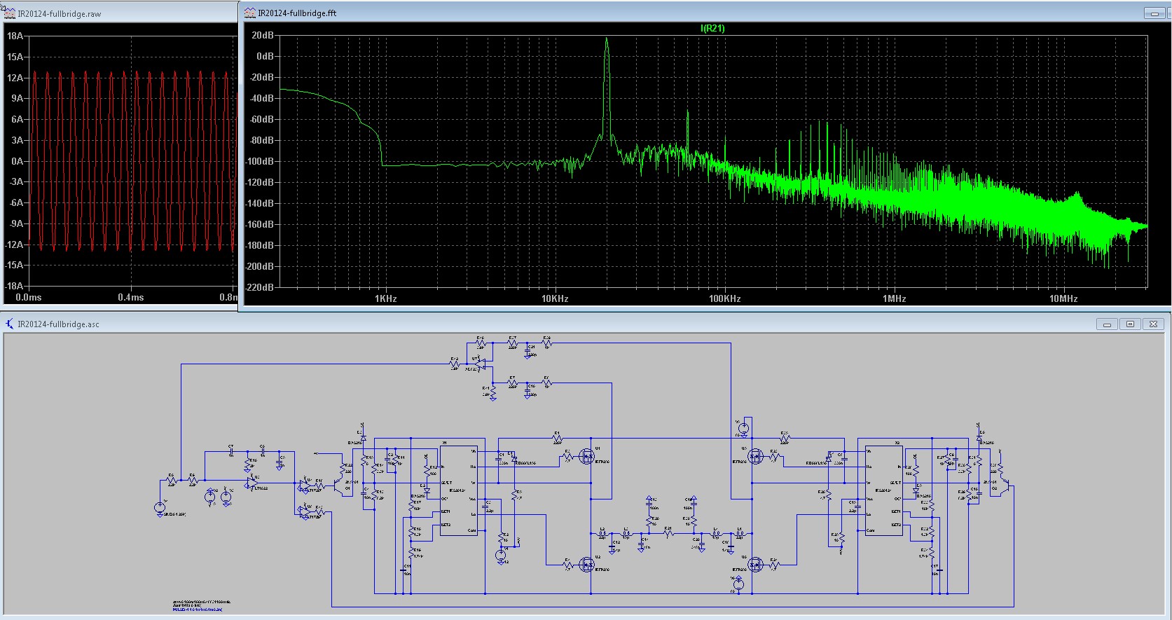

I did find a nice model for the IRS20124, sims oke, and quite fast.
in fullbridge but has some trouble with offset.

Maybe that single input type of MOSFET driver might tend to produce a bit of DC offset. I like that type though and would like to try it, but use just through hole parts as much as possible.

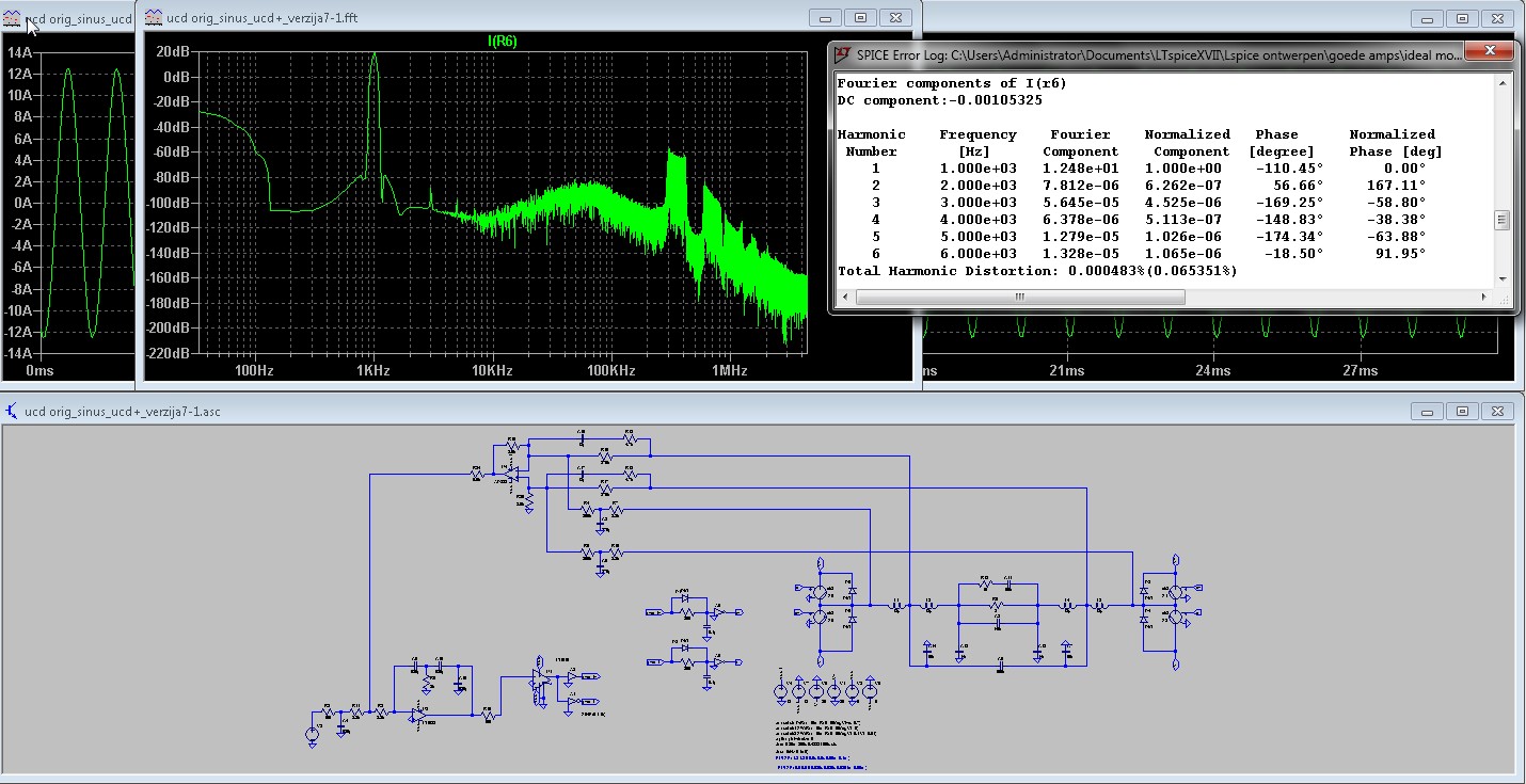

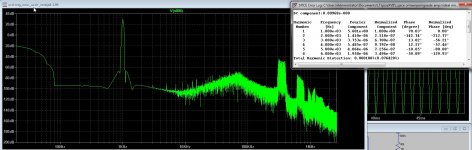

The offset is not a big problem, can be adjusted easely, as for grizlek, include a speaker terminal in the feedback of a AB amp is quite different from a class D amp, there is already a feedbackloop with analog delta sigma and UCD, I have now as requested include the coil into the loop, however, best did include the coil and before for switching loss correction, low pas filters tend to be quite nasty with square waves, I have here a test, with very low distortions, however when overdrive it it get unstable, this one needs a limiter, I did see one who seems work very good, not yet tested.
just let now what you see, for me it is just learning how these can be made, class d like easy but are not, square testing is somehwat different with ab amps.
Last picture was with two feedback opamps, did not make it better, so did now one opamp and network, and more power with lower distortion, do now, the switches are lossles, and there is deadtime and no overshoot.
regards

For clearance, I do NOT like feedback, so I do test also open loop versions and with prefeedback who tend,s not to get mess with sound, however this is class d so I can test all, and listen later, maybe a current feedbacked class D, because this feedback I do like much more because it is independent of bandwith, and have much less TIM distortions, these are very nasty sounding amps.

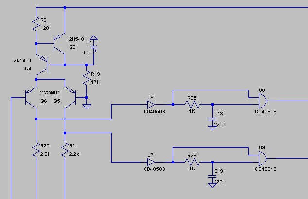

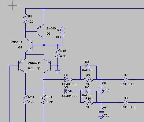

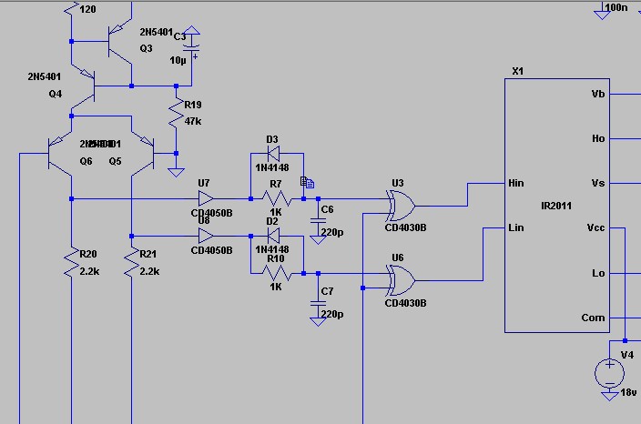

Some questions, what dead time generator for the IR2110 is best, there are different approaching's to do that.
here some I did find about it.
regards

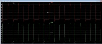

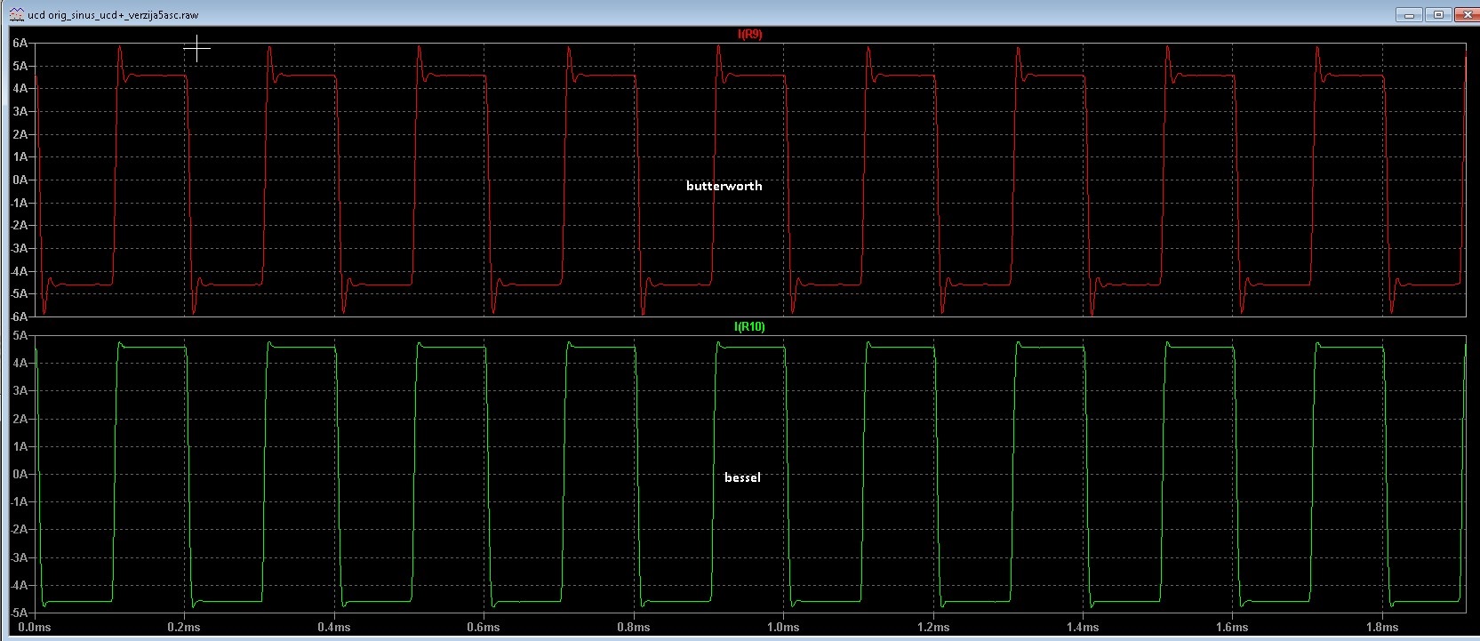

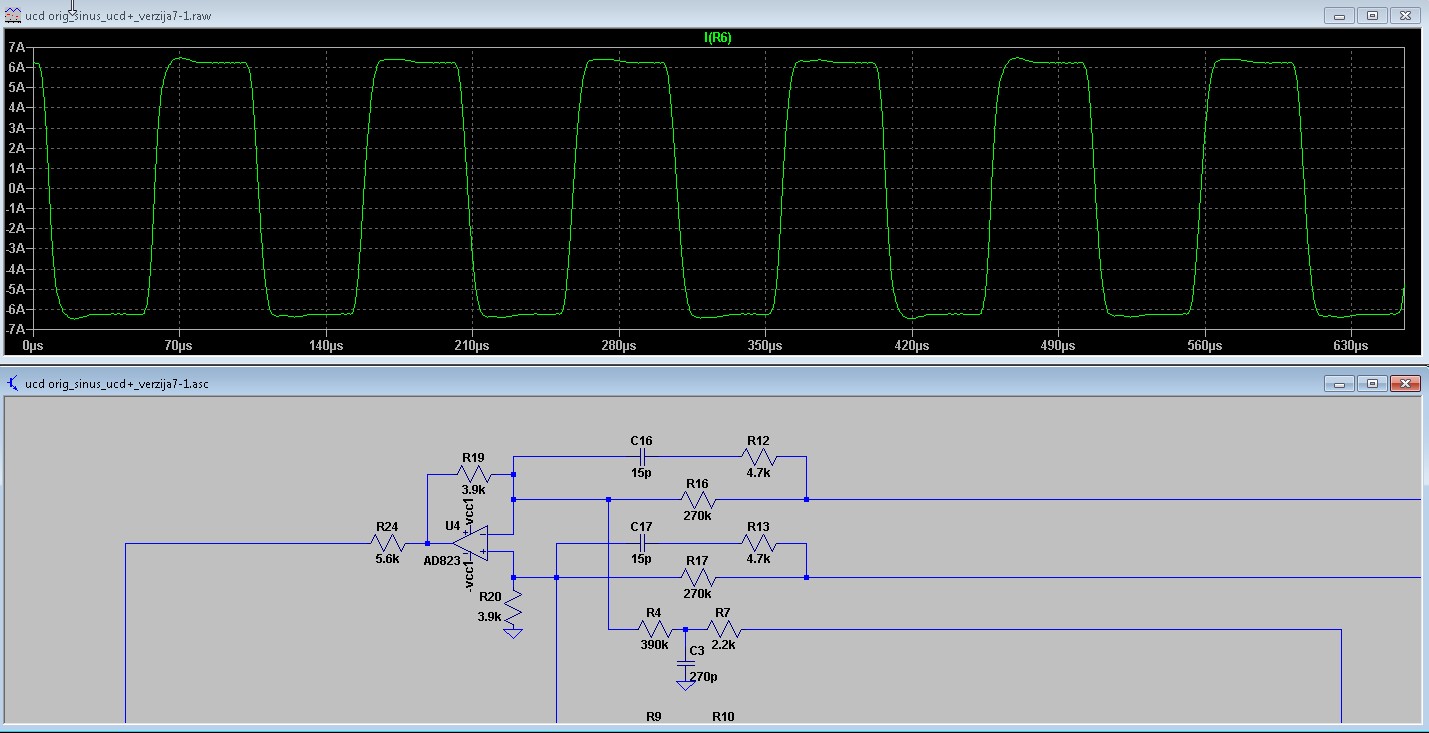

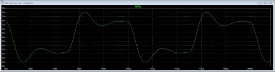

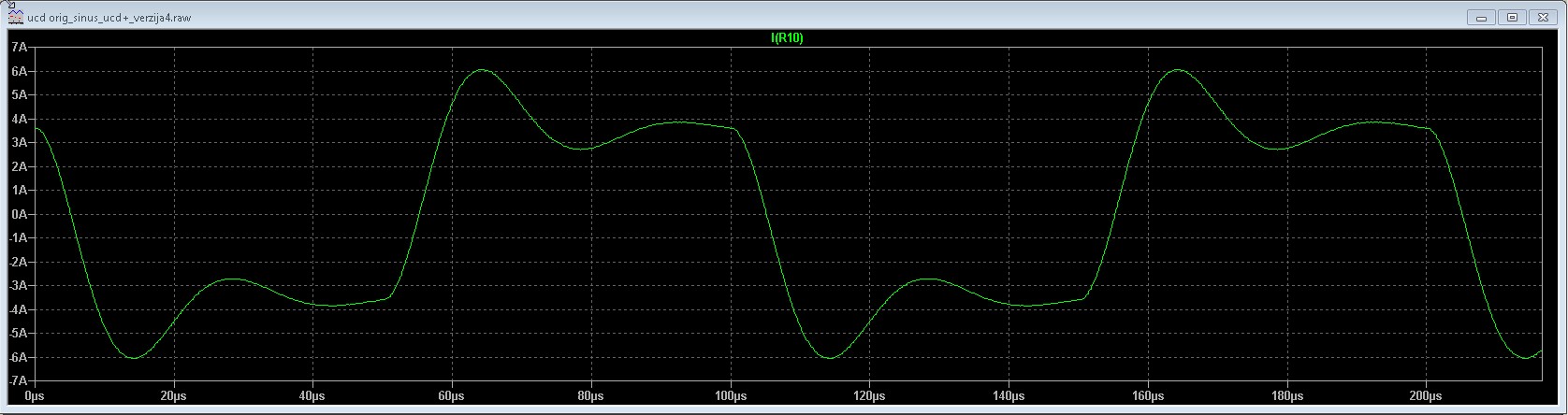

I have use two kind ow lowpass networks, both are 24db octave.
nice to see overshoot/ringing, the bessel network has the most nice waveform with little overshoot, and supress the carrier wel, however it is constand fase it has not constant amplitude.
-3dB om 100Khz.
regards
-3dB om 100Khz.
regards

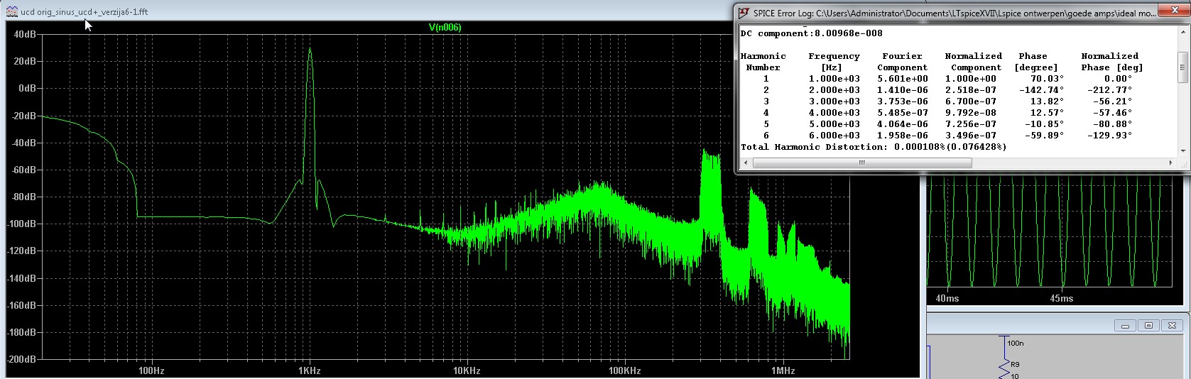

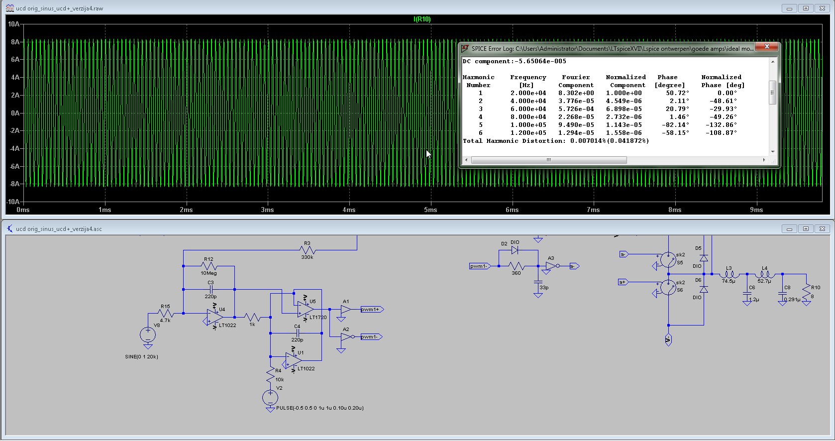

A other tryout I have done with a second order fixed carrier modulator by insert a second integrator into the design with is clocked to make a triangle.
It give a very nice low distortion, and maybe it get even better.
is is done with 65 volts top top.
regards

This is a lowpass effect, coils do not like squares, she act as a buck converter with squares, and give overshoots, can be made less but stays a problem, high switching and 100 Khz bandwidth do work, but need very fast switching, can be done with totem pole 5 amp drivers? little overkill but is fast. Or I use 24 dB octave filters, the second coil is not of influence much.
Do you now what kind of symbol this is? I can not find it and do not now, I now the rest. see last picture.
regards

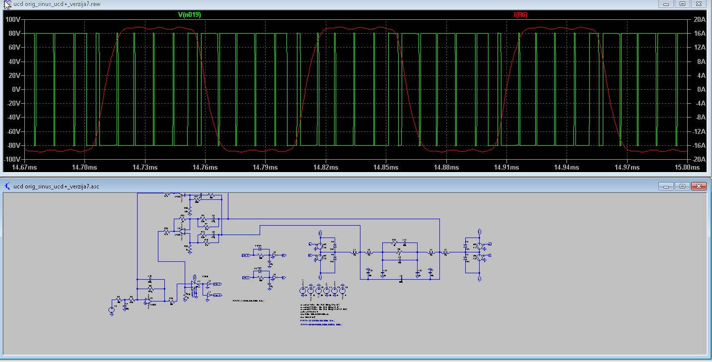

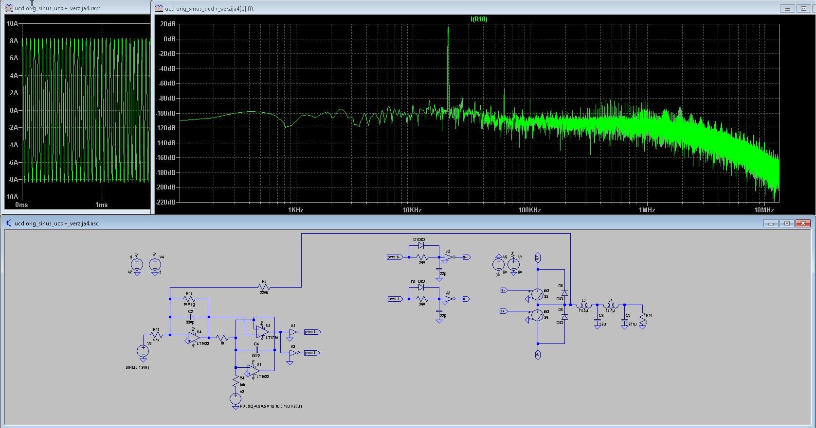

Here I have simulate a class D I get with perfect switches quite good hd figures. but in real time, I have to build it, the all digital class d has no real future I think, she will keep it analog self oscillating. I go see if I get a very fast and good switching output stage, maybe even with extra totem poles after the chip.
Last picture has a extra integrator who is driven by a clock making a triangle who is feed into the comparator, it is in the feedback loop and get quite nice results, clock jitter maybe a problem, and it is a constant carrier type now, no drop, without the clock it self oscillate and have drop, but very high frequency >1Mhz.
regards
